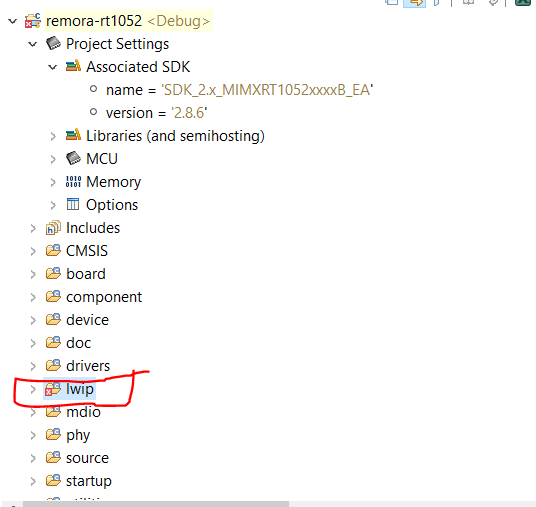

10 Mar 2023 13:30 - 10 Mar 2023 13:34 #266287 by zmrdko
Hello,
first of all, nice work @scotta.
Im trying to flash ec500 (IMXR_EC500 2022-09-07), but I am unable to compile the files.
The direct flash for the first time does not work as I read in this thread.
I have probe visible in MCU Expresso but I have issue with lwip folder and I get about 40errors:
Description    Resource    Path    Location    Type
'ERR_OK' undeclared (first use in this function)    NO_SYS_SampleCode.c    /remora-rt1052/lwip/doc    line 40    C/C++ Problem
'ERR_OK' undeclared (first use in this function)    NO_SYS_SampleCode.c    /remora-rt1052/lwip/doc    line 62    C/C++ Problem
'ERR_OK' undeclared (first use in this function)    NO_SYS_SampleCode.c    /remora-rt1052/lwip/doc    line 111    C/C++ Problem
'eth_data_count' undeclared (first use in this function)    NO_SYS_SampleCode.c    /remora-rt1052/lwip/doc    line 7    C/C++ Problem
'eth_data' undeclared (first use in this function)    NO_SYS_SampleCode.c    /remora-rt1052/lwip/doc    line 11    C/C++ Problem
'ETH_HWADDR_LEN' undeclared (first use in this function)    NO_SYS_SampleCode.c    /remora-rt1052/lwip/doc    line 59    C/C++ Problem
'etharp_output' undeclared (first use in this function)    NO_SYS_SampleCode.c    /remora-rt1052/lwip/doc    line 53    C/C++ Problem
'ETHERNET_MTU' undeclared (first use in this function)    NO_SYS_SampleCode.c    /remora-rt1052/lwip/doc    line 55    C/C++ Problem
'ethip6_output' undeclared (first use in this function); did you mean 'netif_output'?    NO_SYS_SampleCode.c    /remora-rt1052/lwip/doc    line 54    C/C++ Problem
'ifinnucastpkts' undeclared (first use in this function)    NO_SYS_SampleCode.c    /remora-rt1052/lwip/doc    line 108    C/C++ Problem
'ifinoctets' undeclared (first use in this function)    NO_SYS_SampleCode.c    /remora-rt1052/lwip/doc    line 103    C/C++ Problem
'ifinucastpkts' undeclared (first use in this function)    NO_SYS_SampleCode.c    /remora-rt1052/lwip/doc    line 106    C/C++ Problem

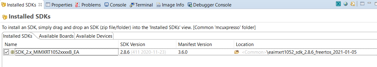

I have installed SDK_2.x_MIMXRT1052xxxxB_EA. version 2.8.6.
MCU is set to chip: MIMXRT1052xxxxB
Am I missing any library or something?
Last edit: 10 Mar 2023 13:34 by zmrdko.
