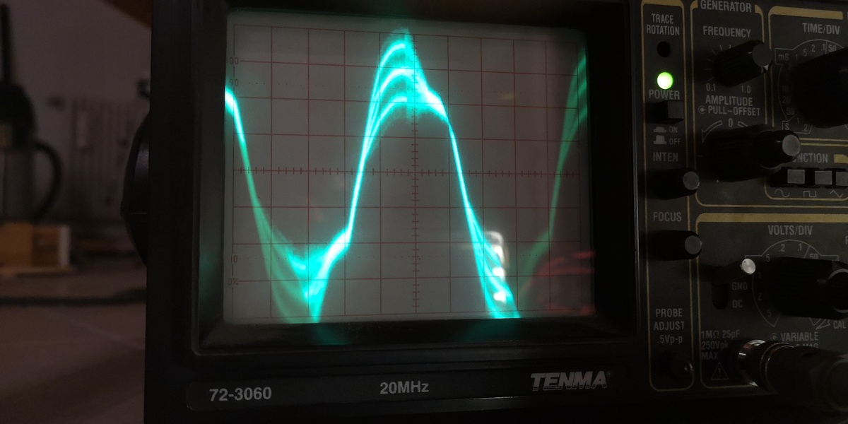

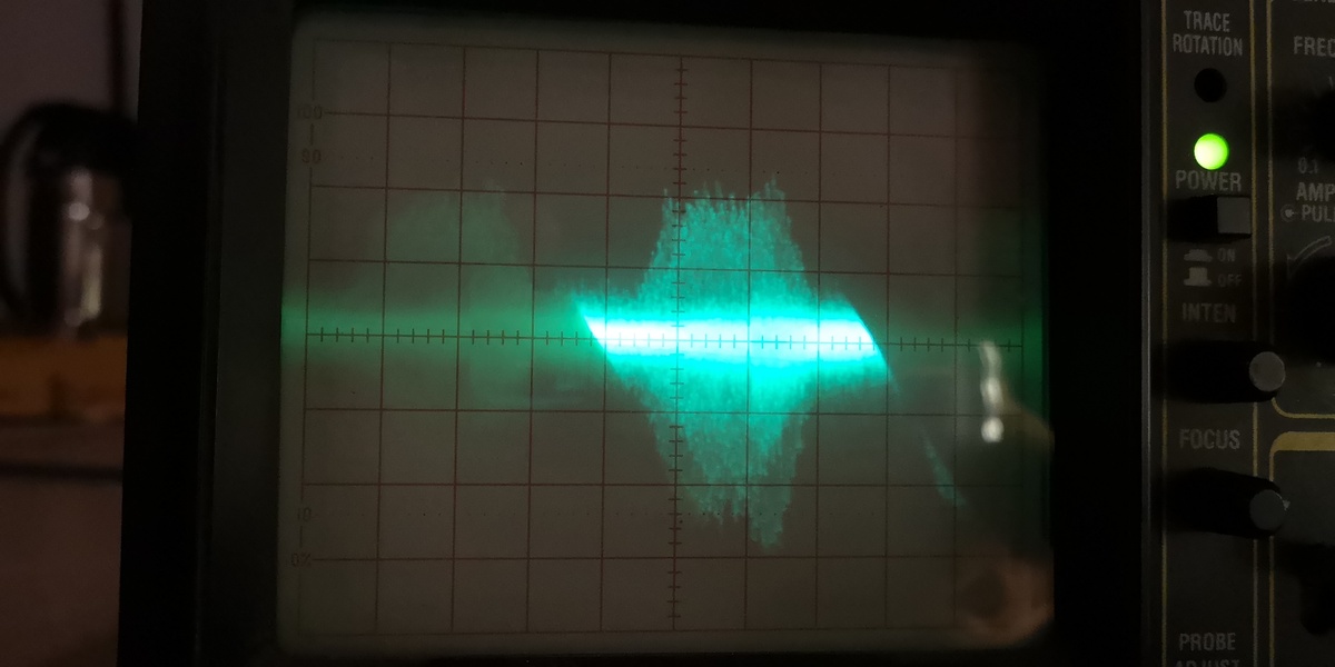

- dec0077
- Posts: 18
21 Feb 2023 21:17 #264984
by dec0077
Replied by dec0077 on topic Remora - ethernet NVEM / EC300 / EC500 cnc board
I finally got my oscilloscope today and put it to work right away.
This first image is what I get out of the optocoupler; Voltage goes from -10V to +8V and the wave is all but square... the less said about the duty cycle, the better.
This second one is the output on VSO (sorry for the quality, it was difficult to take a picture while holding the probe to one of the pins); again goes both positive and negative, is about 250mV p-p and does not approximate a ramp in any way, shape or form.
Given these waveforms, I think I'll not be able to drive the spindle directly, it's almost as if the PWM section of my board is faulty.
What do you think?
