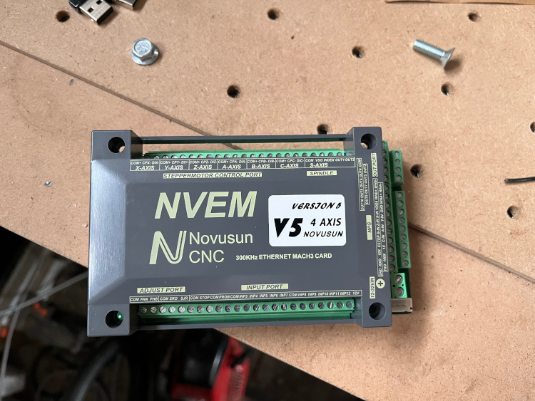

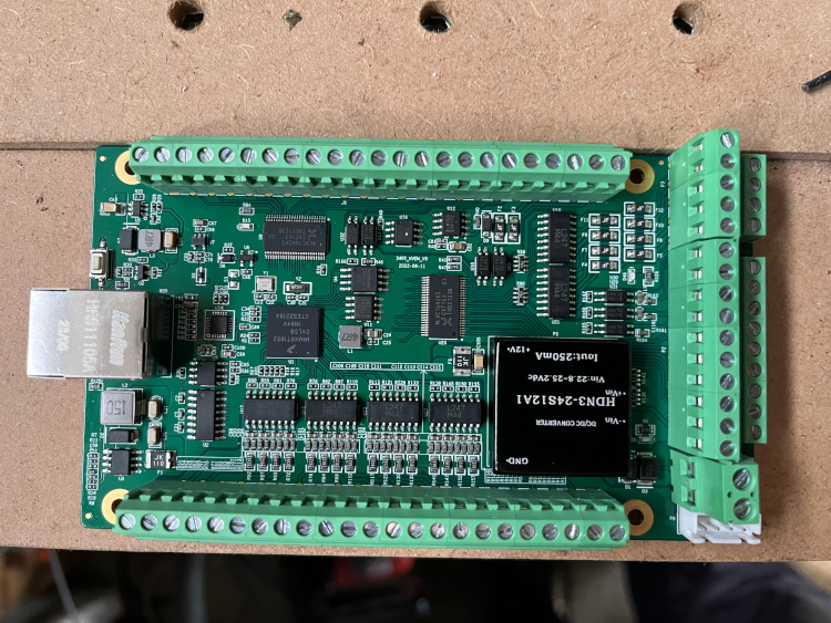

On the picture you reposted there is no indication which remora.input is which. That's why I've used the one I've attached. Over there it's clear that for example estop input is remora.input.04, probe is input.05 etc. So the INP3 (on your picture) is really input.06.
It is correct as I've check it.
- cakeslob
- Posts: 927
- Thank you received: 280
The problem is that it is the wrong board, using those pins in the config will cause problems for other users who use them. If all you need is a reference to which remora pin goes where, you can use the config file you loaded to the board. The part you need may be correct, but the pin assignment is not for the same board. If you use the STM32 pin names on your rt1052 board it will cause issues.
github.com/scottalford75/Remora-RT1052-c...xCNC/nvem-rt1052.txt
Ill even do you one better, here is a trimmed down list of the inputs/outputs that you can use that wont cause problems for other users.
