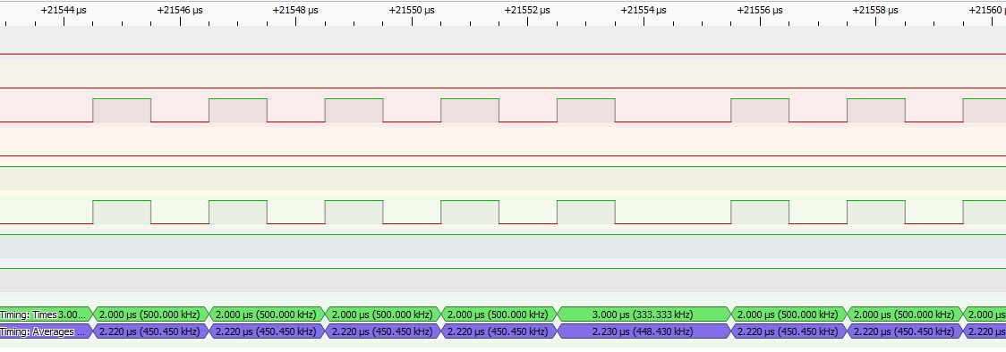

Some progress to share and getting closer. Below is a snip of a DDS synthsised 450 kHz step train on two pins on different ports generated by the DMAstepgen module and pushed to the two GPIO ports at 1Mhz via DMA using 1 single timer
Still to do is double buffer and connect the stepgens to LinuxCNC command and feedback.
