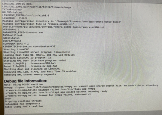

  Hi all together,i was able to get hold of an EC500 card.I flashed the card , set up linux on a pi4 according to scott’s yt video, now to my issueIam able to ping the board and upload the config no problem ,but starting linuxcnc gives me the following result.anyone can help out and point me to where the issue could be.thanks
Looks like you didn`t compile the nvmpg.c in Folder NVMPG und Linuxcnc/components
24 Aug 2022 11:03 #250314 by Snap1202
Thanks you where right was the nvmpg.c i needed to compile a second time.
Now it looks like it works.

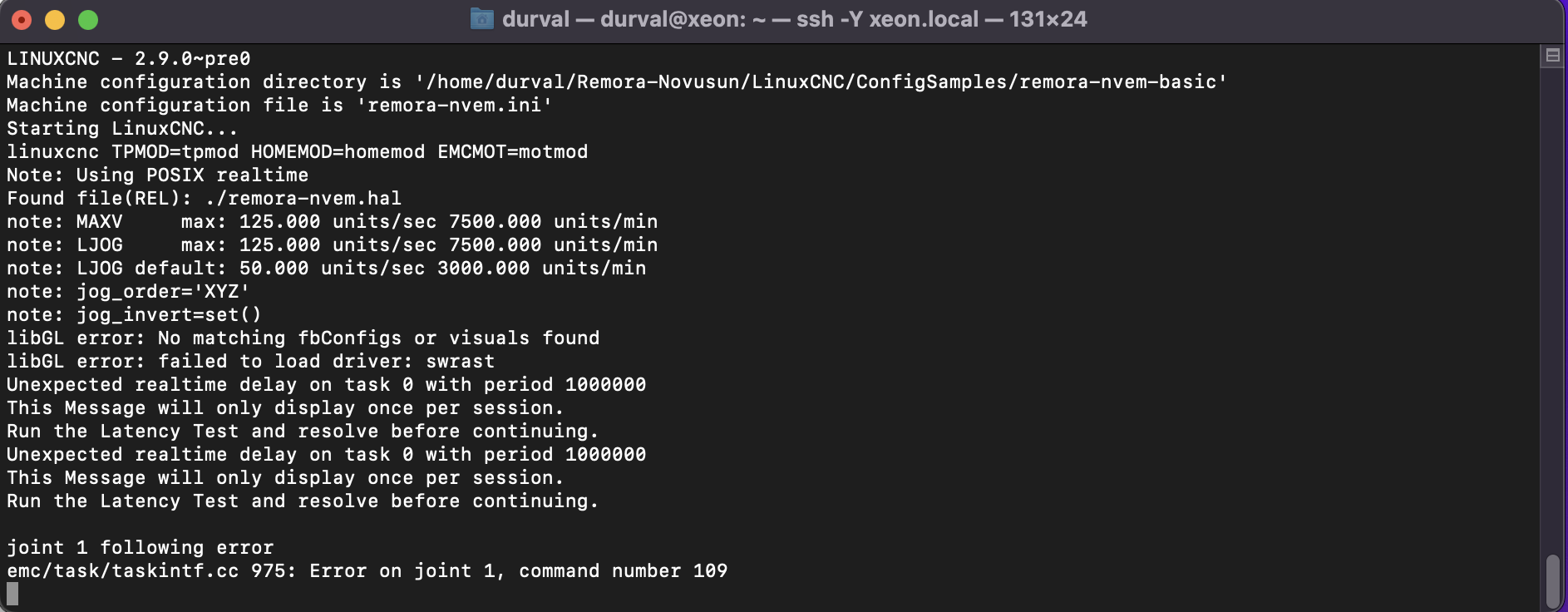

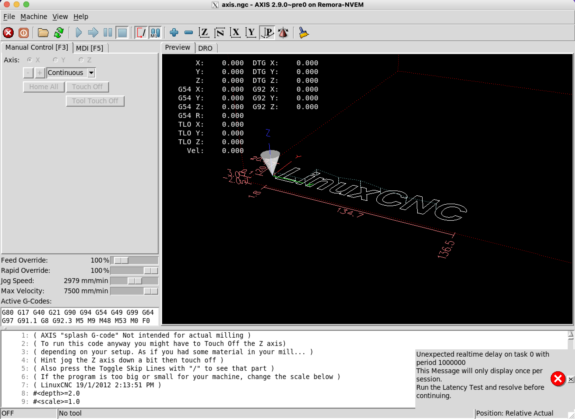

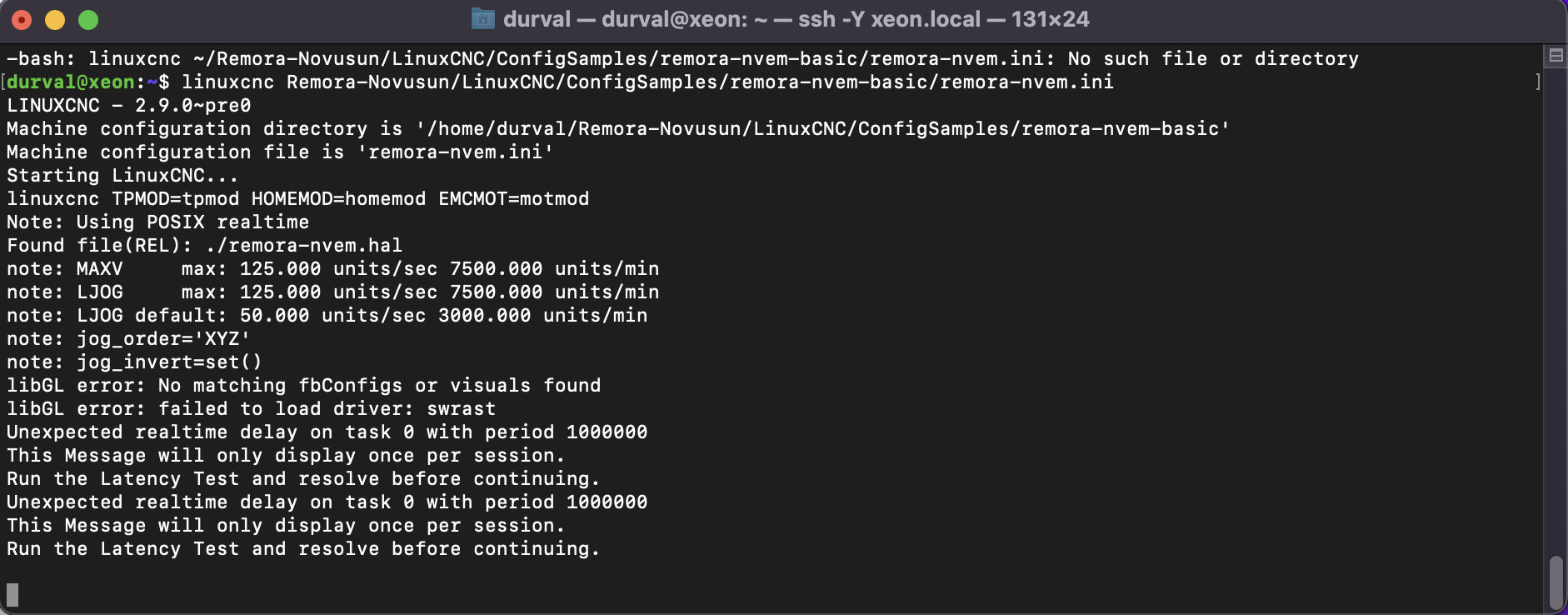

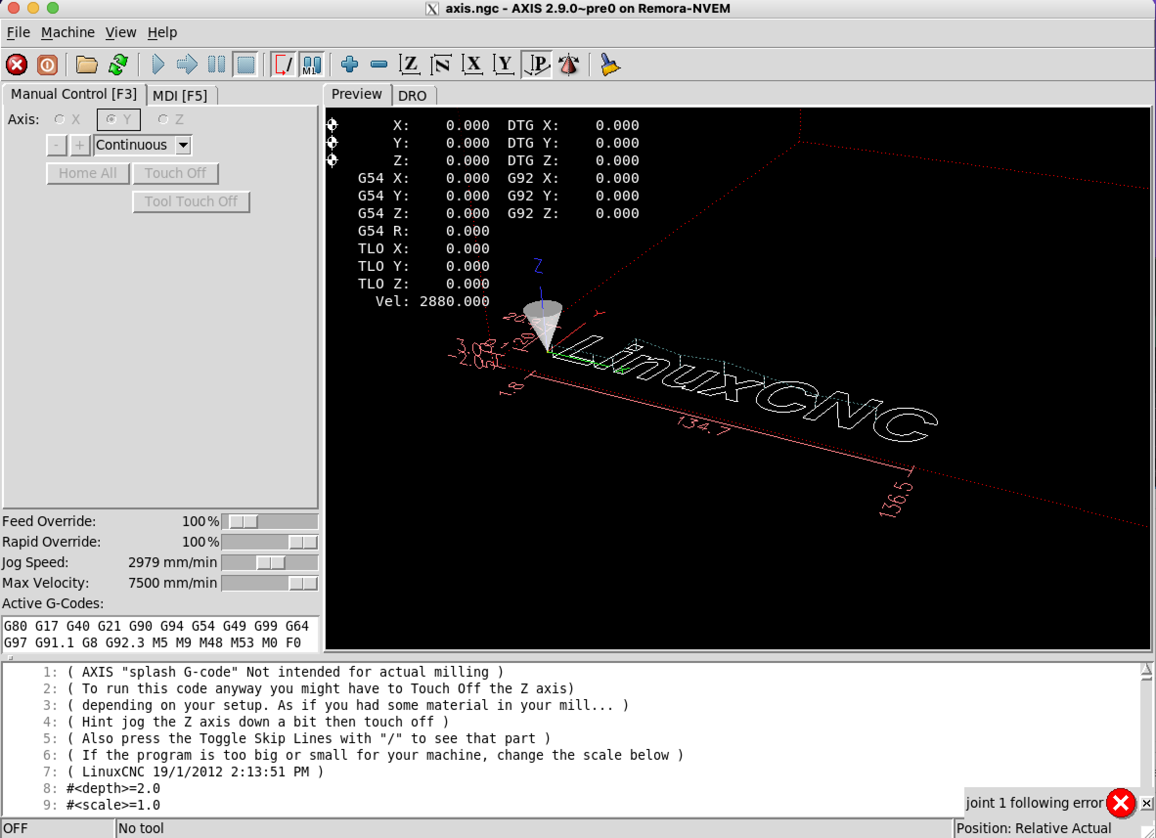

Cloned github.com/scottalford75/Remora-Novusun/tree/feature/DMAstepgen with.
git clone github.com/scottalford75/Remora-Novusun.git --branch feature/DMAstepper
ping 10.10.10.10 and is ok.
Uploaded Remora-NVEM.bin to my novusum-nvem ..
sudo halcompile --install remora-nv.c
sudo halcompile --install nvmpg.c
linuxcnc Remora-Novusun/LinuxCNC/ConfigSamples/remora-nvem-basic/remora-nvem.ini
and the result is:
Unexpected realtime delay on task 0 with period 1000000
This Message will only display once per session.
Run the Latency Test and resolve before continuing.
joint 1 following error
emc/task/taskintf.cc 975: Error on joint 1, command number 109
joint 2 following erroremc/task/taskintf.cc 975:
Error on joint 2, command number 169

24 Aug 2022 22:47 #250357 by PCW
What are your ping times?
The following errors are possibly the result of the real time
errors so you may need to either increase the servo thread period
or improve the Ethernet latency of your host computer.

Please do not attempt to use the feature branch, it's not working yet
"git clone  github.com/scottalford75/Remora-Novusun.git  --branch feature/DMAstepper"
That said the NVEM bin should be the same as in the main branch. I always get the initial realtime delay warning on first start but not after that.

Thinking on this a little more, I've seen a similar behaviour when the config file is corrupted and does not get passed correctly. Resulting in no step generators being loaded. Please try a full chip erase and re-flash so that the default 3 axis config is used or alternatively re-upload a config file to the board. Having a serial monitor attached would help to see what is going on, but this would be my first approach.

I've just downloaded the firmware in the main branch and  done a upload again to my novusum-NVEM without recompiling the driver remora-nv and everything is working..  :-)
