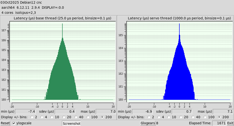

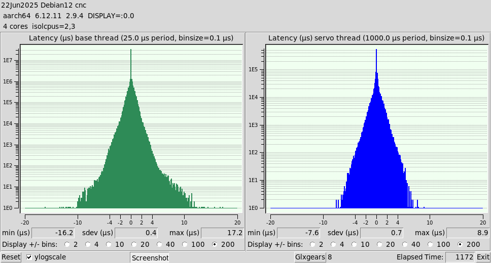

With the RPI4 being a viable contender albeit marginal for linuxcnc I thought I'd share some results i got from a stock RPI5 with a SD and with the addition of a nvme hat. I think they have knocked it out of the park with this one.The first one is with a nvme ssd hat added and the second one is with the standard SD card.
