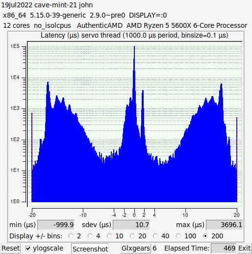

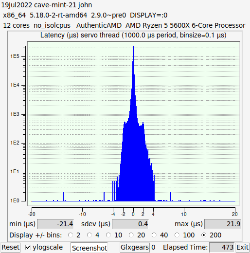

And I had to move on to Linuxmint 21 to get a Python version high enough for master which for some strange reason requires Python => 3.10
- JT
- Posts: 1103
- Thank you received: 593
19 Jul 2022 19:27 #247787
by JT
Replied by JT on topic Current Motherboards
- Posts: 22002
- Thank you received: 7488
19 Jul 2022 20:45 #247788
Replied by tommylight on topic Current Motherboards
Nice!
