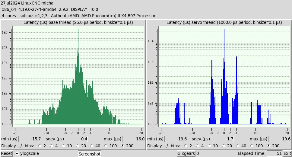

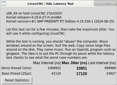

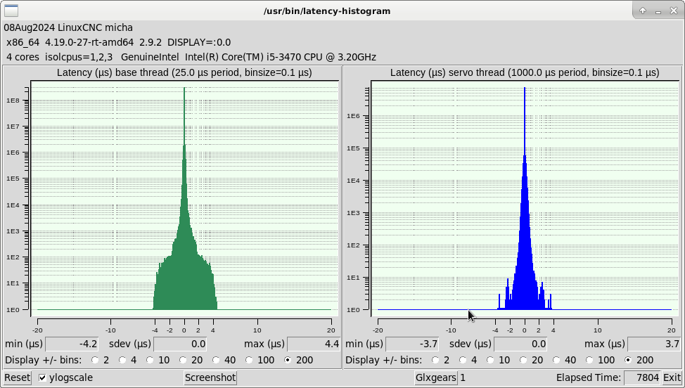

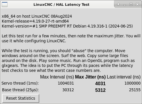

09 Aug 2024 12:04 #307351
by mBender
Replied by mBender on topic Dell Optiplex 3010 can't get PCI Parallel Port Card working
I was irritated by that message too. But I am not sure where that message comes from. Attached are the comparison between the old (AMD high latency, but working fine) and the new PC (intel low latency but nothing than problems). This was all taken under high load.
All the settings you mentioned in the bios are already disabled. Sensors I have not watched.
