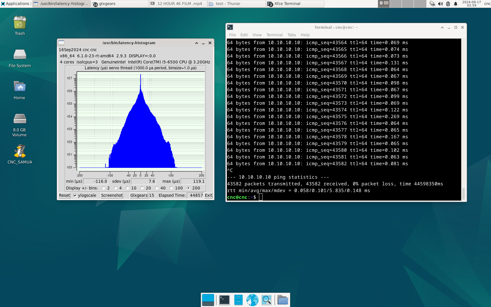

I need help because I don't know what to do with my PC.
At the moment linuxcnc displays ‘hm2 error finishing read’ every time I change the tool on my turret on my cnc lathe.
several weeks ago I had this message sometime.
below the latency of my pc and the ping for the ethernet.
I have disabled all the options that slow down latency in the bios/uefi.
I have followed the procedure to isolate a core for linuxcnc. and other procedure to reduce latency (IRQ affinity scripts / rt_setup).
but i have the problem ‘hm2 error finishing read’, is there any solution to remove this problem or the only solution is to replace the pc because nothing can be done?

The issue is the 5.835 ms maximum ping time (about 10X the usable maximum)
My guess is that you have a RealTek Ethernet interface on you PC which requires
and alternate driver (DKMS) be installed since the driver supplied with the 6.1 kernel has
real-time issues.

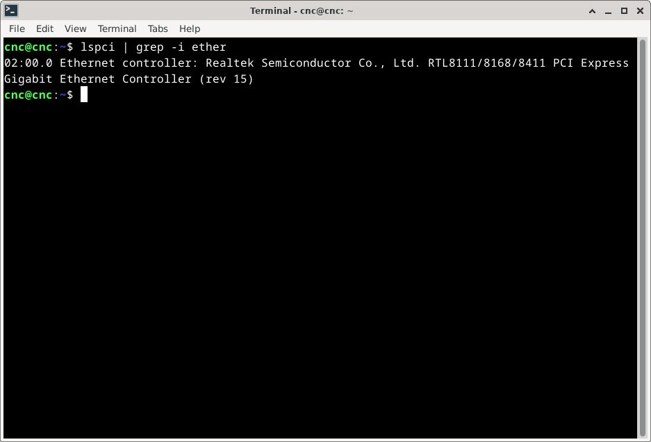

Before you do that is probably best to determine the actual Ethernet hardware with say:
lspci | grep -i ether
real-time issues.
Instructions for this are in this thread:
forum.linuxcnc.org/27-driver-boards/5366...xcnc?start=20#310794

29 Oct 2024 10:44 #313423
by greg23_78
Replied by greg23_78 on topic Solution fo "hm2 error finishing read" with no good PC

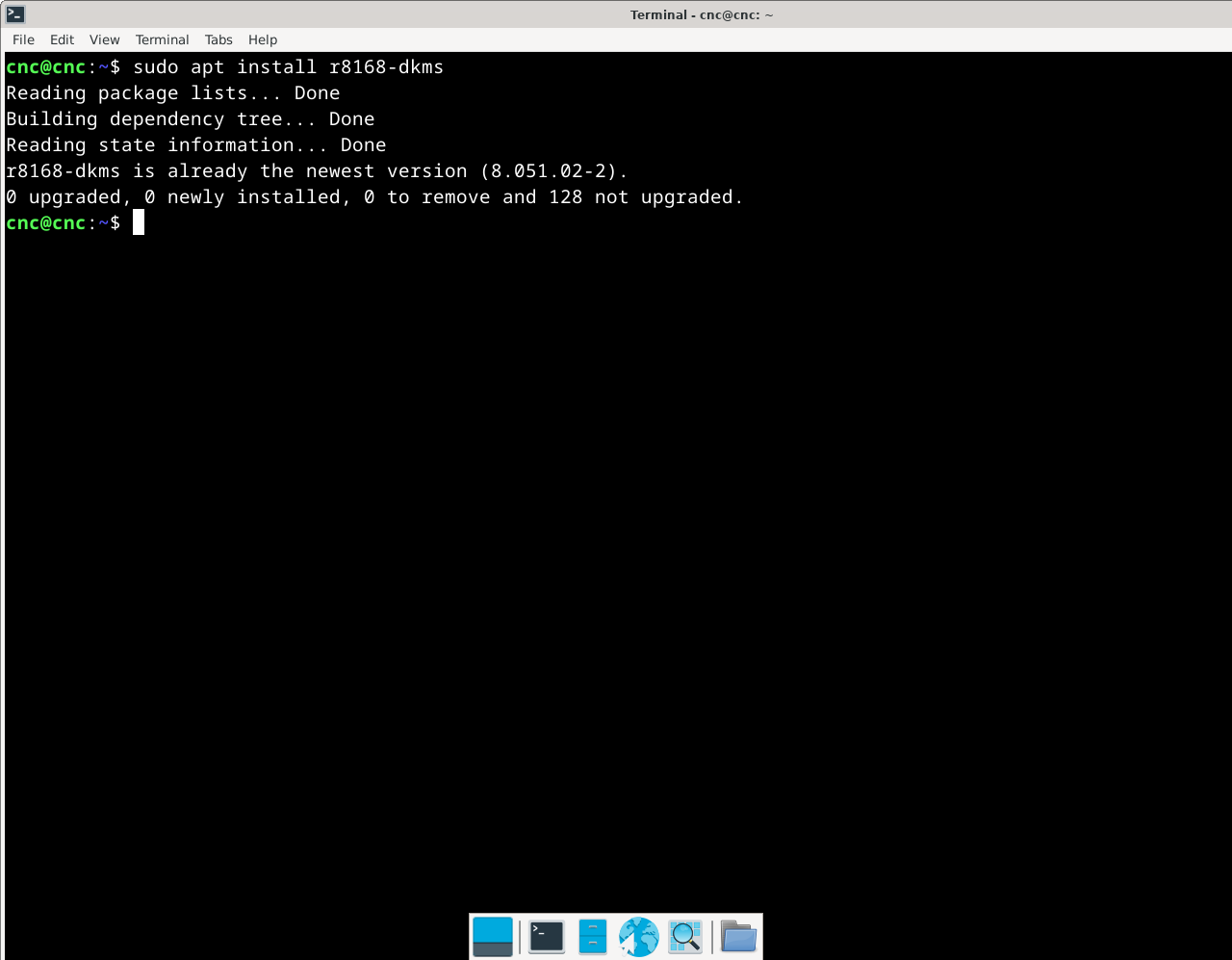

i did, but still the same.
i have done ping 10.10.10.10 during the nigh and i have lost some packet.
my hardware is Realtek RTL8111/RTL8168

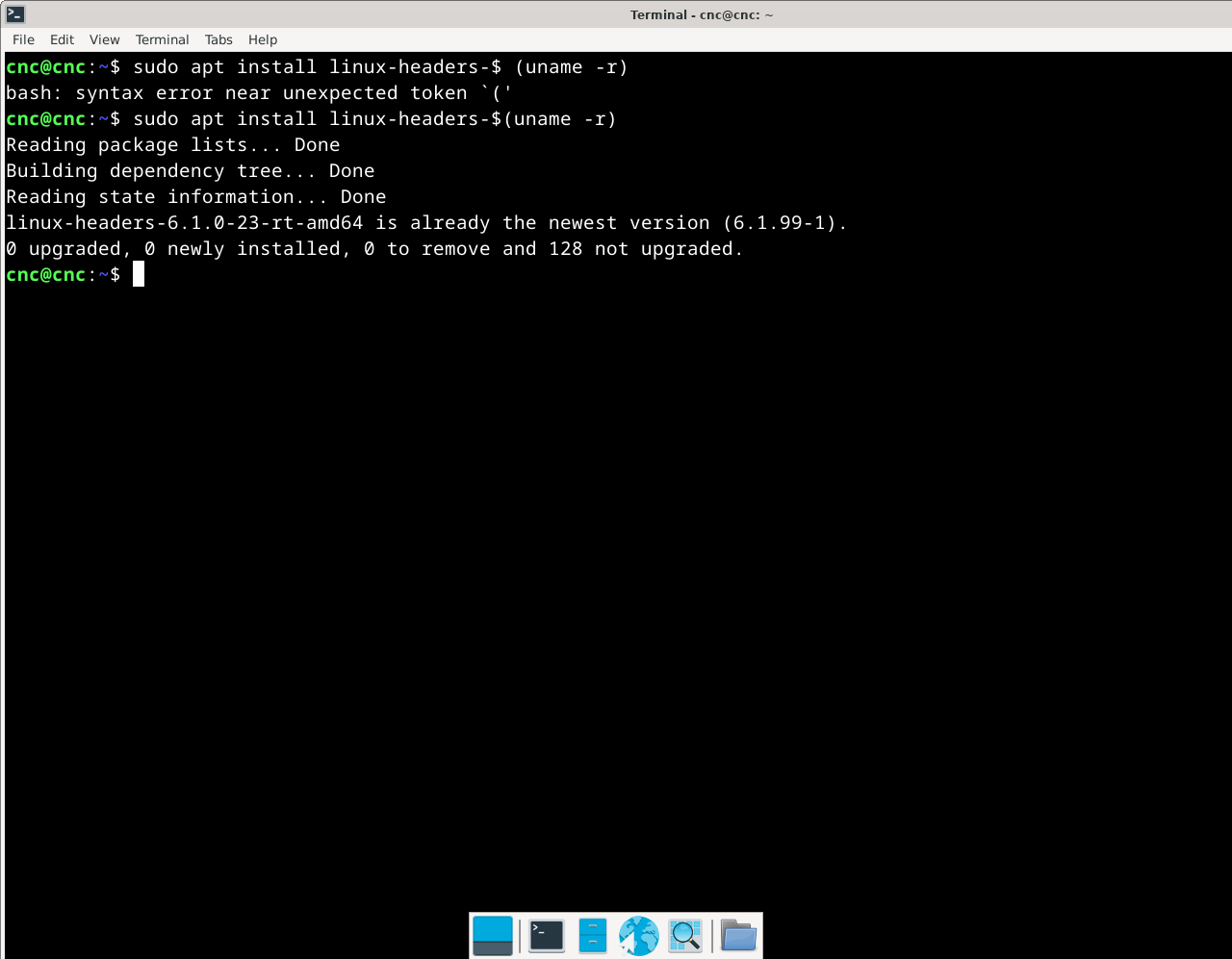

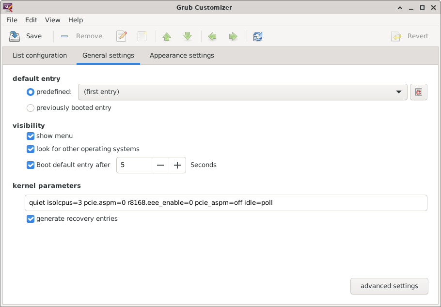

Have you added
pcie.aspm=0 r8168.eee_enable=0 pcie_aspm=off idle=poll
to the kernel command line? (via grub)
Sometimes that is needed also.

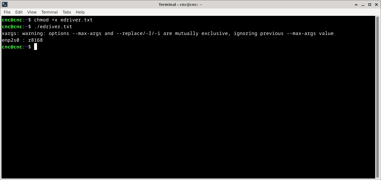

To make sure you are running the dkms driver, try running this script:
To run this, first
chmod +x edriver.txt
and then
./edriver.txt
(from the Downloads directory)
and paste the results here.
(not my script but nicely lists network drivers)

29 Oct 2024 15:49 #313442
by greg23_78
- Posts: 18105
- Thank you received: 5328
29 Oct 2024 17:13 - 29 Oct 2024 17:20 #313446
Replied by PCW on topic Solution fo "hm2 error finishing read" with no good PC
That looks like the standard realtek 8168 driver rather than the DKMS driver
so it sounds like the DKMS driver install did not work for some reason

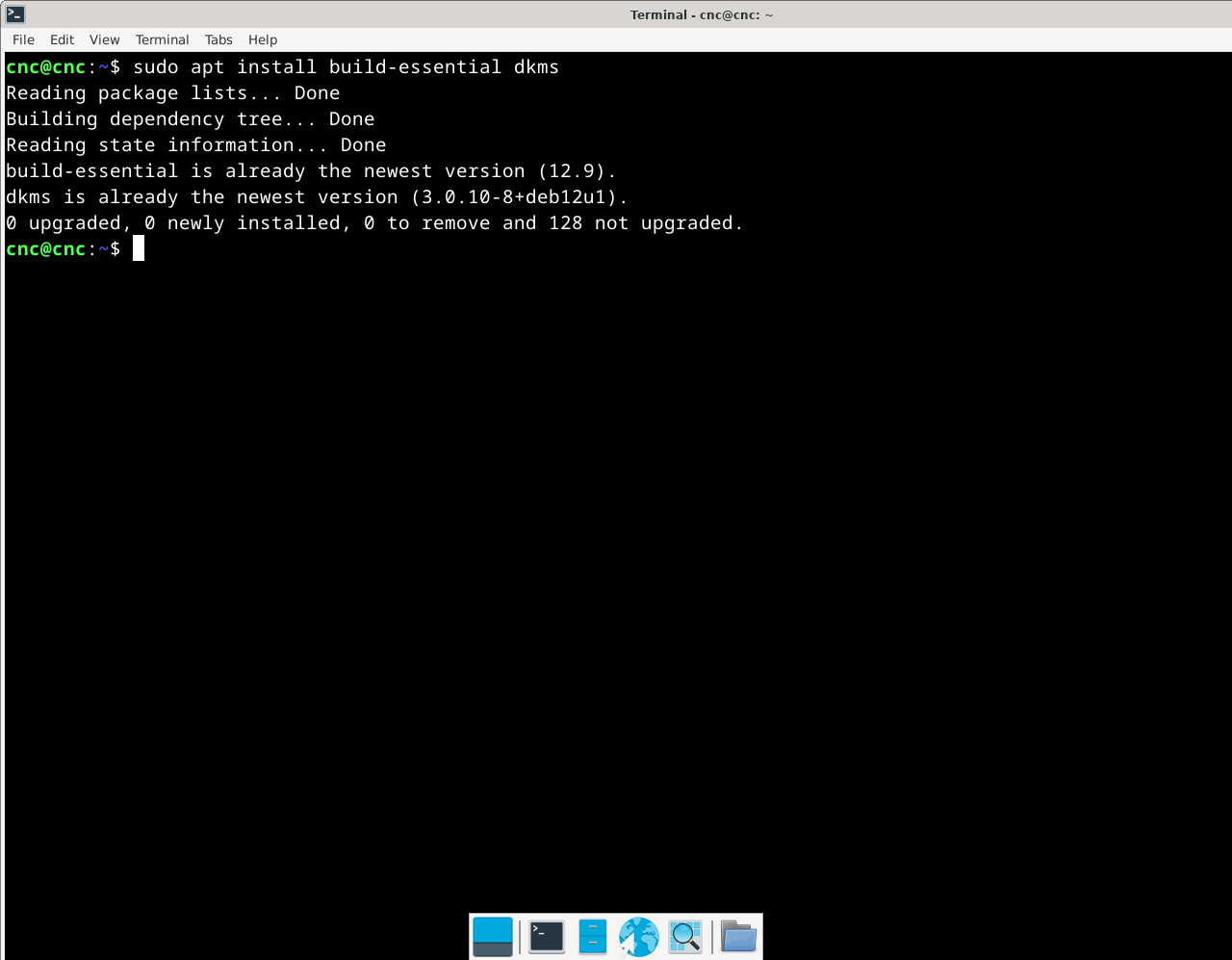

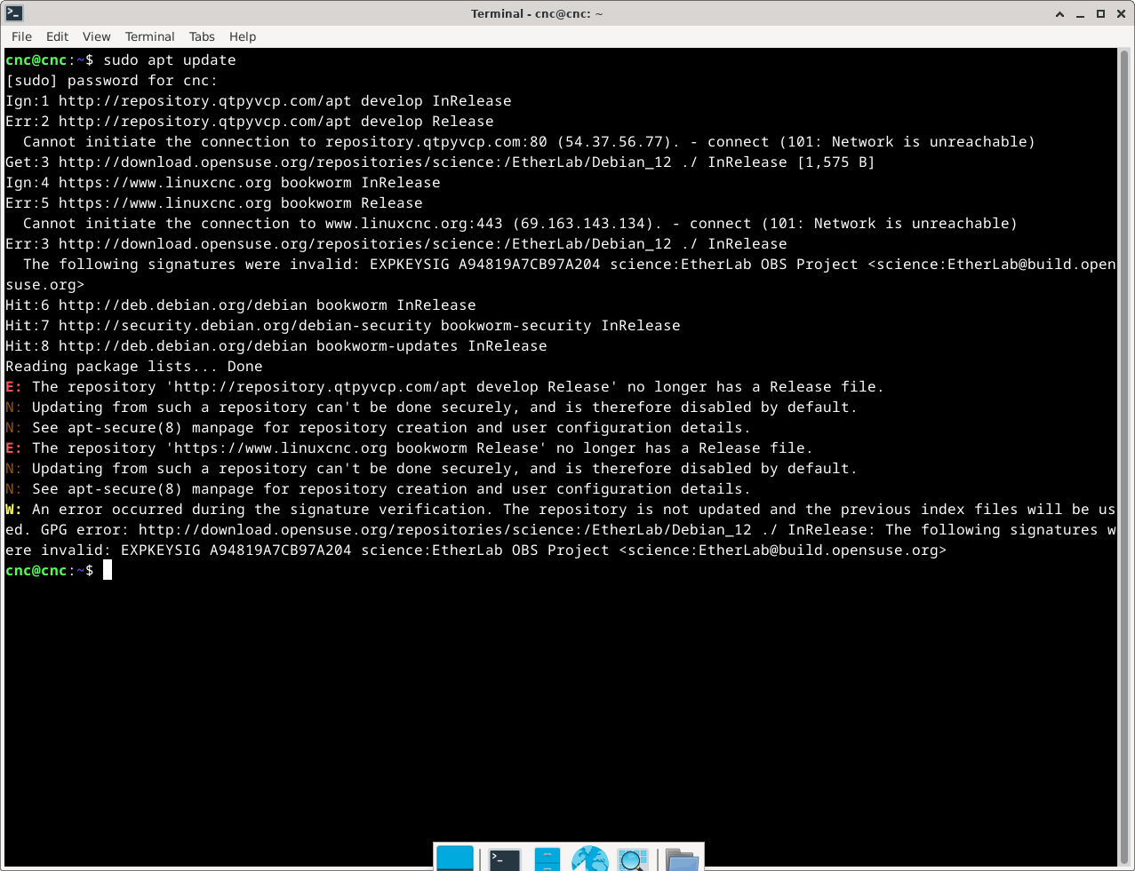

Replied by rodw on topic Solution fo "hm2 error finishing read" with no good PC

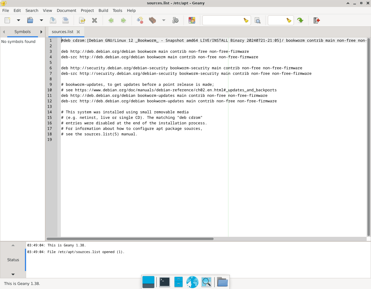

Please follow steps 44-58 in the google doc on the other thread.
I don't think you have installed the r8168-dkms driver.
