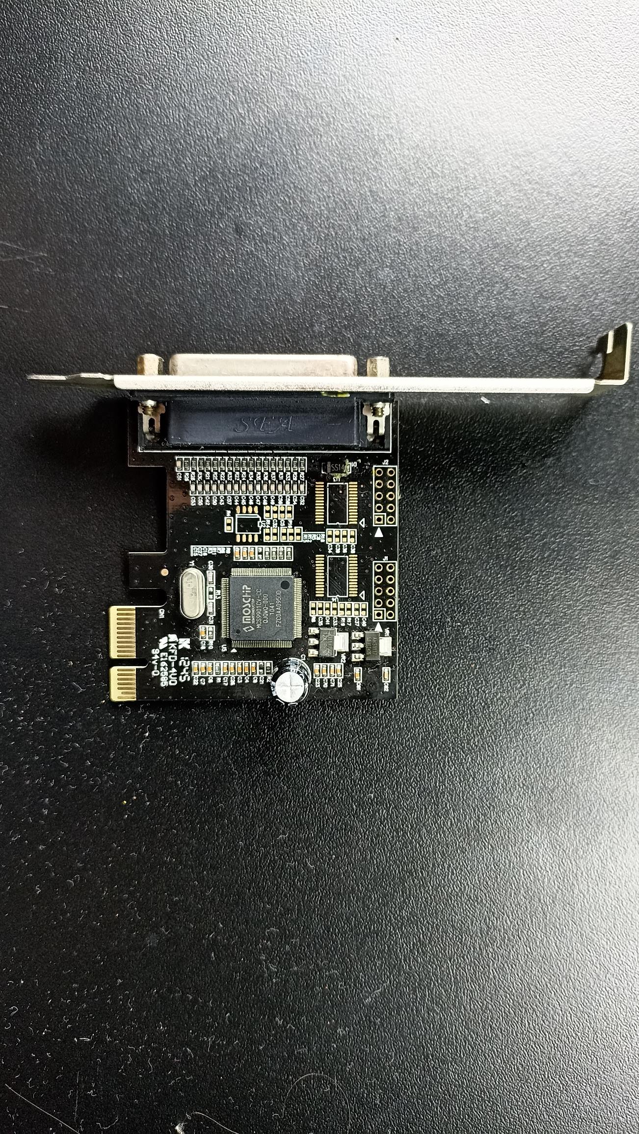

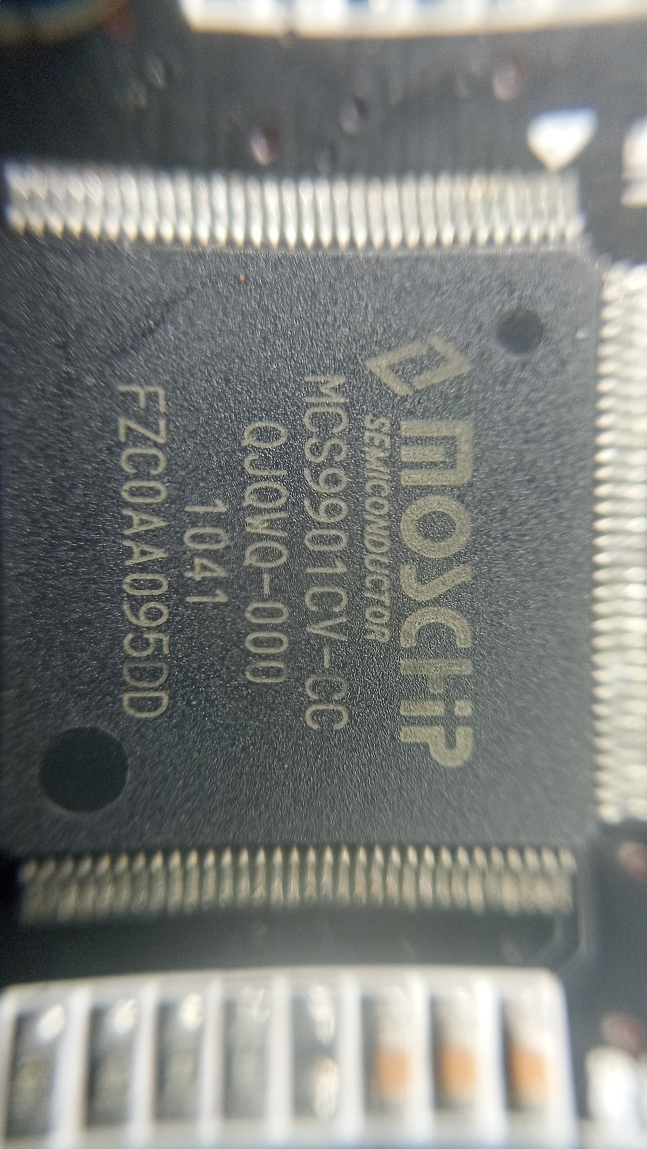

29 Mar 2025 00:52 #325215
by ContinenteCNC
That's a great idea! Much more meaningful info than a screenshot.
I think we can make your file format a tempate for this topic. I will update my posts to match your idea.
By the way, how have you managed to setup these wch chipsets to work? It there some special trick? I have never been able to make them work.
Replied by ContinenteCNC on topic PCI and PCI-E add on cards with parallel port that work out of the box
The asm1083 is a PCIe to PCI bridge. The other chip would be the chip with the parallel etc functions.
Photos are ok, but the real bit of important info is the PCI ID number.
If you look at the text file I attached a couple of posts ago as well as having info regarding the parallel port cards it also has a couple of commands as where to get the info from the file system. Like what mode the card supports and stuff like that.

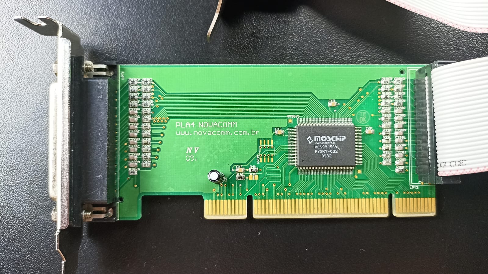

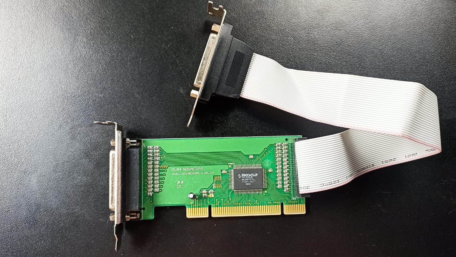

02 Apr 2025 17:13 #325529
by ContinenteCNC

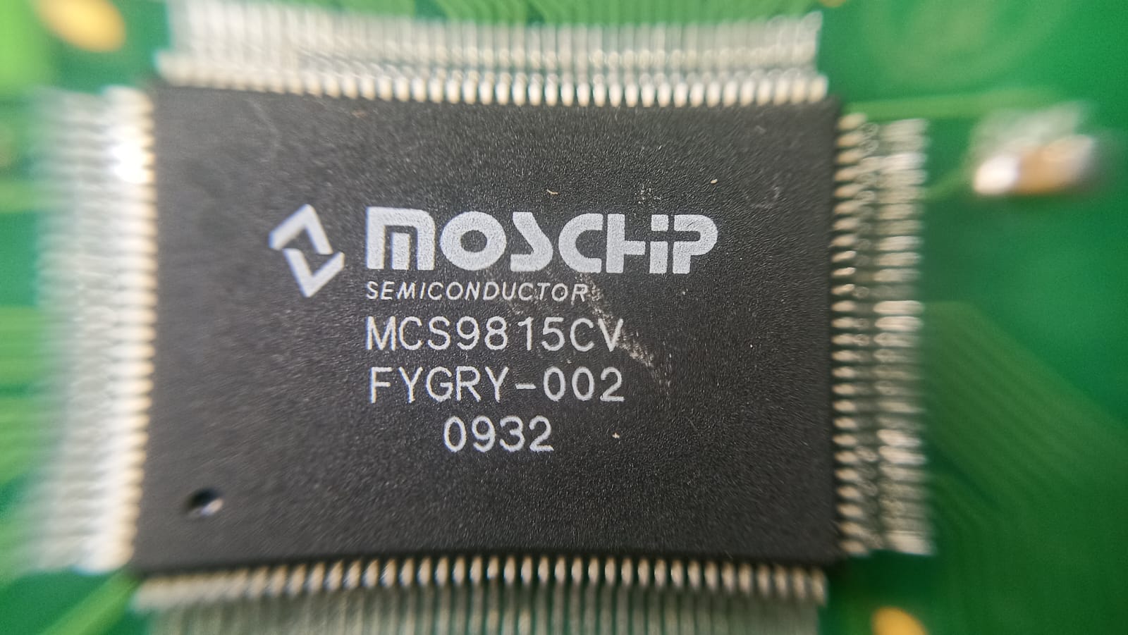

05 Apr 2025 01:13 - 05 Apr 2025 01:14 #325730
by ContinenteCNC
