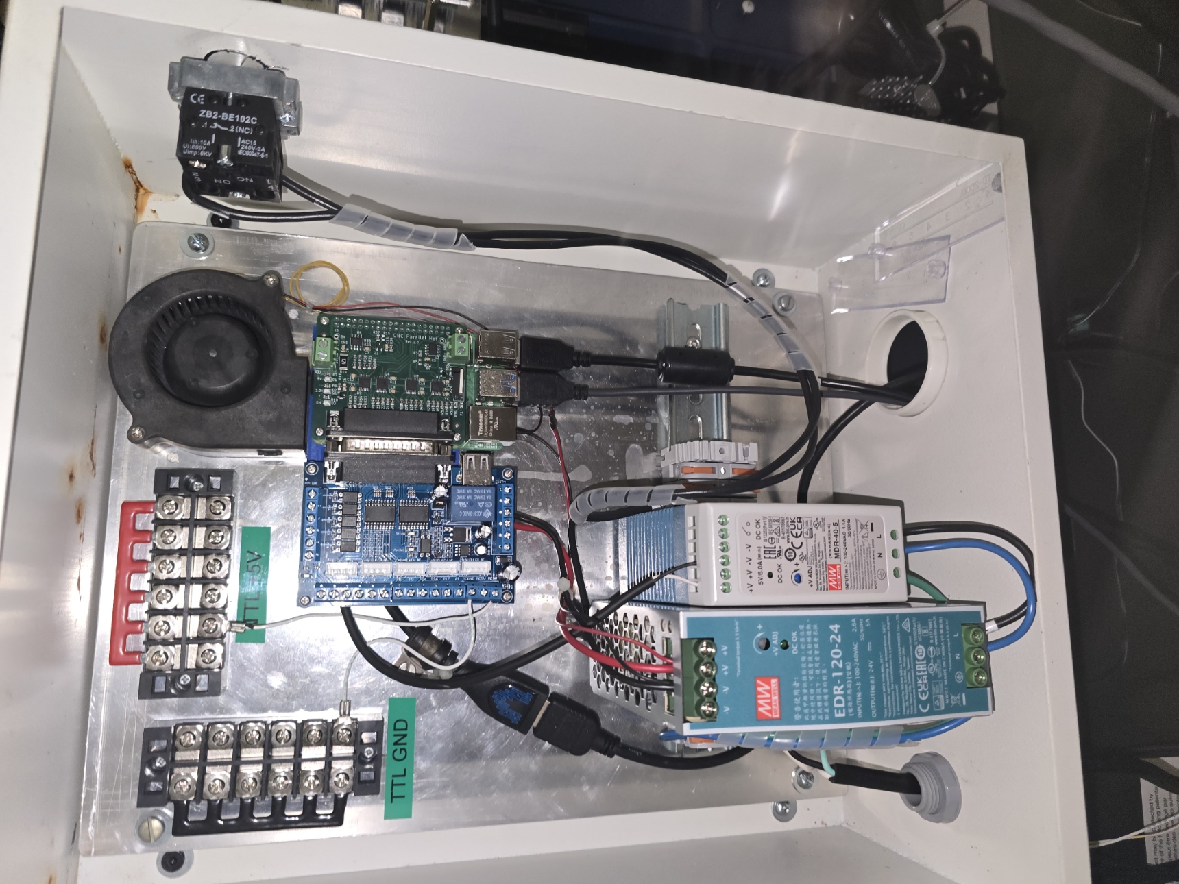

I wonder, is there a Raspberry HAT that can direct interface with a stepper driver ?

you can use this bob directly on the RPI GPIO's:
www.amazon.de/DollaTek-5-Achsen-CNC-Brea...reiber/dp/B07PNDXZQK
only need to build an adapter cable, there are no 5v comming out of the bob on the db25 side, no risk to damage the gpio's.

I've just been down that road (at least one of them):
forum.linuxcnc.org/9-installing-linuxcnc...aughter-board#339636
