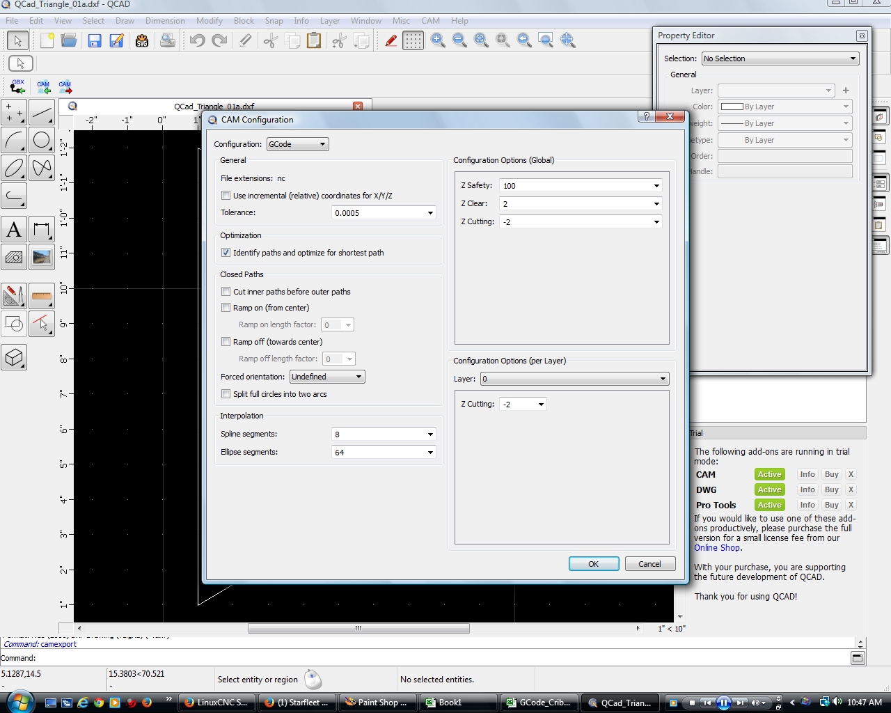

By 'Mix' what I did is set the G20 in my Preamble. Then about 1100 lines of code later, to cut out the actual triangle, I popped in the G21.
I have not tested this yet, but it looks good on screen.

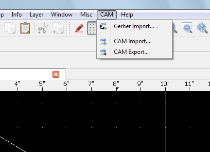

CAM export.
I presume you've clicked on the [CAM] menu option...?
...and nothing happens?

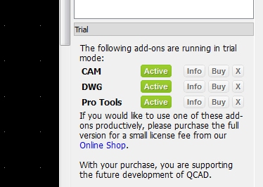

My first guess is that the time has expired regarding your 15min activation. Before you try the export, Look in the lower right for the following =
The 'Properties Window' may be in the way, preventing you from seeing this. If these are green, you're good to go. If not, you must SAVE THE FILE, exit the program, re-open the file, THEN export.
CAM export.

Are you running Qcad in windoze or Linux? Yea, I had three green's and tried selecting the circle then clicking on export. Does a prompt come up to get any info before the G code file is created?
JT
JT

I didn't get it to work in Linux, so I was testing on XP. If if will do a decent job of generating a profile it will be a time saver for me on plasma.
JT

3.4 and Cam show active. I just tried it on this windoze and the Ubuntu 10.04 next to it and nothing happens when I click on export cam.
I see Command: camexport on the command line when I click the button... but nothing.
Cam Import however works well...
JT
