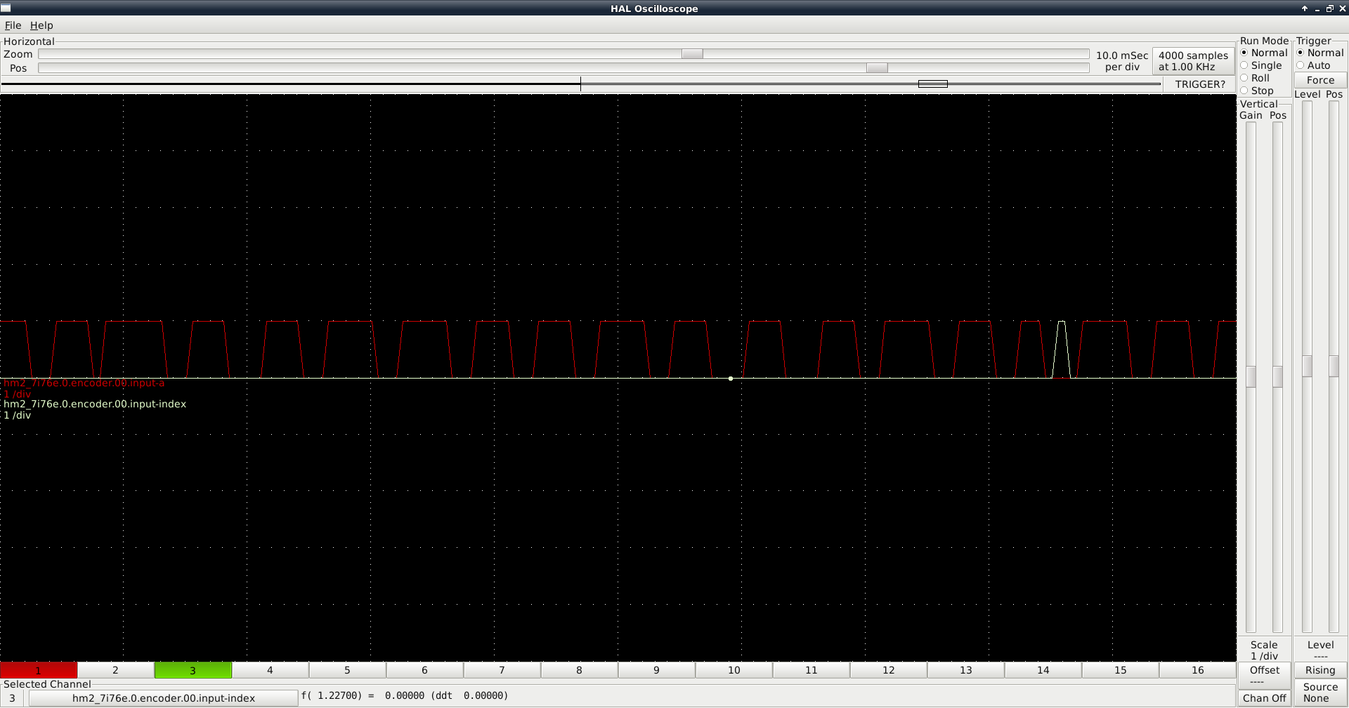

I'll attach some files from halscope on my encoder signal.
In the "HAL-Scope-7" image isn't it pretty weird that the index signal is so sporadic?

The index probably isn't really sporadic, it is more likely that it is a short pulse and Halscope often misses it.

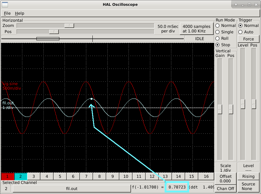

The relation between the lowpass filter 'gain' and its
bandwidth is shown on the man page:Ref: linuxcnc.org/docs/2.7/html/man/man9/lowpass.9.html
Note:
1) a is the filter cutoff frequency (-3dB) in radians/sec
a=2*pi*frequency_in_Hz.
2) T is the sample interval in seconds
Using the computed gain=0.0609 and an input amplitude of 1,
the filter output for a 10Hz input should be attenuated
by 3dB or equal to 0.707:
Other notes:
a) If you know the gain, the filter 3dB cutoff frequency (radians/sec) is:
b) for a single pole lowpass filter, the risetime (10 to 90%) is related
to the bandwidth (in Hz) as:Ref: en.wikipedia.org/wiki/Rise_time
$ man lowpass
gain = 1 - e^(-a * T)Note:
Using the man page example for a 10Hz filter:
a=2*pi*10 # lowpass filter with 10Hz cutoff (-3dB) frequency
T=0.001 # typical 1mS servo period
g=0.00609 # computed 'gain'
Test using halrun with a 10Hz sine wave and 1mS (=1000000nS) period:
$ halrun
loadrt siggen names=sig
loadrt lowpass names=fil
loadrt threads name1=thd period1=1000000
setp sig.frequency 10
setp sig.amplitude 1
setp fil.gain 0.0609
net input <= sig.sine => fil.in
net output <= fil.out
addf sig.update thd
addf fil thd
startUsing the computed gain=0.0609 and an input amplitude of 1,
Other notes:
a = - (1/T) * ln(1-gain)b) for a single pole lowpass filter, the risetime (10 to 90%) is related
risetime = 0.35/BW

The index signal is sporadic because its too short to be captured at the 1 ms servo thread rate. This is a general issue with any kind of sampled system like halscope. Because halscope is only sampling the index signal every 1 ms, pulses shorter than 1 ms will not always be detected.
I would expect a higher resolution encoder to be much better, but 150 should be ok if a bit rough
