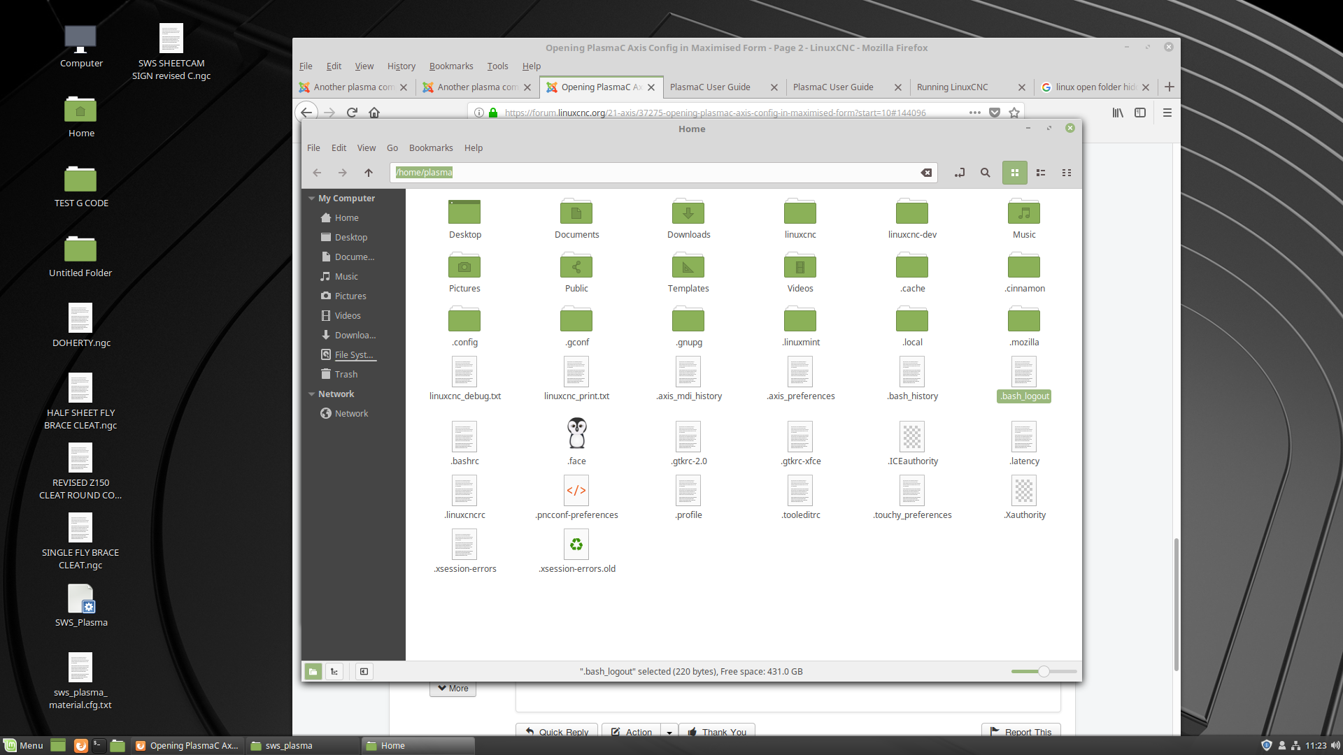

04 Sep 2019 00:09 #144097
by phillc54
Replied by phillc54 on topic Opening PlasmaC Axis Config in Maximised Form
Use a file browser with hidden files enabled and check if you have a .axisrc file in your home directory. If you do, rename it and then try your machine config and an Axis sim.
- thefabricator03
- Visitor
04 Sep 2019 00:30 #144098
by thefabricator03
Replied by thefabricator03 on topic Opening PlasmaC Axis Config in Maximised Form
What do I rename it to?
- phillc54
- Posts: 5711
- Thank you received: 2100
04 Sep 2019 00:34 #144099
by phillc54
.axisrc_old will do
- thefabricator03
- Visitor
04 Sep 2019 01:24 #144105
by thefabricator03
I have checked the below directory and I do not have that file,
