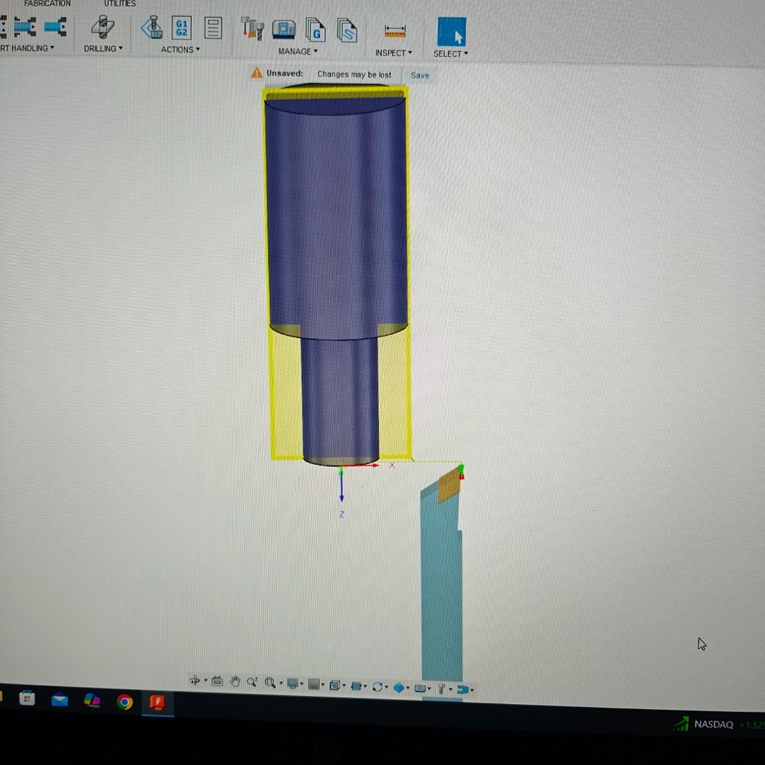

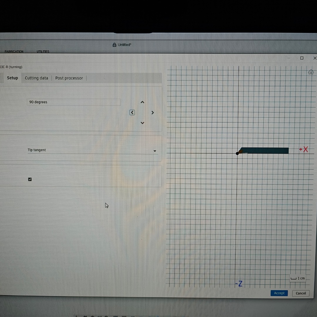

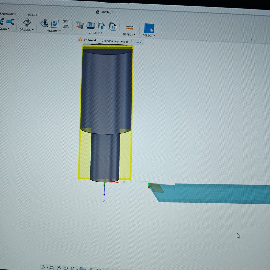

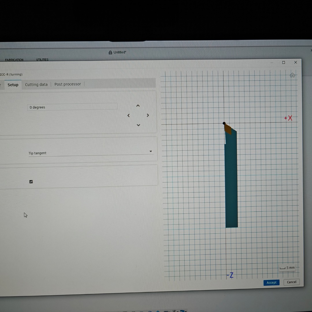

When I loaded the linuxcnc pawn it came in as the earlier post , inverted When I made a model in fusion , it did the same thing. Messing around with fusion could it be something I'm doing wrong in fusion. The first pic is the tool orientation which looks wrong but it comes up correct in the tool path pic 2. Pic 3 is the tool orientation which I think is correct , but tool is wrong once in tool path , pic 4

The actual tool you plan to use looks like what? Insert facing up (as you're looking down on lathe), tip towards centerline, and main cutting edge to left? Or insert facing down?
EDIT -
Based on your screenshots, I think you've maybe got the spindle rotation wrong, which is why the tool appears to be reaching across the part centerline.
Here's a good explanation of tool orientation and how F360 spindle direction affects the toolpath and tool orientation display:
mgfx.co.za/blog/engineering-manufacturin...-cutting-directions/
Replied by spumco on topic Spindle location on the opposite side
Ok, starting to make a little more sense - you're getting bitten by F360's tool orientation mess and the actual program you loaded may be wrong, not your lathe.When I loaded the linuxcnc pawn it came in as the earlier post , inverted When I made a model in fusion , it did the same thing. Messing around with fusion could it be something I'm doing wrong in fusion. The first pic is the tool orientation which looks wrong but it comes up correct in the tool path pic 2. Pic 3 is the tool orientation which I think is correct , but tool is wrong once in tool path , pic 4
EDIT -
