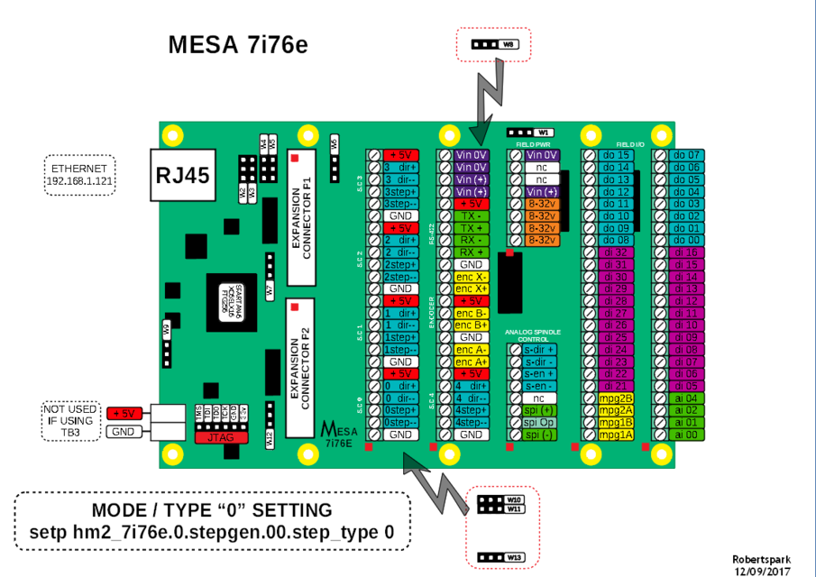

super. linuxcnc is accepting it.
i did the halcmd show pin and param again for pwm. see file.
now how do i know which physical pin i have to use on the mesa for this?

You do not want to loadrt pwmgen at all, because you are going to be using the hardware pwmgen, not a software pwmgen
At the minimum you need these setup changes
#load pwmgen for run pwm delete
loadrt pwmgen output_type=0 delete
addf pwmgen.update servo-thread delete
#addf pwmgen.make-pulses base-thread delete
setp pwmgen.0.pwm-freq 500.0 change to
setp hm2_7i76e.0.pwm_frequency 10000
setp pwmgen.0.scale 100.0 change to
setp hm2_7i76e.0.pwmgen.00.scale 100
setp pwmgen.0.offset 0.0 delete
add
setp hm2_7i76e.0.pwmgen.00.output_mode 2 (this is up/down mode)
And then the connection changes:
net Xen => pwmgen.0.enable change to
net Xen => hm2_7i76e.0.pwmgen.00.enable
net pwmgen_value pwmgen.0.value <= emcochanger.setpwm change to
net pwmgen_value hm2_7i76e.0.pwmgen.00.enable <= emcochanger.setpwm
net pwmgen_out pwmgen.0.pwm => hm2_7i76e.0.7i76.0.0.output-01 delete

i get the error: hm2_7i76e.0.pwm_frequency does not exist
what does hm2_7i76e.0.pwmgen.00.enable meen? lets say that i want to use the 4th (step dir 3) in row of the stepper terminal screws?
what about:
sig-forward emcochanger.forward ==> ?

This likely means you are not using the correct firmware or do no have the hardware pwmgen enabled
You cannot, the PWM outputs replace stepgen 4 on the firmware i supplied
what about:
in1 goes to 3 dir +
in2 goed to 3 step +
Not sure but with the hardware PWMgen set to up down mode
you will get PWM on Step4 Step in one direction and Step4 DIr in the other direction

Here are the 7i76e PWM related pin and parameter names I get:via halcmd
I did have to change the search for pwm to pwmgen since halcmds
wildcard search apparently does not work with partial words
pcw@HP-8300 ~/linuxcnc/configs $ halcmd show pin *pwmgen*
Component Pins:
Owner Type Dir Value Name
23 bit IN FALSE hm2_7i76e.0.pwmgen.00.enable
23 float IN 0 hm2_7i76e.0.pwmgen.00.value
pcw@HP-8300 ~/linuxcnc/configs $ halcmd show param *pwmgen*
Parameters:
23 bit RW FALSE hm2_7i76e.0.pwmgen.00.out0.invert_output
23 bit RW FALSE hm2_7i76e.0.pwmgen.00.out0.is_opendrain
23 bit RW FALSE hm2_7i76e.0.pwmgen.00.out1.invert_output
23 bit RW FALSE hm2_7i76e.0.pwmgen.00.out1.is_opendrain
23 s32 RW 1 hm2_7i76e.0.pwmgen.00.output-type
23 float RW 1 hm2_7i76e.0.pwmgen.00.scale
23 u32 RW 0x00004E20 hm2_7i76e.0.pwmgen.pdm_frequency
23 u32 RW 0x00004E20 hm2_7i76e.0.pwmgen.pwm_frequency
