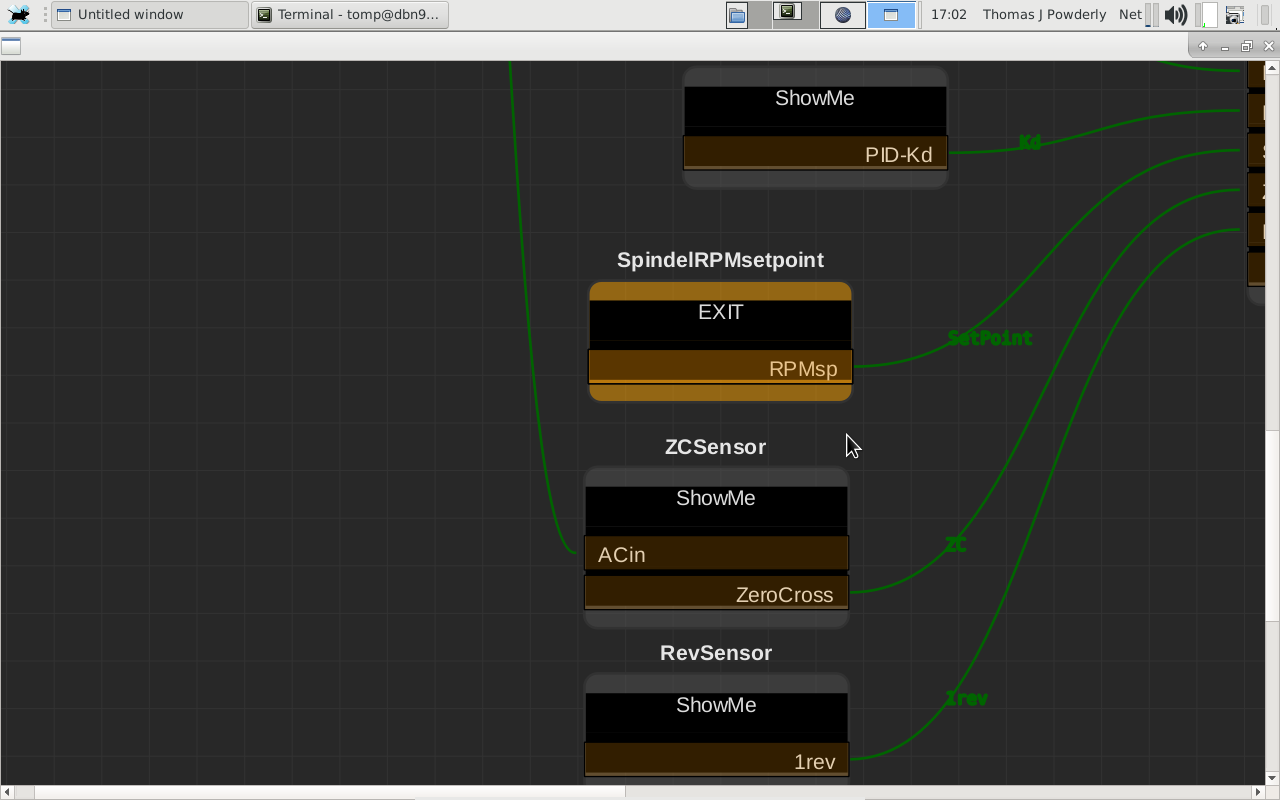

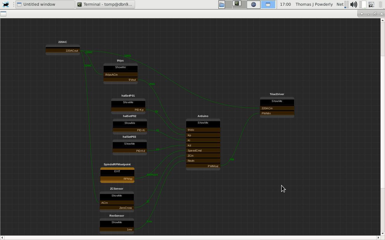

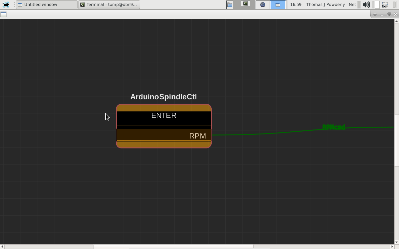

- tjtr33
- Posts: 170
- Thank you received: 54
27 Nov 2021 06:00 #227731
by tjtr33
Replied by tjtr33 on topic Graphing a HAL configuration
I worked some more on the hal diagrammer. It is an editor, meaning you can chaneg the look of the diagram . Someday I may be able to make it load and save Hal files, but for now ot it loads and saves a json file. I can reposition items, take screen shots and explain the hal files, I have lots to do. I used my own EDM system as the test hal file. I had tried RockHopper long ago whenit first came out. I IRC, it was not able to move and edit and save and reload. But if some kind user would tell me that Rockhopper was an editor ( add items connect items disconnect save load...) Then I would install it and look. I have spent yonks of time in these efforts and a simple advice could save me a lot of time. Thanks TomP
( sorry the tgz file is right at the 1.5meg limit, I dunno if it will be available )
BTW PyCharm was a bust, I only use python ( 2.7/3/3.5 all work ) and PyQt5 (no PySide)

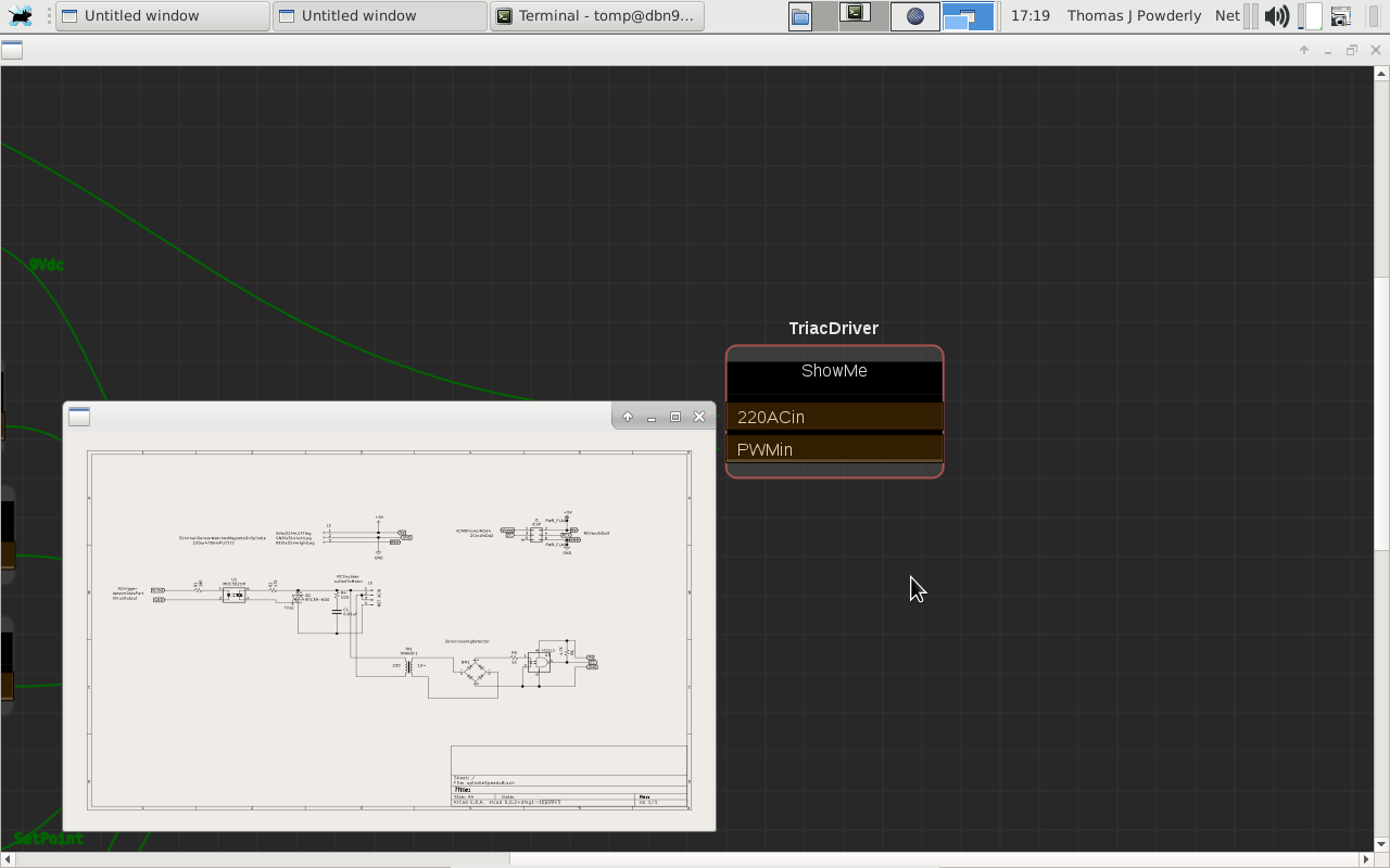

23 Dec 2021 08:39 #229810
by tjtr33
Hi Andy, I took your tip about looking into Rockhopper, so I could parse .hal.
I have all the prerequisites for Rockhopper, but I get stuck when i try to run :
I found that the .hal file did not include all the data needed to create the graph ( the datatype and dir of each pin)
I began to use halrun and halreport to gather the data and decided to look into how Rockhopper did this.
but got stuck...
any idea's ?
(meanwhile i poke around the source code to see what the error means.)
(also, I got popups and hover info and hyperlinks and subsheets working)
thx TomP
