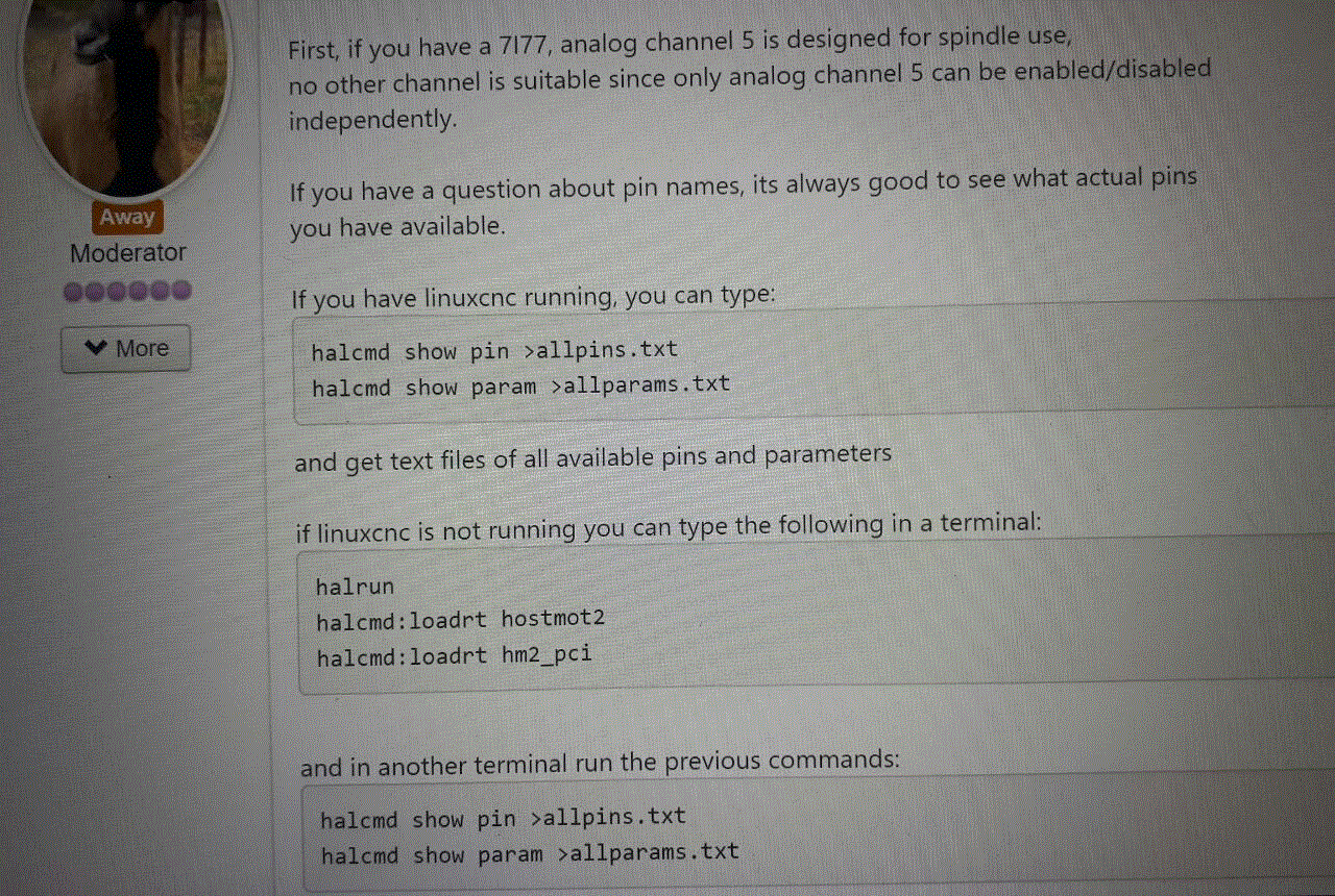

halcmd show all > all.txt
I have to enter that command in my linux terminal, is it correct?

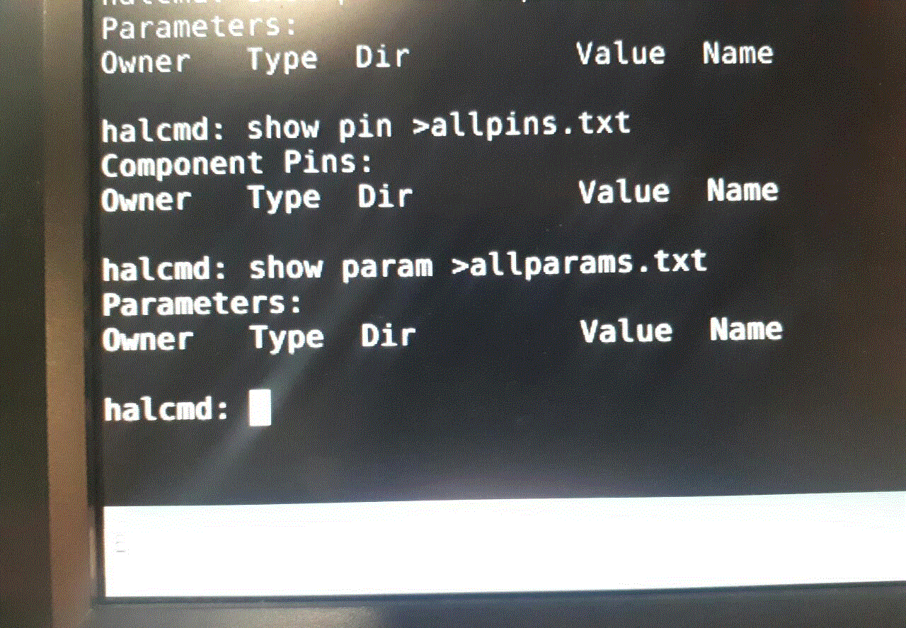

Dear
for some reason I can't get the pins
I am executing in the terminal according to the procedure
but the list of pins does not appear
They could tell me what I'm doing wrong

Use of terminals is not my specialty so I can only tell you how I do it. You need to open the terminal while linuxcnc is running. You may need to # some lines on hal files to get rid of the error messages or revert back to a hal file that was a working configuration. As an example the last error you posted was for the at speed LED and you could change in your hal file
net spindle-at-speed => gmoccapy.spindle_at_speed_led
to
#net spindle-at-speed => gmoccapy.spindle_at_speed_led
until we get it figured out.
Second once you have linuxcnc with the terminal running do the following in terminal:
and this should change the directory to your linuxcnc directory. This will allow the file to be saved there. Then in the terminal:
to
cd linuxcncand this should change the directory to your linuxcnc directory. This will allow the file to be saved there. Then in the terminal:
halcmd show all > all.txtPlease Log in or Create an account to join the conversation.

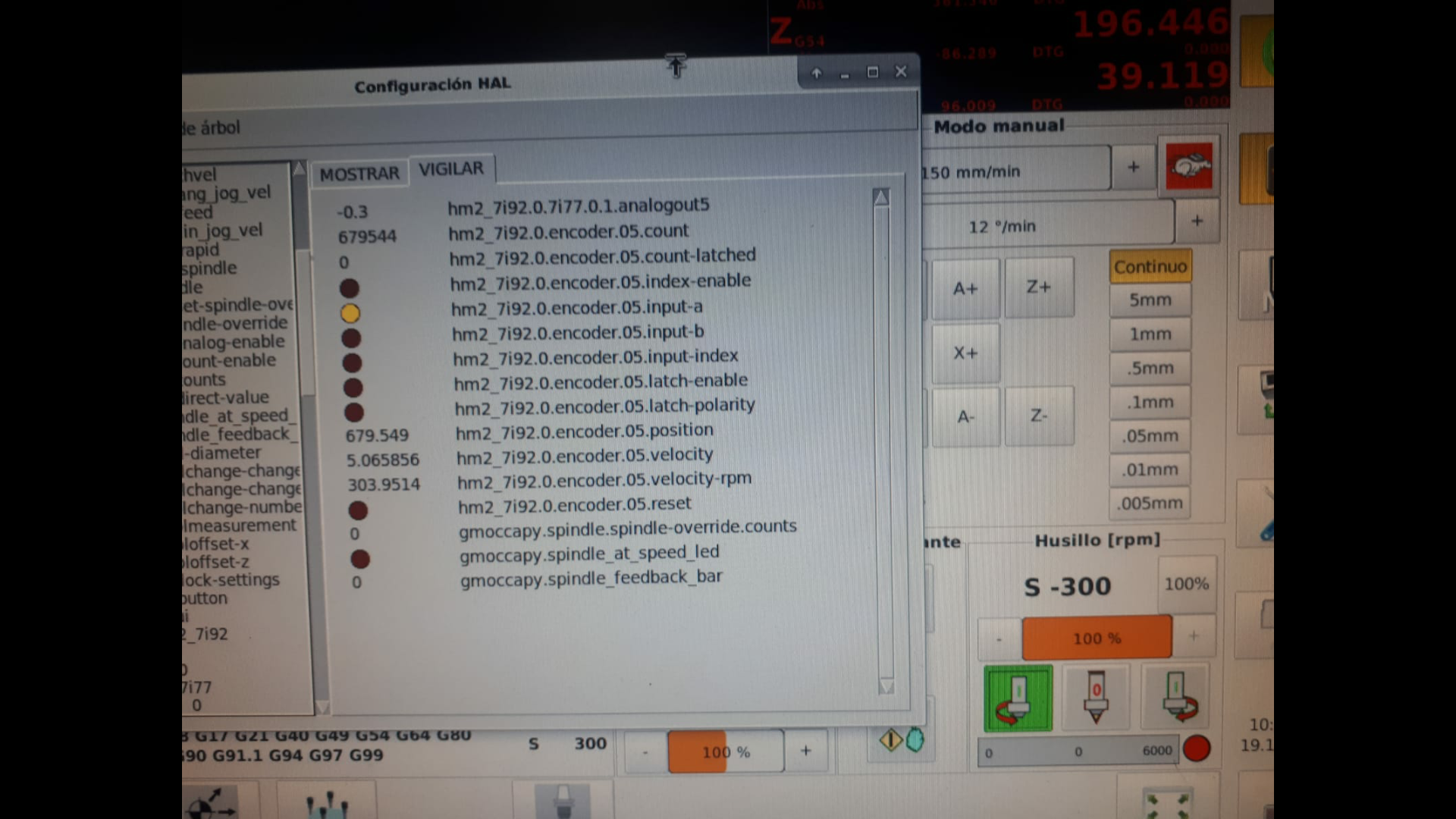

hello Michael
due to lack of experience it is very difficult for me
I cannot get a list of pin in the terminal
maybe you see this can help
i did a test the halshowYou can see that the encoder signals are there but still I don't have feedback

- Michael
- Posts: 335
- Thank you received: 59
26 Dec 2021 10:32 #230020
by Michael
Replied by Michael on topic I can't get spindle speed feedback
You need to move the Hal commands that we discussed previously to the correct Hal file. The pins you need don't show up until after linuxcnc is started. Move all of the above Hal information to the file in your setup called custom_postgui.hal
