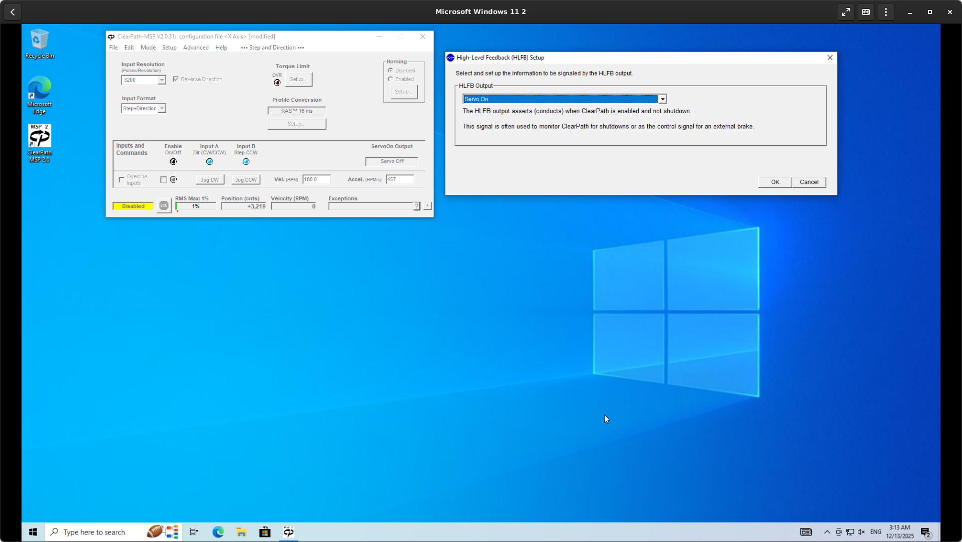

Good, thanks for verifying the servos are programmed appropriately.

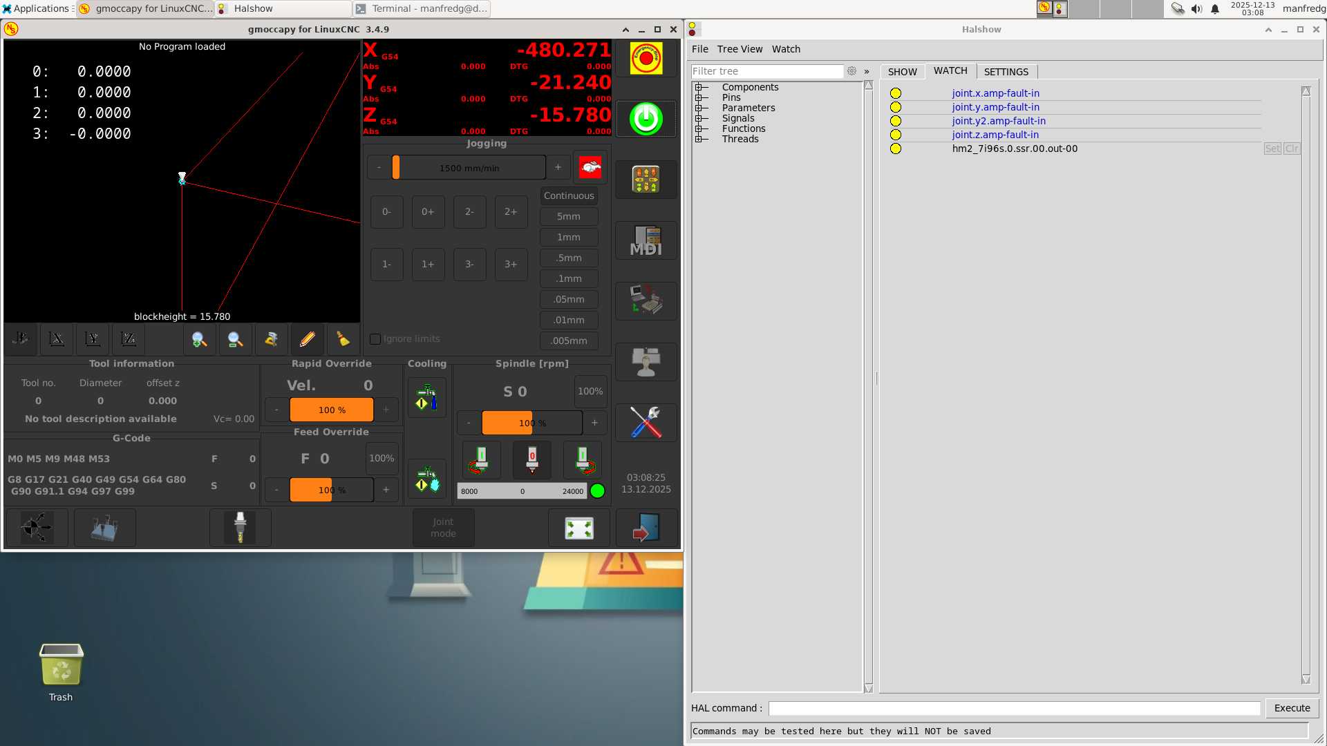

Right now, your HLFB pins are HIGH (conducting) when the servos are enabled and OK. Since you have the inputs connected to your amp-fault-in pins like:
LCNC thinks there is a fault when the servos are saying everything is OK. Here's the LCNC manual section (motion):
joint.N.amp-fault-in IN BIT should be driven TRUE if an external fault is detected with the amplifier for this joint.
Try changing the HLFB input pins to 'not' like so:
At that point, the joint.N.amp-fault-in pins should be HIGH when the servos are not enabled, and go LOW when they are enabled and OK.
Once you're at that point, you can test by pulling the encoder cable off the motors and see if it causes the amp-fault-in to go high (hopefully).
If you still need a delay we can work on that next.

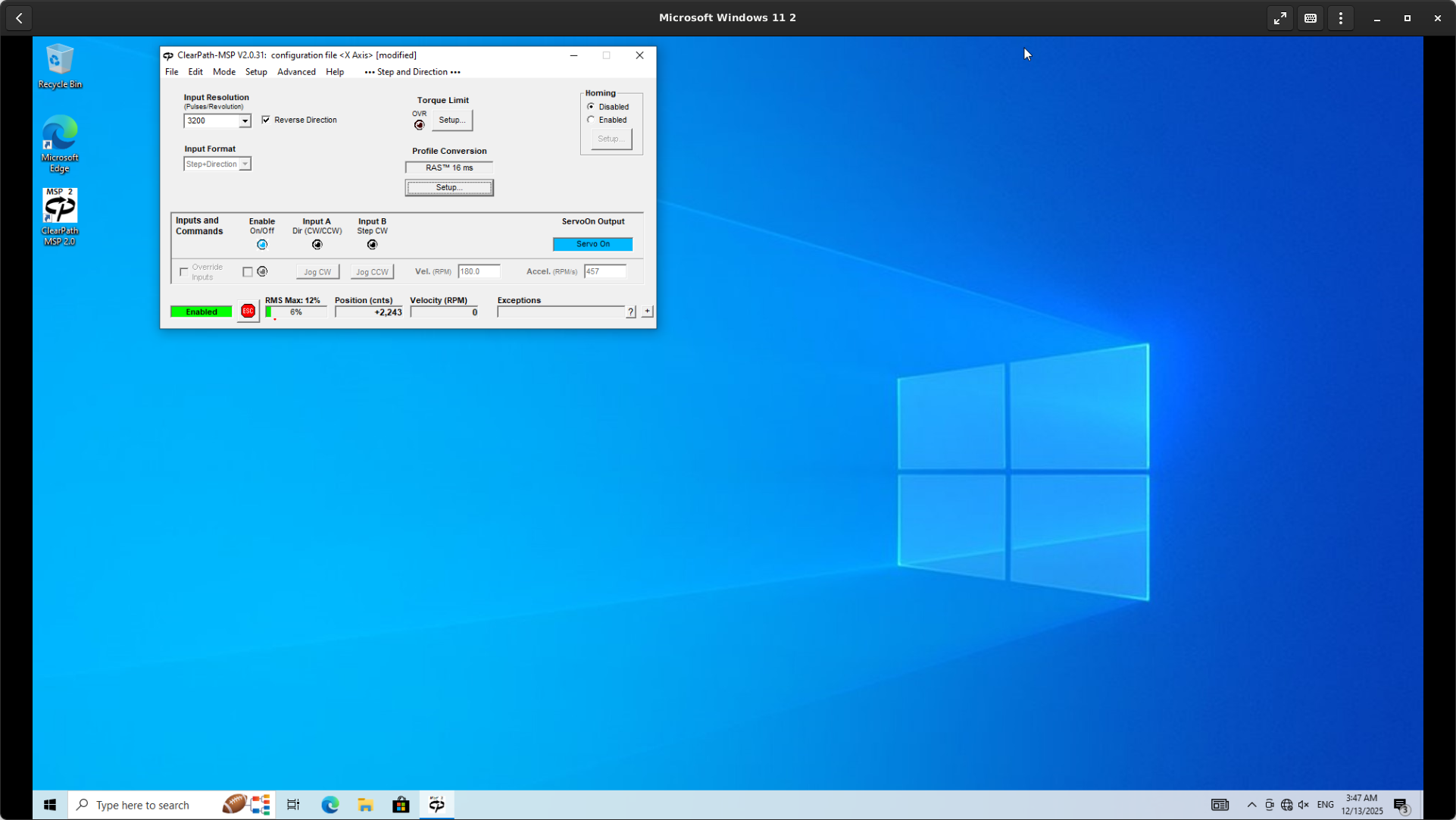

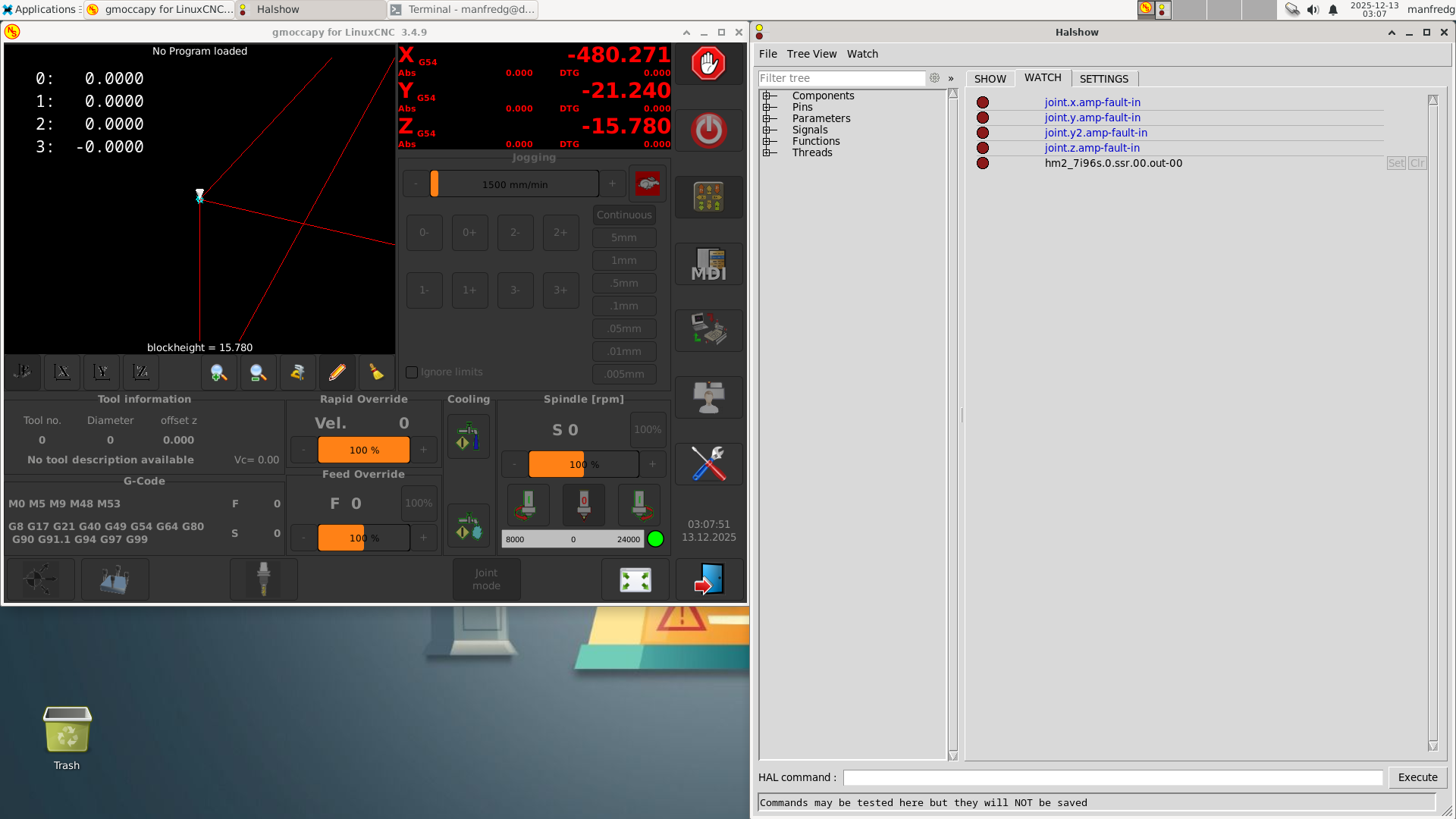

- Fastfred
- Posts: 61
13 Dec 2025 22:49 #340077
by Fastfred
Replied by Fastfred on topic Clearpath HLFB amp.joint.delay
OK I corrected the .hal file and pins are reversed like you said but unfortunately still same issue no pop up in GUI no indication something wrong. I can move the axis linuxcnc thinks everything is OK.
- spumco
- Posts: 2169
- Thank you received: 896
14 Dec 2025 01:54 #340081
by spumco
Replied by spumco on topic Clearpath HLFB amp.joint.delay
I think the problem is that the joints are supposed to have numbers, not letters.
Like
joint.0.amp-fault-in
I just realized you haven't created a signal name, just linked two pins. Because your joint.(lettter).amp-fault-in pin doesn't actually exist, LCNC is creating a SIGNAL named joint.(letter).amp-fault-in.
That's why you aren't getting an error at startup.
Try this
net x-fault joint.0.amp-fault-in hm2_7i96s.0.inm.00.input-1-not
and so on for the others.
Like
Try this
- Fastfred
- Posts: 61
14 Dec 2025 20:23 #340098
by Fastfred
I tried changing the naming, but had to use different name because was already assigned to pin.I get joint fault as soon as i try to enable I did try changing delay thinking that was it but no luck. Unless I still having a naming issue with the pins unfortunately I still don't understand this part yet.
