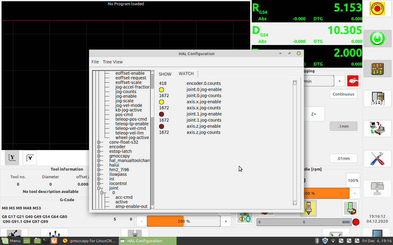

I have my MPG connected as in this example:
gnipsel.com/linuxcnc/hardware/mpg.html
On my lathe the outputs are to axis.x.counts, and axis.z.counts. The whole signal change works in HALSHOW, with encoder movement changing all the counts through to those axis pins, but no motion. The appropriate axis.x.jog-enable (or axis.z.jog-enable) are both connected and working, but no motion happens. I have done a fair bit of searching but find no reference to Gmoccapy specific pins or settings I need for this to work.
It make no difference whether the axis is homed or not. No motion.
I have attached the postgui HAL. Please help.
Mark

Thanks Rod, I have the encoder reading in, the axis select working, and the jog increment working. The jog counts are going to the assigned axis.[].jog-counts, but nothing is moving?

04 Dec 2020 20:52 #191070
Replied by PCW on topic Pimping the mini-lathe
I don't see anyway that the jog scale values are set
The default scale is likely 0 so if these are not
set, I would not expect any motion
That is I don't see
joint.N.jog-scale
axis.C.jog-scale
connected in your hal file
They may be connected in you main hal file
but are certainly something to add to your
halshow debug watch list

04 Dec 2020 21:26 #191074
by RotarySMP
Replied by RotarySMP on topic Pimping the mini-lathe
Those last three lines:
net jog.inc1 select8.0.out1 => gmoccapy.jog.jog-inc-0
net jog.inc2 select8.0.out2 => gmoccapy.jog.jog-inc-1
net jog.inc3 select8.0.out3 => gmoccapy.jog.jog-inc-2
set the jog increments to continuous, 0.1mm and 0.01mm I defined in the Gmoccapy ini. This works. I flick that switch and the corresponding gmoccapy screen button becomes active. Also the on screen jog buttons follow this setting correctly.
I thought I had tried setting joint.[].jog-scale and axis.().jog-scale to 1 or other values to see if that did anything, but it makes sense if I am passing steps of 0, nothing happens. I'll try again setting them to 1 tomorrow.
