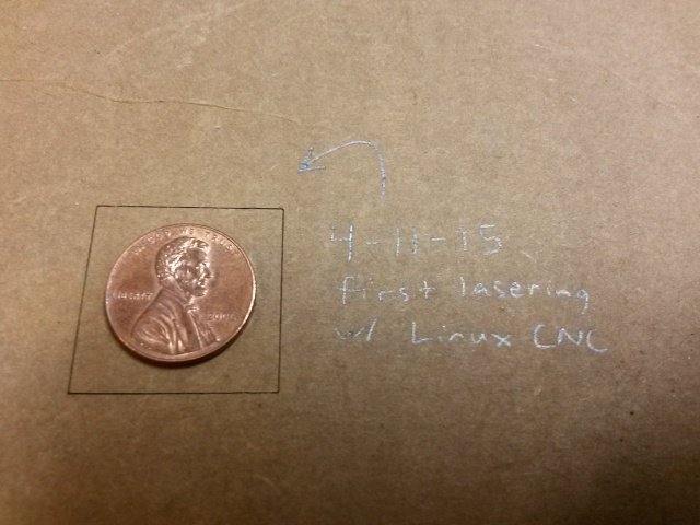

12 Apr 2015 01:58 - 12 Apr 2015 01:59 #57693 by dbotos
Replied by dbotos on topic Mesa 5i25 with plain G540, no 7i77
Based on Peter's response, BobS's hal file snippet, and the hostmot2 manual , motion manual , and Spindle Control page , I came up with the following hal section for my laser "spindle":
# this is the frequency of the PWM signal (10 kHz) (max for Kale CNC 445 nm 1400 mW module is 20 kHz)
setp hm2_[HOSTMOT2](BOARD).0.pwmgen.pwm_frequency 10000
# this is the spindle speed [rpm] equivalent to 100% laser power
setp hm2_[HOSTMOT2](BOARD).0.pwmgen.00.scale 10000
# start PWMGen ouput when spindle turns on (passes TRUE bit)
net spindle-on motion.spindle-on => hm2_[HOSTMOT2](BOARD).0.pwmgen.00.enable
# pass commanded spindle speed [rpm] to PWMGen value, which gets divided by "scale" to yield PWM duty cycle
net spindle-speed-cmd motion.spindle-speed-out => hm2_[HOSTMOT2](BOARD).0.pwmgen.00.value
# hm2_[HOSTMOT2](BOARD).0.pwmgen.00.pwm should already be tied to DB25 pin 14 (i/o 1) based on 5i25_g540x2 configuration
I bumped the PWM frequency up to 10 kHz since the hostmot2 manual says "Frequencies below about 5 Hz are not terribly accurate, but above 5 Hz they’re pretty close." I've got the laser's TTL input connected to DB25 pin 14 on my breakout/passthrough board and DB25 pin 18 connected to the laser's ground pin (page 5 of the 5i25 manual says DB25 pins 18-21 are GND) (which essentially makes the laser ground, laser power supply ground, and DB25 ground all common).
So, before I let the magic smoke out of anything, does the above hal file section and physical wiring look like it should work?
Thanks,
David
Last edit: 12 Apr 2015 01:59 by dbotos.
12 Apr 2015 02:53 - 12 Apr 2015 02:53 #57694 by PCW
Replied by PCW on topic Mesa 5i25 with plain G540, no 7i77
A couple of things:
Note that the manual says PWM frequencies are not accurate below about 5 Hz ( _not_ KHz )
So 1 KHz will be quite close in frequency
Not that its very important but a quick calculation shows that the
PWM frequency setting accuracy at 1KHz is about 1 part in 3000.
10 KHz may be a bad choice if it's at the limits of the laser drivers capabilities.
You might test the output with a LED and a resistor connected to Pin14
Last edit: 12 Apr 2015 02:53 by PCW.
The following user(s) said Thank You: dbotos
12 Apr 2015 09:02 #57706 by dbotos
Oops - yes you're right it's 5 Hz. I set my PWM frequency back to 1 kHz. I found a good diode to test it out with - it already had all the wires hooked up...
^^^1" square on cardboard, 100% power, 30 IPM B) <-- me with my laser safety googles on
Now I need to get SheetCAM installed and remember how to use it... It was in the latter half of 2013 that I decided to ditch Mach3 and make the switch to LinuxCNC and Mesa hardware. I got busy with other stuff in 2014 and finally got back to it this Spring. One of those things I wish I did sooner now that I see it wasn't too bad. I'm sure I'll be back with more questions when I go to hook up my plasma and torch height control. Thanks for all the help!
David
