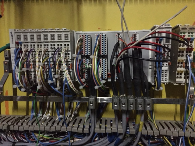

09 Apr 2015 05:56 - 09 Apr 2015 05:56 #57639 by db1981
Replied by db1981 on topic Retrofitting WEEKE BP05
urkee this is my setup :
-EK1100 Ethercat Coupler
-3xEL1008 24 D Ins
-3xEL2008 24 D Outs
-EM7004 16 DIn, 16 Dout, 4x Aout +-10V, 4x Encoder RS485,
-EL9505 5V PSU
Analog In for feed pot is not yet mounted.
Next Step is placing a few of the Ethercat Modules directly on the Head, to get place and to establish order in the cabinet. Also i will not need the 25years old chain cables anymore.

10 Apr 2015 20:39 #57663 by urkee
Replied by urkee on topic Retrofitting WEEKE BP05
Thank yoou all guys!
You probably won't be able to count on accuracy better than about +-0.05mm (since one encoder count is 0.006375mm.) - Todd how do you calculate maschine resolution and acuracy for maschine with incremental encoders? can you show us formula?
db1981 thank you setup info. Do you run your weeke on linuxCNC or twinCUT CNC? What are 4 integrated incremental encoders in EM7004 modul for, have you used this option? I assume that with additional ethercat modules on head you can remove all cables for electrovalves, encoder feedback and limit switches and just energy cables will rest ? With analog-in you want to connect original feed pot on weeke cpanel? I got the original manual for encoder from balluf, you were wright it is 5V differential.

11 Apr 2015 00:07 #57667 by db1981
The Weeke runs with Linuxcnc to learn something new, in business i work with Twincat and Siemens but the CNC Licence is to expensive for my own use... (i did this all on christmas ;) )
Also i love the idea behind Linuxcnc much better than my closed systems at work. To write realtime components in real C is an very good option, also the other stuff (embedded)python etc.
Its very interesting for me, its wonderful the break the chains of the normal IEC PLC world.
The Encoders on the 7004 are the 3 Axis an one mpg (handwheel). with the additional ethercat on head, you can manage all sensors and actors... my encoder cables ends still in the cabinet, there is the em7004.
You can use single encoder interfaces (EL5101) instead of the em7004, and put them on the head.
Limit switches are in safty circuit, so you can't collect them on the bus, or you have to use "safty over ethercat", but its expensive. I connect all orginial buttons from my panel.
