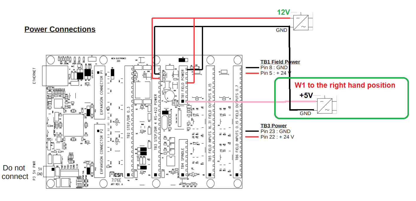

@newbynobi
Thanks again for the connection sheets.
However there seems to be a minor flaw in it concerning the Field Power connection as pointed here out by PCW: forum.linuxcnc.org/plasma-laser/40517-do...ons?start=120#193043
Nothing should connect to TB1 pin 5 (VIN)
VFIELD (TB1 pins 1..4) is where +24V power goes
From the manual:
The isolated field I/O on the 7I76E runs from a switching power supply that can be powered by field power or a separate supply (VIN) with ground common with field power.Normally the 7I76E will be powered with field power and an on card jumper, W1 allows VIN to be connected to field power. If you wish to use a single power supply for the 7I76Es field outputs and field logic power, W1 should be placed in the left hand position. This connects field power to VIN. If you wish to use a separate supply for VIN, W1 Should be placed in the right hand position.
Your schematics works but the bulk of the field power current goes through the Jumper W1 instead of just the power for the field I/O processor. Also manipulation of the jumper when powered might damage the output drivers.

28 Sep 2022 08:18 #252918 by Karri
Replied by Karri on topic My 7i76e Connection Sheet
Hi
Could someone double check my schema to use 12V as logic power and 5V as field power
BR:Karri
04 Oct 2022 11:53 - 04 Oct 2022 19:11 #253438 by fons
Replied by fons on topic My 7i76e Connection Sheet
as fare as i see on my setup
just conect the power conector tb1
gnd at pin 8 (the side of the board) + 12v (+24v) at pin 2
it look like pin 1, 2, 3, 4 and 5 are the same and give power to tb6 and tb5
on tb6 are no gnd conections to make only one common gnd conected to pin 8 on tb4
pin 1 to 4 can be used as analog or digital input
pin 5 to 16 are digital input
pin 17 to 24 are digital output
