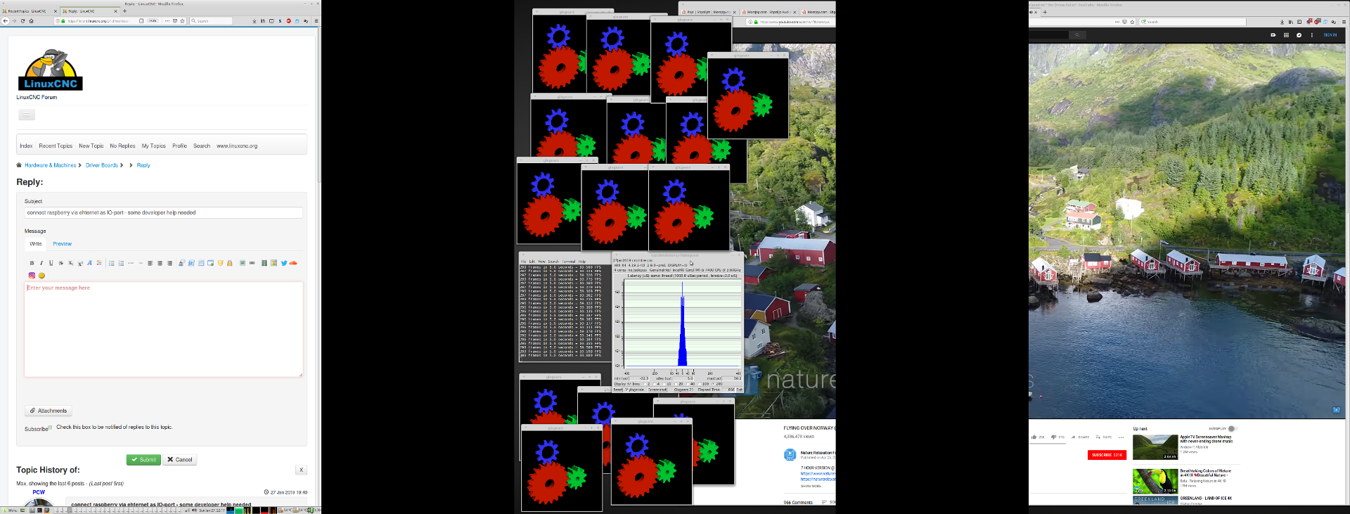

27 Jan 2019 21:41 #124992
Replied by tommylight on topic connect raspberry via ehternet as IO-port - some developer help needed
This is what i get get from my latest computer assembled last 2 days an installed fresh about an hour ago:
Warning: very big picture ahead !
LinuxMint Mate 18.3
4.19.1-rt3
i7 7400
Asus PRIME Z270-a
XFX AMD RX580
M.2 SSD 256GB
Black stripes are between monitors (there are 4 EIZO 24" monitors connected, but using 3 ), have to figure out how to remove that void. I had an Asus GTX 1060 6GB on it yesterday and it has no voids in between monitors, great, but crapped out when booting Preempt-RT kernel.
