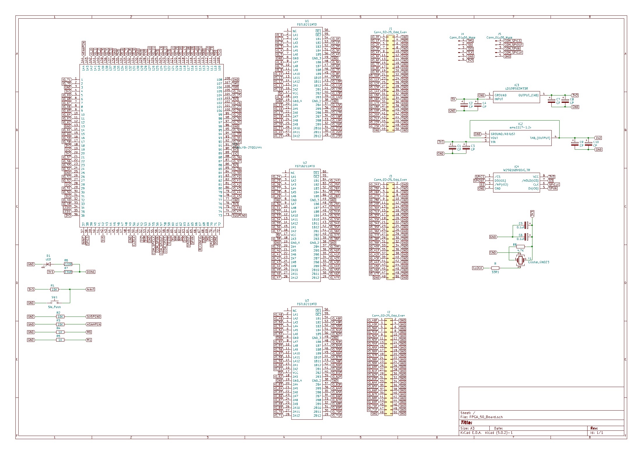

02 May 2019 09:09 - 02 May 2019 09:34 #132498
by gtt38
Replied by gtt38 on topic Flash a XC6SLX9 dev board as a 7i90HD
I want to thank you again PCW.
I read 2 books on VHDL and i understood a little bit more the code, and it's beatifully written.
Now i can compile every firmware i want, i'm better with ISE.
I discovered many things during these fews days, i really thing that my boad has a counterfeit XC6SLX9. You can find it for 3$ in China maybe less if ordered in quantity. That's why you could have this dev board for less than 20$. So my advice is to avoid this kind of products.
So i decided to create my own design with a genuine XC6SLX9-2TQG144C, totally open source to make my experimentations with MCU. It's a really simple board with simple specifications : 100x100mm 2 layers, 72 I/O on 3 connectors (mesa daughter compatible) with 3x FST16211, a SPI interface and a 16Mbit flash.
Since i'm not familiar with FPGA i'll need your help to correct my mistakes.
After reading the FST16211 datasheet i think I inverted I/O, how can i drive enable pins too ?
Do i have to protect the SPI too ? Maybe with a 8bits TTL like the FST16211 ?
And many other questions like what's the use of these pins :
_ pin 37
_ pin 59
_ pin 60
_ pin 69
_ pin 67
_ pin 73
_ pin 144
_ pin 37
_ pin 59
_ pin 60
_ pin 69
_ pin 67
_ pin 73
_ pin 144

Thank you
I already checked these schematics like many other XC6SLX9 dev boards but it's not helping for this specific use.

Regarding Pins
Is this of any help ?
www.xilinx.com/support/documentation/use...es/ug385.pdf#page=19

02 May 2019 13:32 - 02 May 2019 13:33 #132535
by gtt38
A little bit thank you. I will follow the same specifications as my dev board for these pins.
I will need advices for the 50mhz crystal too

03 May 2019 01:57 #132590
by InMyDarkestHour
Replied by InMyDarkestHour on topic Flash a XC6SLX9 dev board as a 7i90HD
I think you will have to read the Xilinx docs.....especially UG393 regarding PCB design, there's quite a few docs to go through.
Not as straight forward as designing for a simple adruino type project. Keep going you have an interesting project going on.
