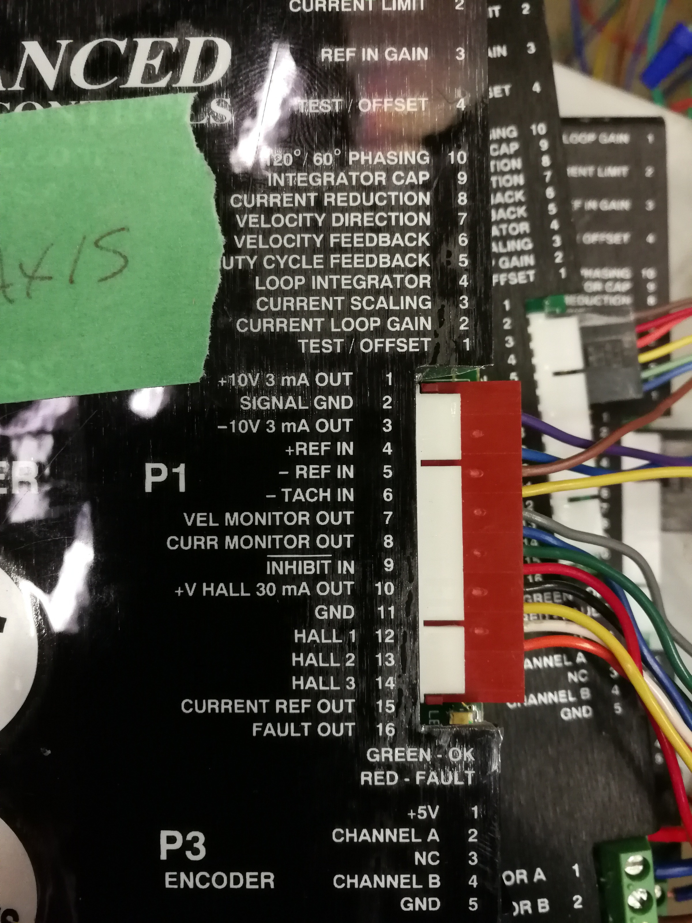

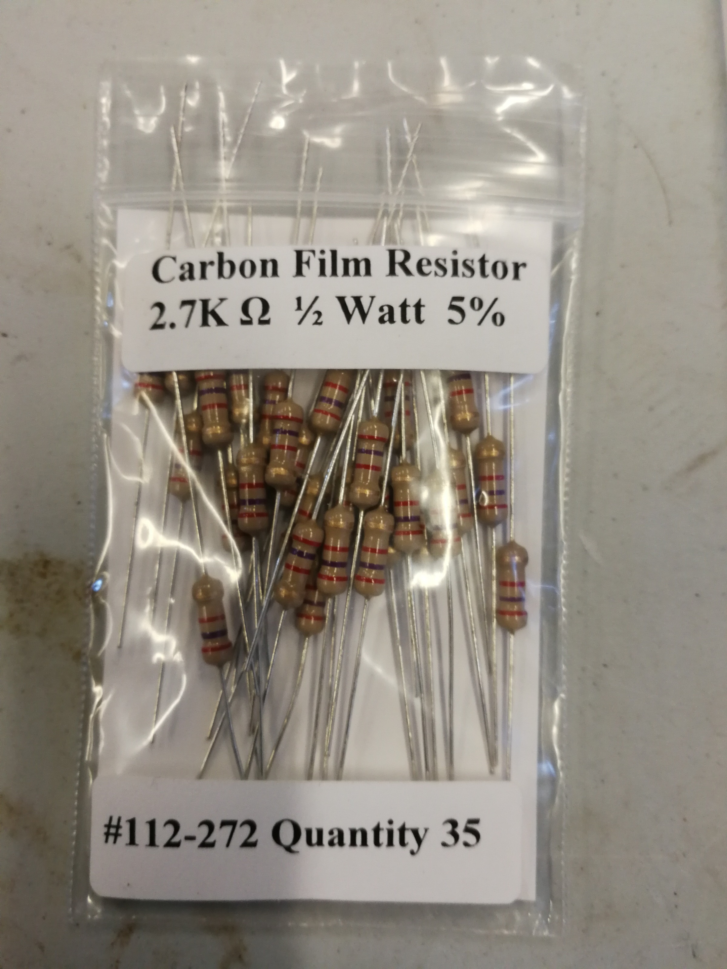

This was the easiest solution, try it.You did say to try a 1KOhm resistor between the inhibit and signal ground but I only have 2.7k resistor will that work or is that to much.
If it does not work with a 2.7K, try two in parallel, or 3 or even 4.
I tried it and it worked, the drive was not enabled, now where do I wire the enable from the 7i77 to on the drive? Do I still go to inhibit?
Did it work with one only ?
Yes it did with only 1

Mesa 7i77 has two pins for enabling each axis, one of those pins goes to inhibit, the other to +5V or +24V depending on the drive.
Just in case it does not work, reverse those two wires on the 7i77.

Ya I got in a bit of a hurry, and with the 2.7 ohm resistor I thought I would try and touch 5v to the inhibit, big mistake as it blew a bunch of fuses in the panel and I think it fried the drive also. Sometimes I'm my own worst enemy.
Luckily it was a spare drive that I tried it on, hopefully I didn't message anything up in the panel.
Ok so the one wire goes to inhibit still with the resistor in place going from inhibit to signal ground, and the other to 5v which is?

That is a huge difference.
2.7Ohm will not work, but the drive should be OK.
There is the +10V 3mA output on the drive, so that would work for the other wire.
Replied by tommylight on topic AMC drive J1 removal.
Is it a 2.7 Ohm or 2.7KOhm ?Ya I got in a bit of a hurry, and with the 2.7 ohm resistor I thought I would try and touch 5v to the inhibit, big mistake as it blew a bunch of fuses in the panel and I think it fried the drive also.

2.7KOhm resistor is OK, but that means you had something else very wrong there, as 2.7K should not do anything when connected to 5V, or 10V or 24V for that matter. That would still be under 1mA of current.
