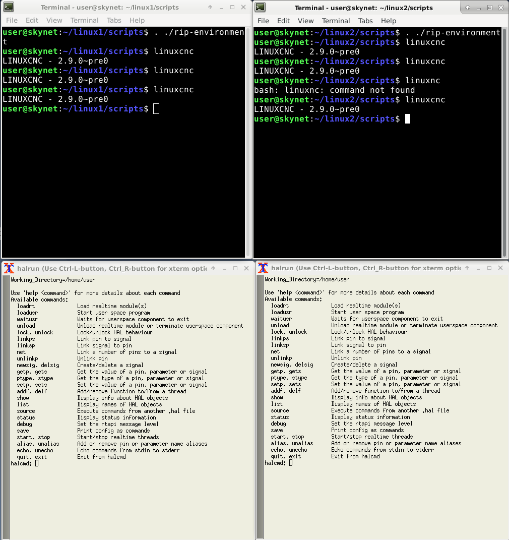

I have done some short tests.
Setup : Did a double lcnc rip install. One rip started gmocappy, the other rip started gscreen.
Found :
- If lcnc starts there it places a lock file in /tmp/. This file is no problem. Can be erased from the source code.
- The shared memory want's to get the same adress, libnml tcp.src.cc line 280, line 281 has some problems.
- Motdot has some problems, if you comment out this at the second startup it looks a little better.
- Emcio also some problems.
Then i started something more simple. The halrun demo program.
Starting the first, and then starting the second, will terminate the first, here the solution is quite easy :
File : halrun.demo, decomment line 52.
** Result is running 2 linuxcnc programs the same time.
When i run my qtc++ program that is connected to lcnc hal and connected to ethercat i can connect as many qt apps as i want to hal.
That's because my app does not check if there is already something running. And if i use shared memory i use fixed memory names, so no interference.
Your interpolation is quite easy i see in the kins source file. With halcommand sending motor positions is easy.
