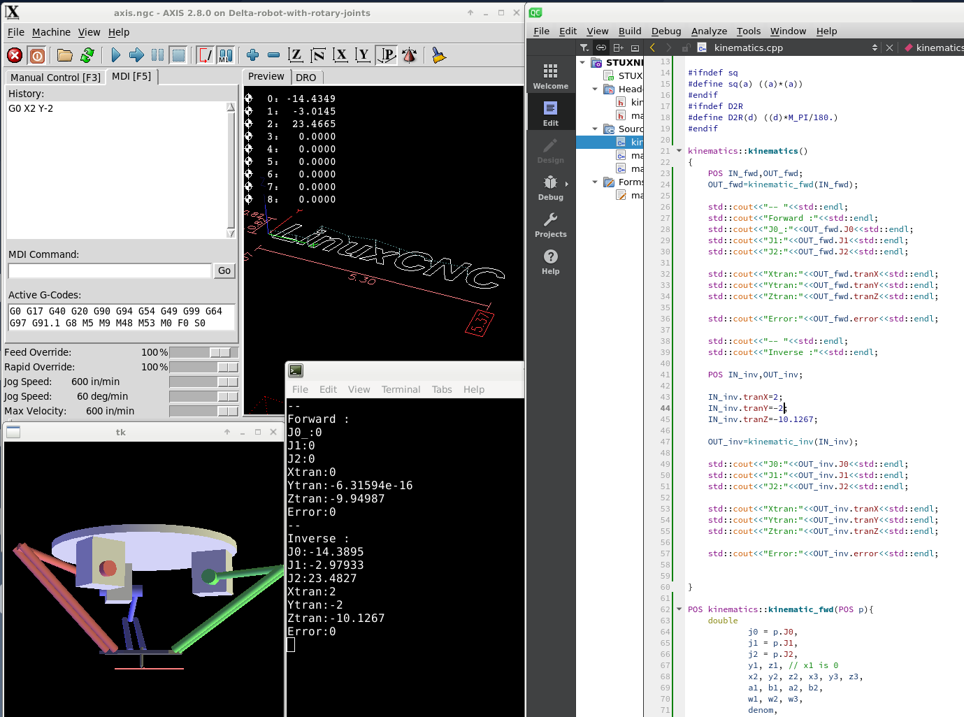

Update:
Just started to code the kinematics in c++. This is working now. Output is checked oke with lcnc.
Now test some more and then simulate more robots at the same time.
The kinematics file is updated. For the cascade every calculation may have a robot with different specifications.
So the cascade may contain small or bigger robots.
For the ammount of robots in the cascade we use a struct. If we have 50 robots. We auto generate 50 structs.

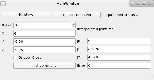

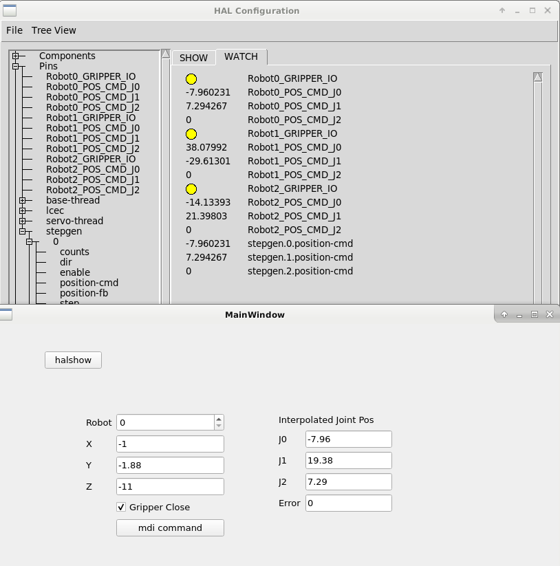

I have now a cascade of 50 robots in c++. Only 3 robots are connected in hal.
The robot dimensions and so on are the same as in the rotary delta example. So you can check the output easy.
I can select a robot number. And do a mdi command for that robot. My ethercat motors at my desk are connected to robot 0.
All working fine. The motors are running to the commanded position.
But my question is how to address each robot? By MDI
Next step? Look for some ethernet io code to your vision pc?
Project code so far attached, i call the program "STUXNET_Cascade". Don't worry about my stepper connections. Servo is much easyer.
