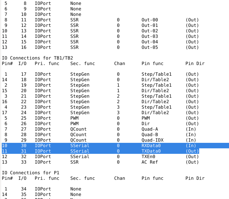

When I do a metaflash readhmid I get just two 'wires' for the sserial. I thought there should be 4?
Last edit: 02 Jan 2022 14:00 by ikkuh.
- Posts: 18111
- Thank you received: 5330
02 Jan 2022 21:12 #230573
Replied by PCW on topic Mesa 7i96+7i85+7i84
That's correct because the FPGA has only one pin for sserial TX and RX
These are converted to differential signals by the RS-485 transciever on the 7I96 card

The documentation says to connect a rj45 cable to TB2 on the 7i96 pin 15-20. I did that and nothing happened (I showed you the lights on the board, two yellow and one red).
Adjusted the loadrt line with all the suggestions here on the forum, none worked. But I can understand that it doesn't work when I connected the wrong physical pins to the rj45 connector.
When I look at the output of the mesaflash --readhmid command I just see the two SSERIAL pins, on TB1/TB2 pin 10 and 11. How can it be then that the rj45 cable should be connected to TB2 pins 15-20? Is there some magic involved?
The readhmid from mesaflash reports different pins and number of pins. I can follow your explanation for the two pins from the FPGA, but you lost me on how two become four wires and on totally different pins.
Could you please open up the 7i96_2022-01-02.txt file and confirm that I am using the correct firmware?
(and thanks, these cards are wonderful when they work, good value for money, but sometimes it's hard to get them configured)
IO Connections for TB1/TB2
Pin# I/O Pri. func Sec. func Chan Pin func Pin Dir
<snip>
10 30 IOPort SSerial 0 RXData0 (In)
11 31 IOPort SSerial 0 TXData0 (Out)
12 32 IOPort SSerial 0 TXEn0 (Out)
IO Connections for P1
<snip>
7 44 IOPort SSerial 0 TXData1 (Out)
8 45 IOPort SSerial 0 RXData1 (In)
9 46 IOPort SSerial 0 TXData2 (Out)
10 47 IOPort SSerial 0 RXData2 (In)
Looks like I have three SSERIAL ports on the 7i96. But how to connect to them?
