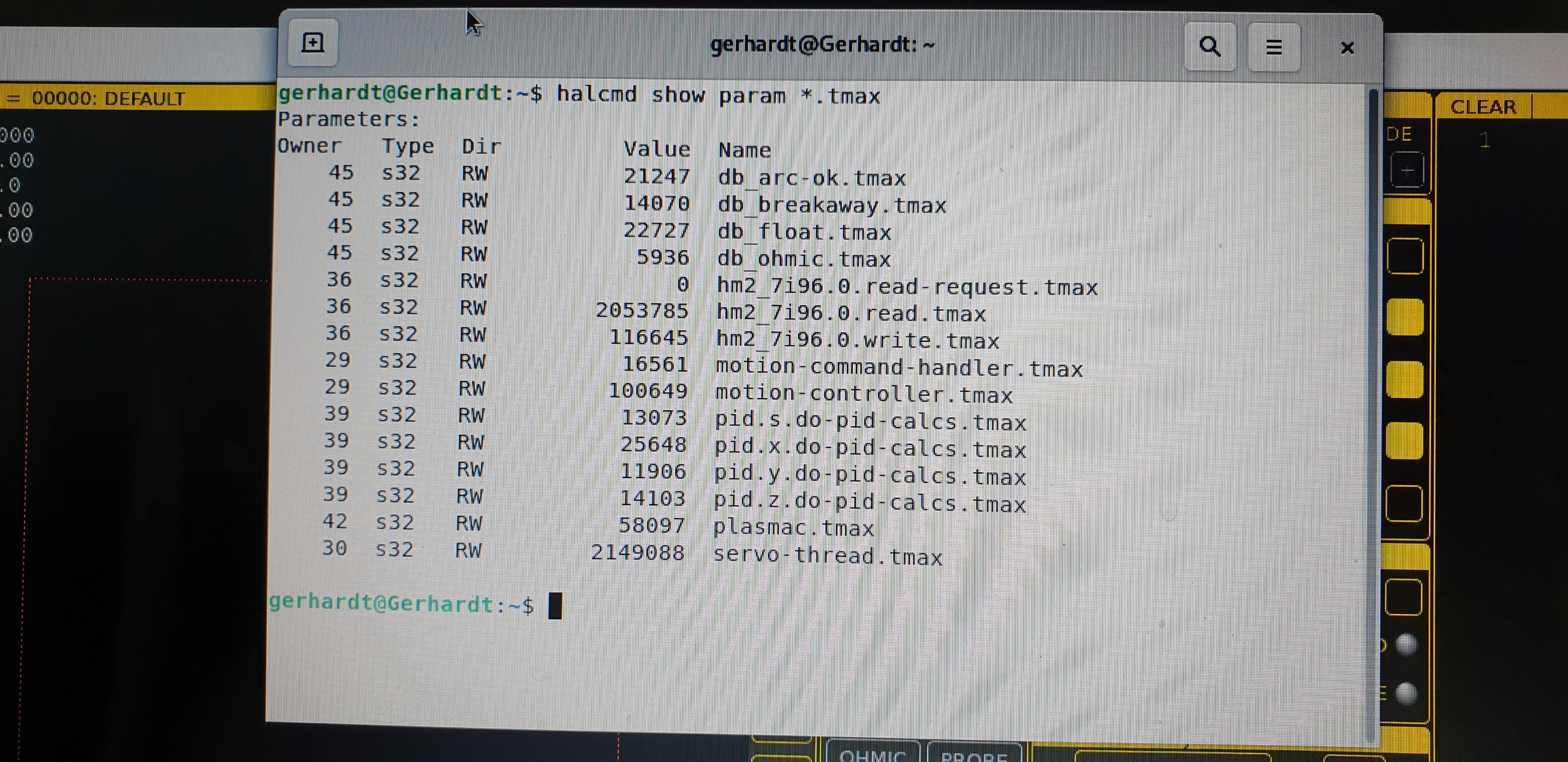

20 Mar 2022 18:20 #237838
5V Power was a small caged power supply connected to TB2. Would it be better to connect to the dedicated P3 connector?
Replied by rodw on topic 7i96 Error finishing read.
Thanks Peter, what is a bad ping limit do you think?Typically if you get the "Error finishing read" message you have
either lost contact with the 7I96 (power issues or the like)
or too many packets have timed out.

Its not the flash memory that has the problem, but rather the Ethernet EEPROM (93C46)No it has ST 25p16vp chips.
however as soon as I can I try to heat it up a little and try again, but I'm sure that once started it works regularly.
- Posts: 18115
- Thank you received: 5334
20 Mar 2022 22:42 #237861
Replied by PCW on topic 7i96 Error finishing read.
Its not likely a power issue unless running on a somewhat sketchy supply like
a USB cable.
I would want tun run the servo thread at about 2X the largest servo thread tmax
(converted to ns)
a USB cable.
(converted to ns)

24 Mar 2022 13:33 #238219
That is the correct chip, its just that MicroChip parts are unreliable
at low temperatures. ST M93C46WNM6TP chips have been 100% reliable
at -40 to +85C
at -40 to +85C

25 Mar 2022 07:20 #238305
Is this bad?
So we got this. I'm not sure what CPU clocks is on an i5Typically if you get the "Error finishing read" message you have
To check for timed out packets, look at the tmax values:
halcmd show param *.tmax
These are in units of CPU clocks
Is this bad?
