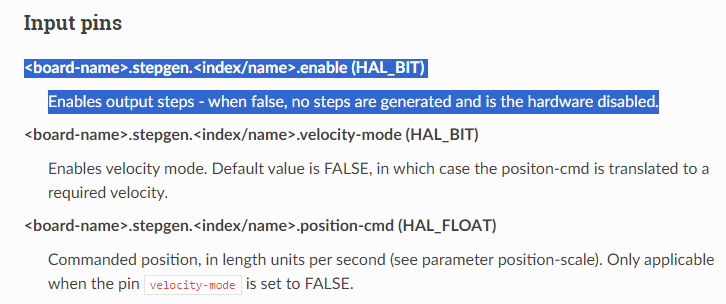

But the problem is that the board generates steps even though the value of the <board-name>.stepgen.<index/name>.enable pin is zero.

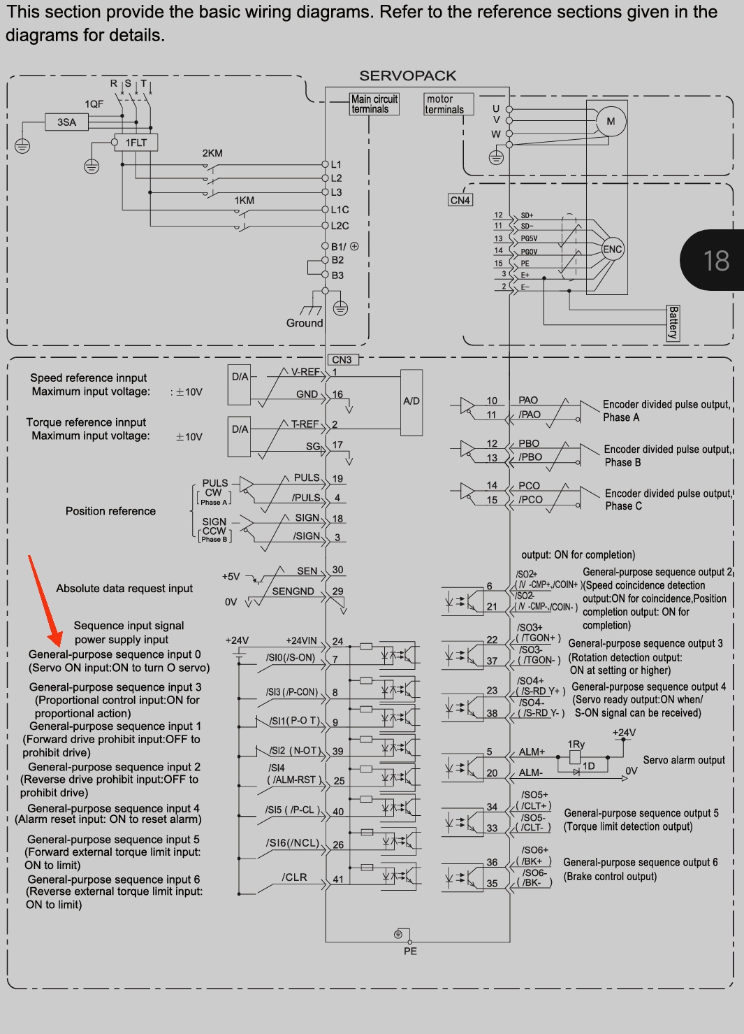

You may have a problem with input isolated signals - not good for a "noisy" environment. The 5-axis Chinese controller uses the same simplified scheme. What drivers are you using? Do you have movement at first power on the control board? Why are you ignoring the enabling signal?

I use a servo motor
What do you mean by enabling signal?
How do I connect it?
Even if I disable the motors, the position of the axes changes
I don't want the position of the axis to change every time I close the software or press the power button or e stop

It is normal for the position to change when you close the program. That's why we have homing or motors with an absolute multi-turn encoder so that linuxcnc can know the new position. It may be only a few microns, but the position is changing. this is the enabling signal on my drivers.
If the signal is missing the motor will not move.

Yes, your answer is logical.
But according to what is in the litexcnc docs
I noticed that this problem does not exist in speed mode
So putting the board in speed mode when I press the estop button solved the problem
