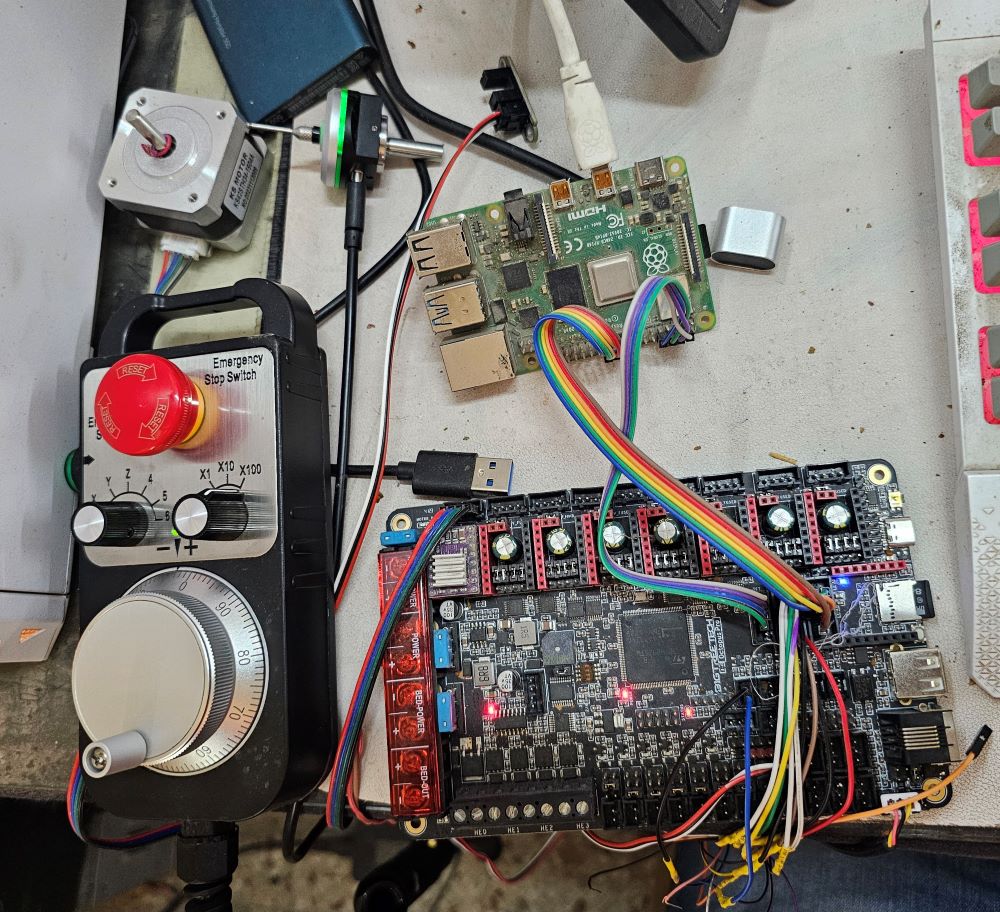

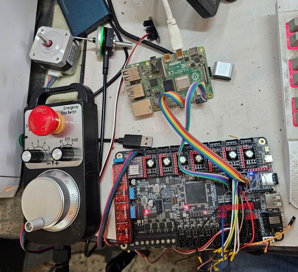

My Testing Setup.
- amanker

- amanker
- Posts: 119
04 Jun 2024 04:58 - 04 Jun 2024 07:02 #302293
by amanker
Replied by amanker on topic Need help in choosing controller board from small honby cnc.
I have explained everything in last post. With update list.
1. Estop working. (Made mistake of defining as "estop pin")
2. Encoder Working. ( Used conv_float_s32 function)
3. PRU_Frequency = 12000. Working good with speed of upto 2400mm/min.
4. Jog scale slow. Its about jog and axis selector switch. ( I found its a problem of board pin compatibility issue. May be those pins of EXP1 has some interference and not suitable for inputs) So I changed to inputs to elsewhere and problem resolved. Pins of EXP1 was giving problem. I tried pins of BL_touch. That also had delay in input switching. So I changed location of pins and issue resolved.
Problem... ""setp encoder.0.position-scale 400.0"" if I change this value to anything else then also it changes nothing. Per click of encoder value is always same. I tried 100-2400 value.
If you have some time please have look at my previous post with updates.
I have attached PIC of new pin location.
