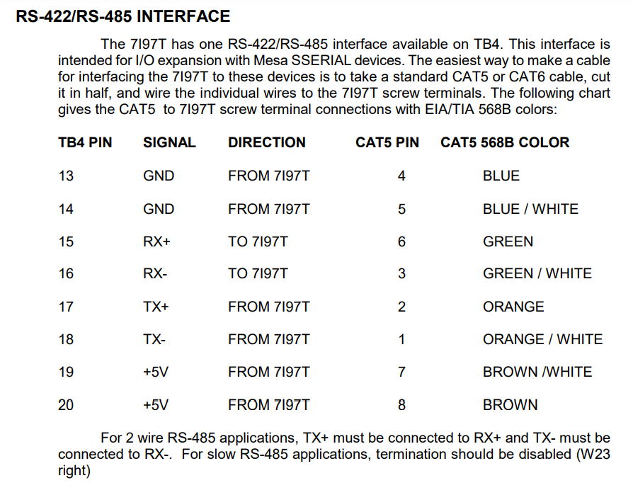

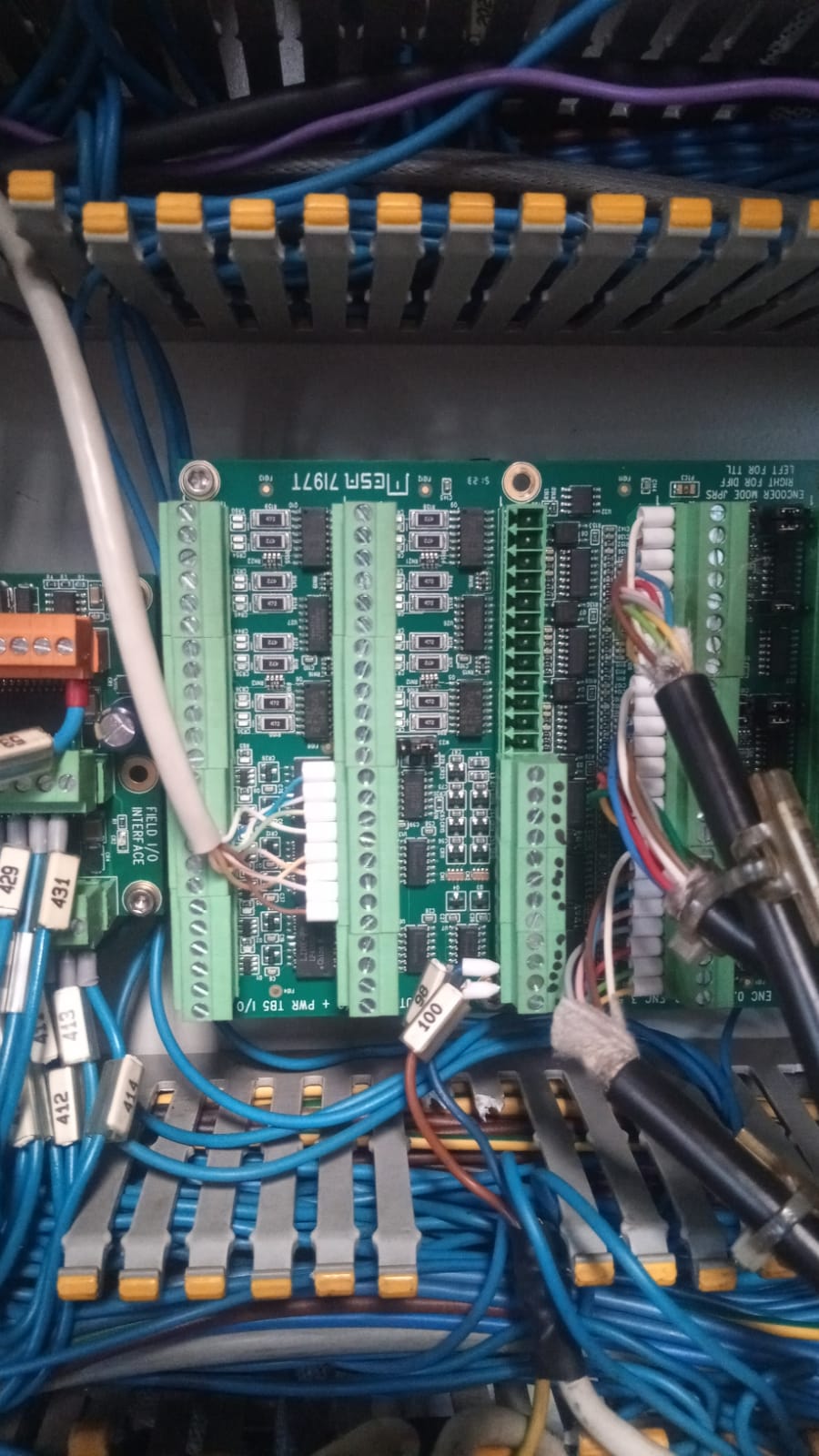

Hello,
my Mesa cards for the LCNC retrofit just arrived. I'm using 7i97t as the main card which is connected to the pc with ethernet. After some trouble updating Mesaflash i got that connected to the PC fine and the pins already work (in Hal show with an MPG encoder).
For the hal file I wanted to get a starting point by follwoing the Pncconf wizard and then editing the file as needed. The pncconf however has no infos on the 7i97t and I need to use the discovery function. THis also works and the card is detected. All seems well and I can even configure the Pins on my 7i84d which is connected through sserial to the 7i97t with a chopped ethernet cable connected as per 7i97t's instructions. When I start LinuxCNC with this config however, I get an error that a pin on the 7i84 is missing. If I don't configure the pins on 7i84d in Pncconf LCNC will launch but halshow won't let me see the I/Os on the 7i84d, only 7i97t.

Replied by PCW on topic 7i97t with 7i84d connection problem
try
mesaflash --addr 10.10.10.10 --device=ETHER --sserial
Note that you need to set the pwmgen to offset mode,
and for the 7I97T, use a 75 KHz PWM frequency with
dither enabled.
