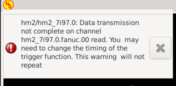

In addition to the two polarities that need to be right
(TX to REQ and RX to data) The DPLL needs to be setup to
start the transfer _before_ LinuxCNC reads the data
I'll try and dig up a sample FANUC hal file Monday

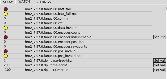

Thanks, I have experimented with the polarity of the data and request lines with no changes. Here's where I left off in the .hal based on what I could find here on the forum. I think I have added the initialization of DPLL but not sure about setting the timer.
Thanks!

You need to also set the FANUC interface timer to timer you have setup
(like timer 1) I don't know the name of the pin off hand but listing
all the fanuc pins should find it. Do you have a oscilloscope available?
With the AA64 setup you should get a 8 usec request pulse (+ to REQ+ and - to REQ-)
at the servo thread rate, The encoder should respond with 77 bits of data on the +/-
DATA lines
Note that the default AA64 setup is for a 64K count/turn encoder so wont be right
but should show some data. The correct setup for your 1m count/turn encoder
would need the appropriate setup string
DATA lines

Ah yes I see it now. I have assigned it to a timer, now I'm seeing the 8us request pulse on the scope at 3 volts (is that correct?). No response from the encoder yet and I'm getting this error, I'll have to check the wiring:
Here's where I made it to with the .hal thus far for those who may be on a similar path:
