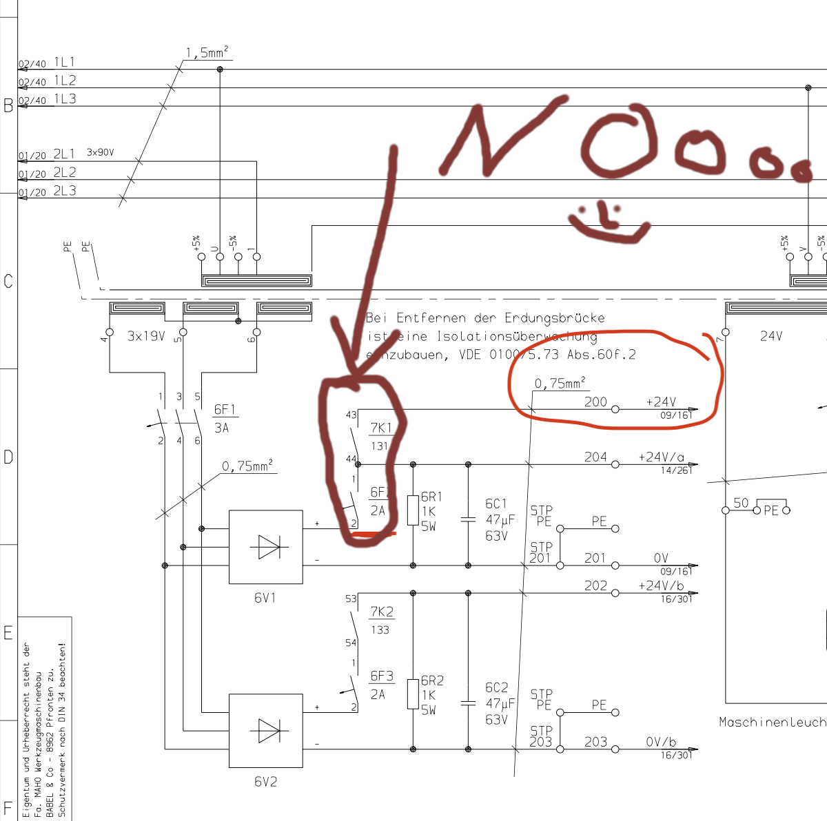

Replied by tommylight on topic Blown 7i84
If that is actually the line powering the Mesa boards, I have made an artistic representation of the issue, see attached:
As mentioned many times here on the forum by several members, do NOT cut on/off the DC side of power to Mesa boards... and stepper/servo drives.
I will leave it to PCW to explain why as i might make a mess.

Right now, the 7k1-131 relay contact is disconnecting the 24VDC supply to mesa 7i84 board which is no, no as indicated by Tommylight. I can suggest you jumper 7k1=131 contact and replace the single pole relay 7k1-131 with a 3-pole relay to disconnect the 3 phase AC side of 6V1 power rectifier. let me know, if this info does not make sense, I can draw a diagiagram.

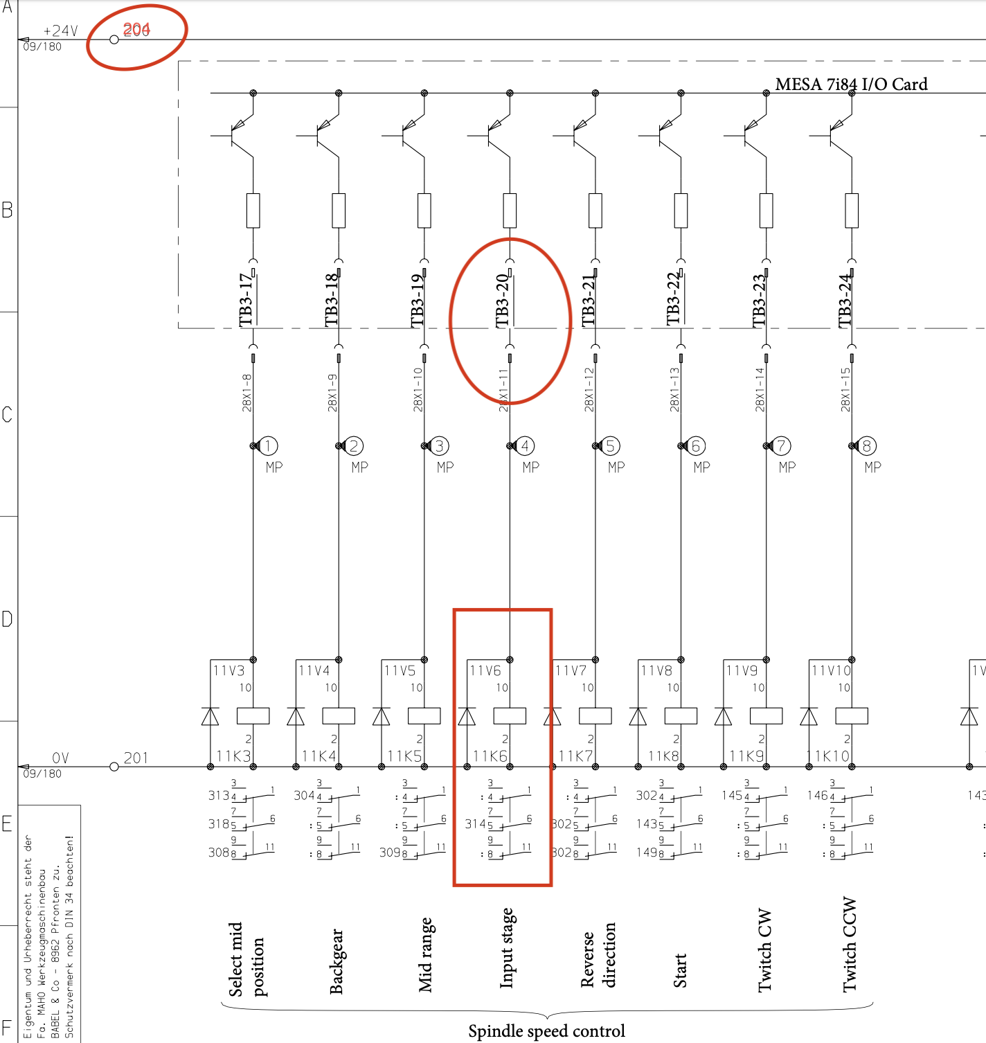

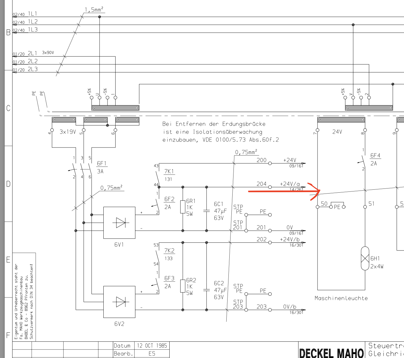

I created confusion there. The 784 is not powered by the 200 rail (which is switched on and off with Machine start / Estop), it is wired to the 204 rail, which is on constantly when the machine main switch is on.

This is the correct wiring... I always had it wired like that, so the 7i77 and 7i84 are always powered.
When I flip the mains switch, I have 24.26V on rail 204 to ground (201).
I cut off the legs and then desoldered the remaining leg bits, removing the both NCV7608 chips. When I plug the 7i84 into the 7i77 and boot up (no field power connected) , I get a solid yellow LED on CR8, but that is all. None of the other LED's show any activity. LinuxCNC fails to load with a 7i84 pin unknown error.
Tommy, good idea to scope that 24V rail while switching some of the bigger relays, thanks. Since LinuxCNC faults out, I will need to work out how I can fake machine on and latched, to get the 200 rail powered as well, so be able to manual operate those relays with their test buttons.

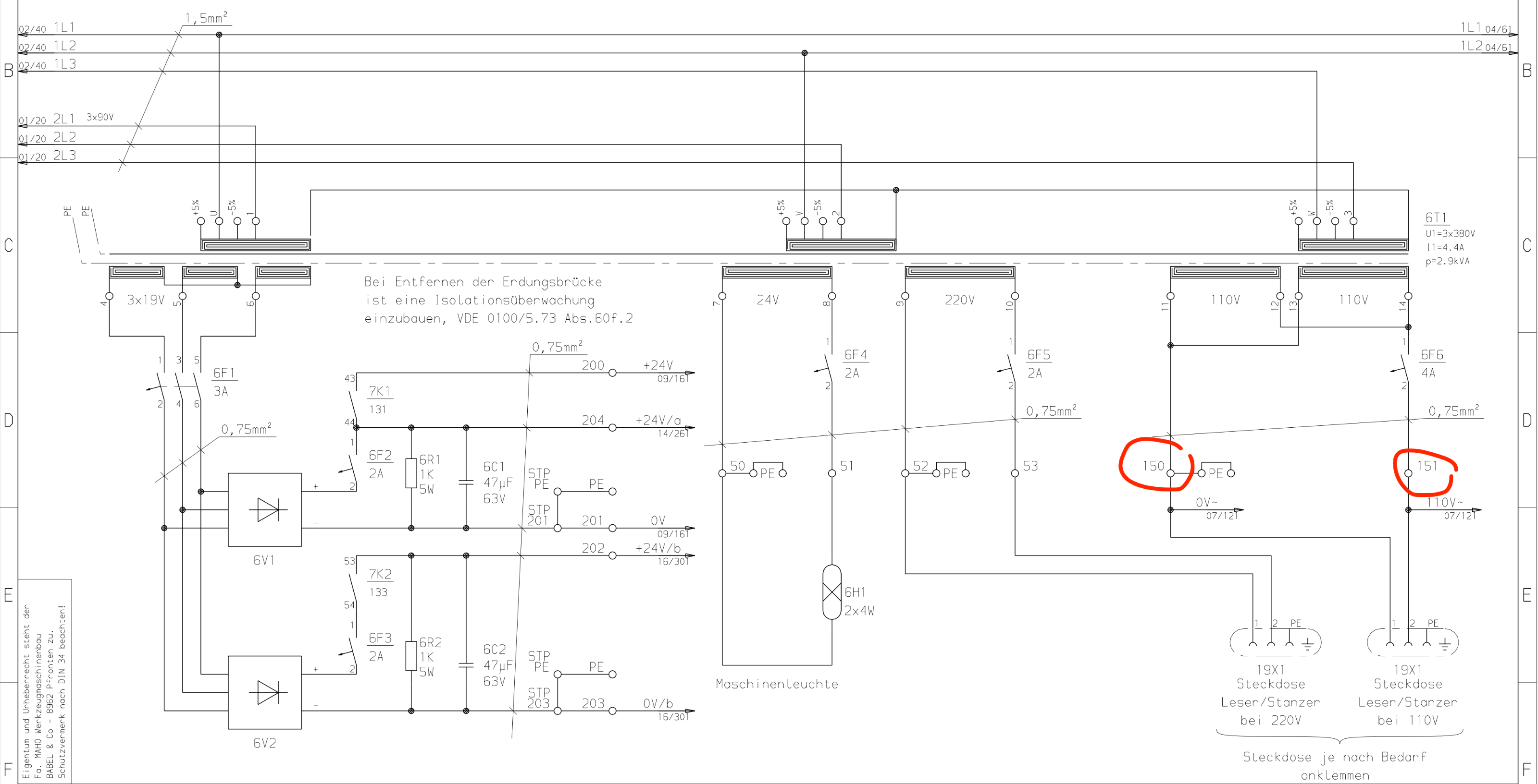

Okay, now I am getting inconsistent behavior. Yesterday, I switched on the machine, the PC booted, and I was able to check the 7i84 connected with it's 7i77, and also check the voltage of the 24V rail (204).

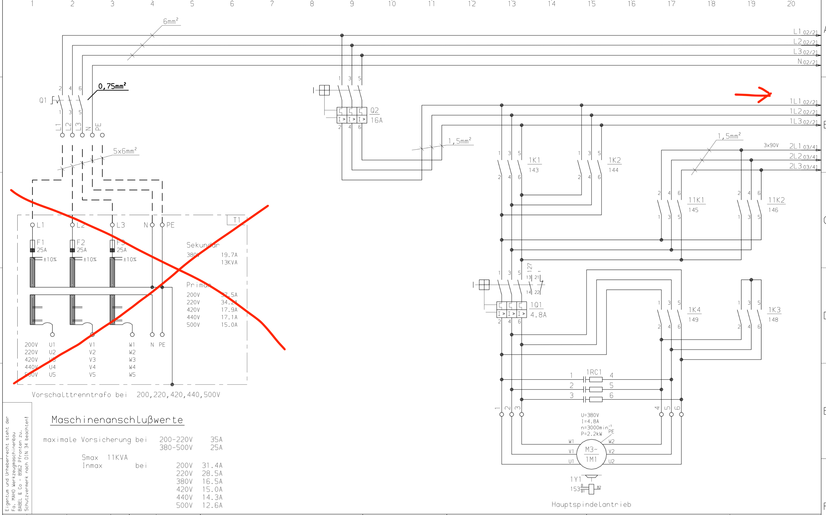

Today, I wanted to repeat that, but the PC gets no power. I receives 110VAC via pins 150 /151 from the same 3Ph transformer (6T1) which also powers the 24V DC rails. The 110VAC secondary is protected by fuse 6F6 , which has not tripped.
The primary of the that transformer is only protected by that main fuse/breaker Q2. I measured the output of Q2. Between L1/L2--> 400V , L1/L3 -->240V, L2/L3 --> 200V. WTF?
Shut down again, tripped the switch on Q2 to remove all loads, and measured on the input side of it. Same result... Between L1/L2--> 400V , L1/L3 -->240V, L2/L3 --> 200V.
Shut down again, pulled the socket from the wall and measured. The supply is normal. 400V phase to phase between all three. There is no isolation transformer. None of the fuses or breakers has tripped.
I am kind of confused what could be pulling down the voltage on those lines, unless I have an open circuit on one and the multimeter is just picking up tiny current induced into the lines like an antenna?
