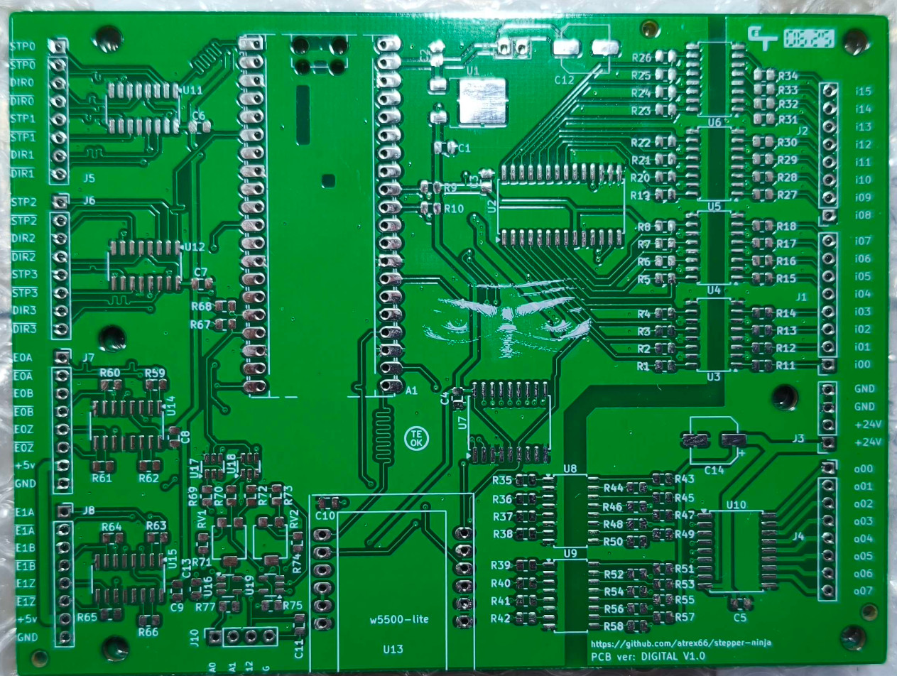

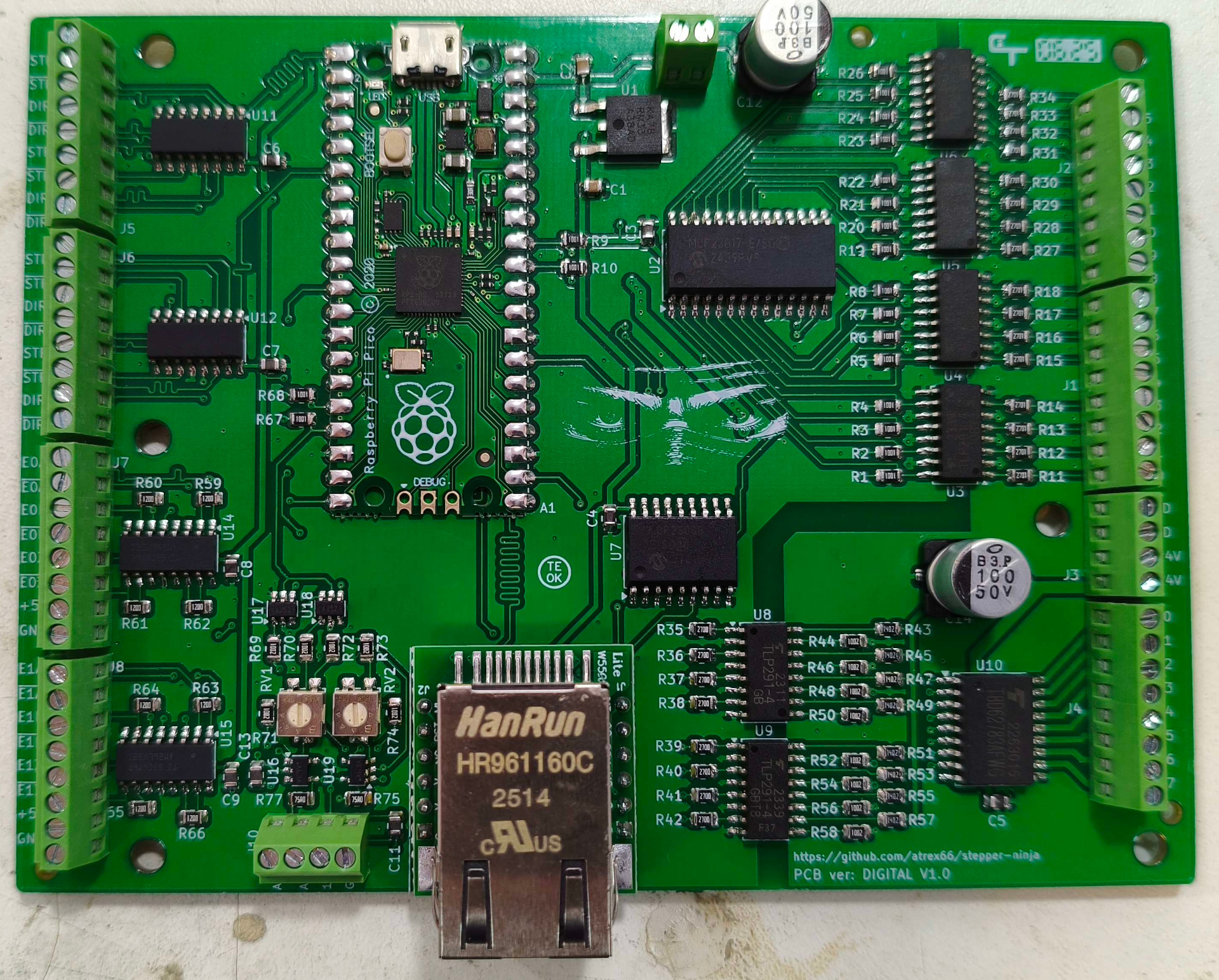

!Update!:
Removed the dedicated spindle encoder index pin, now all encoder channels are handling the index pulses. In the project configuration you can now use PIN numbers instead of GPIO numbers, dedicated chinese breakout board config files and picoBOB-DLX config file.
You can try it with the Test branch.
i would like to thank your contribution to the project with testing, time and resources to Pubcrawlr and Galetops.

25 Jun 2025 13:15 #330860
by atrex77
Replied by atrex77 on topic W5100S-EVB-PICO stepgenerator and encoder driver
Raspberry PI4 test version of the project is now online in the test branch (with docs how to connect), if you are interested try it, more info on the discord channel.
github.com/atrex66/stepper-ninja/tree/test
discord.gg/tKBEQGqw
discord.gg/tKBEQGqw

- atrex77
- Posts: 45
- Thank you received: 24
27 Jun 2025 19:41 #330934
by atrex77
The expansion board is "plan to sell it" but the prototypes is in making, so its need more time.
