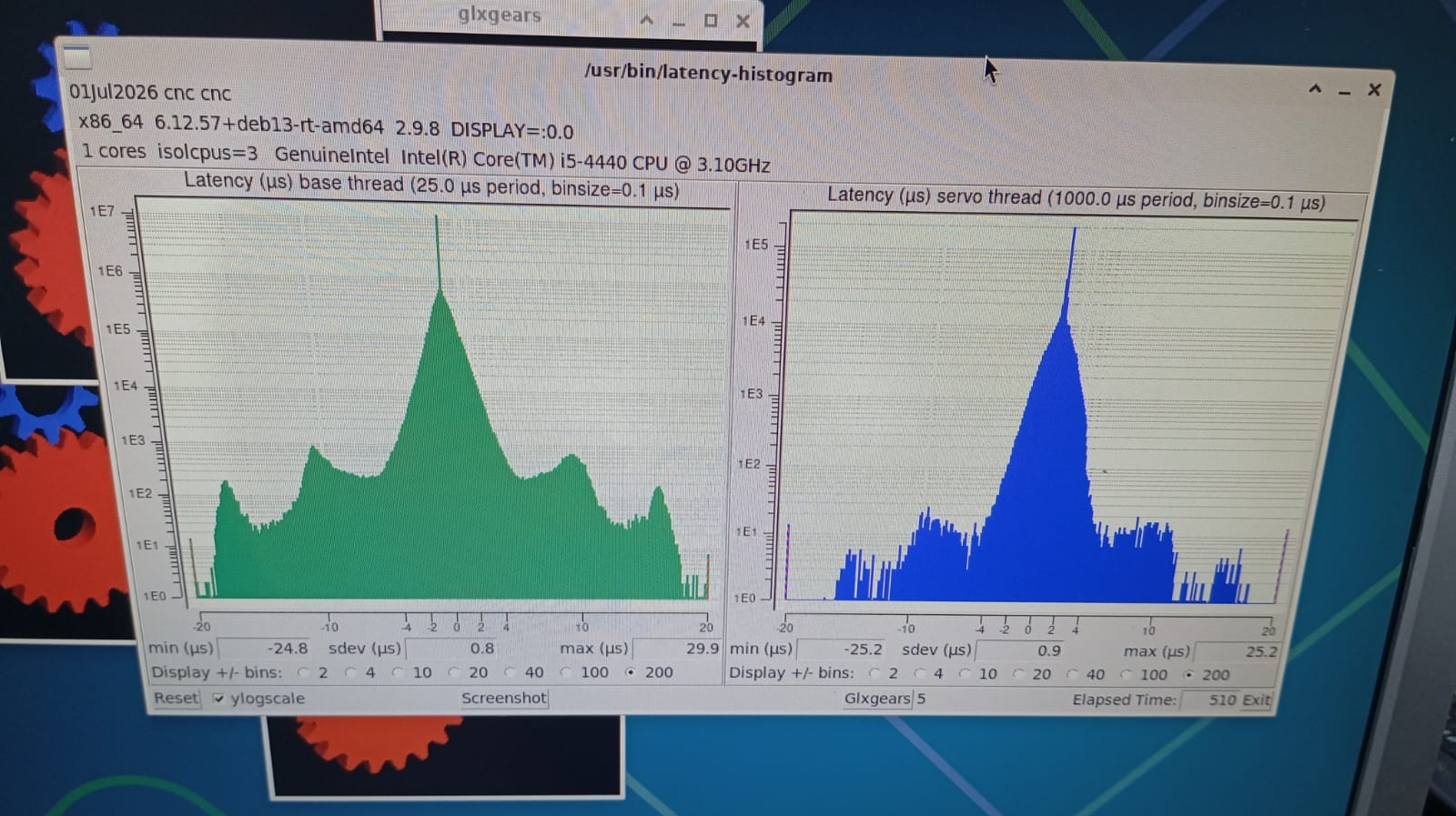

I've just finished installing the system, disabled all power-saving features (C-states, SpeedStep, etc.) in the BIOS, and isolated a CPU core using isolcpus.
Here are my latency test results while stressing the system with 4 instances of glxgears and a YouTube video playing in the background
Note: I am currently running this test using an old VGA monitor. I suspect the analog output/Xorg driver might be causing some minor latency spikes compared to using a pure digital connection, but I'm not entirely sure.
What do you think of these numbers? Are they good enough to move forward with my Mesa setup, and what should my next steps be?
Thanks in advance for your feedback!
- Posts: 12171
- Thank you received: 4153
02 Jul 2026 06:15 #347454
Replied by rodw on topic Retrofitting a 3-axis VMC with DC servos - guidance needed

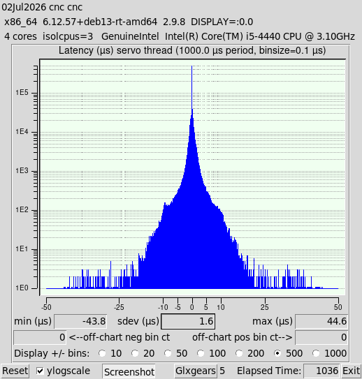

Looks fine but for mesa its better to run: latency-histogram --nobase --sbins 1000 --show to get rid of the base thread window which gets in the road. and can suppress results. Run that and reshare.

02 Jul 2026 20:10 #347465
by Japoo_Ness
Replied by Japoo_Ness on topic Retrofitting a 3-axis VMC with DC servos - guidance needed
- Posts: 22013
- Thank you received: 7493
02 Jul 2026 20:34 #347466
Replied by tommylight on topic Retrofitting a 3-axis VMC with DC servos - guidance needed
Looks OK, so test with the Mesa attached and a running config.
