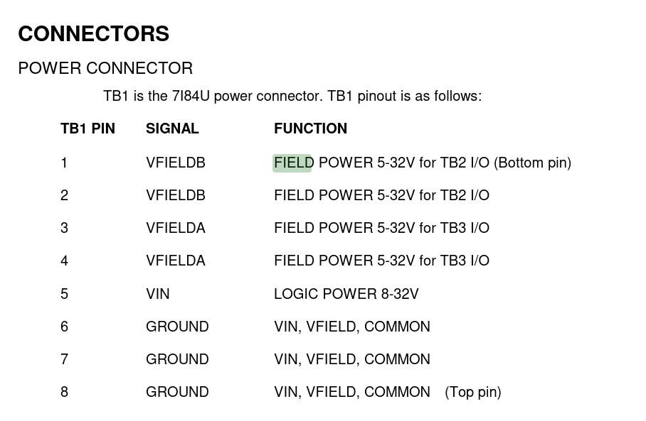

18 Jul 2026 18:53 #347828
by Japoo_Ness
Replied by Japoo_Ness on topic Retrofitting a 3-axis VMC with DC servos - guidance needed
I flash the 7i97t with the 7i97t_7i74d2.bin.
now i have a bit of a trouble cause i looking to connect the 7i84u, but the trouble is i can´t understand correctly if i need to supply 5v to the 7i84u or is it supply by the 7i74 or its switched by VIN (and its need to be 8 to 32V) right now im working with all the parts in the desktop and dont have a 24V line here. i need to supply the voltage to VIN or im passing somenthing by.
- Posts: 18120
- Thank you received: 5337
18 Jul 2026 21:03 #347830
Replied by PCW on topic Retrofitting a 3-axis VMC with DC servos - guidance needed
The 7I84U needs its own power supply.
You must supply VFIELDA and VFIELDB (Usually the same)
These set the output voltage and the input thresholds.
Normally VIN comes from VFIELDB (W1 LEFT=default)
VFIELDA and VFIELDB are supplied via the ORANGE connector (TB1)
on the 7I84U.
There is a small 5V supply needed for the 7I84Us isolated serial interface
This comes from the RJ-45 connector, and in turn from either the 7I74 or
7I97TA.
on the 7I84U.
7I97TA.
