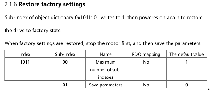

Regarding a factory reset, I'm not sure how to apply it. See attached screenshot:

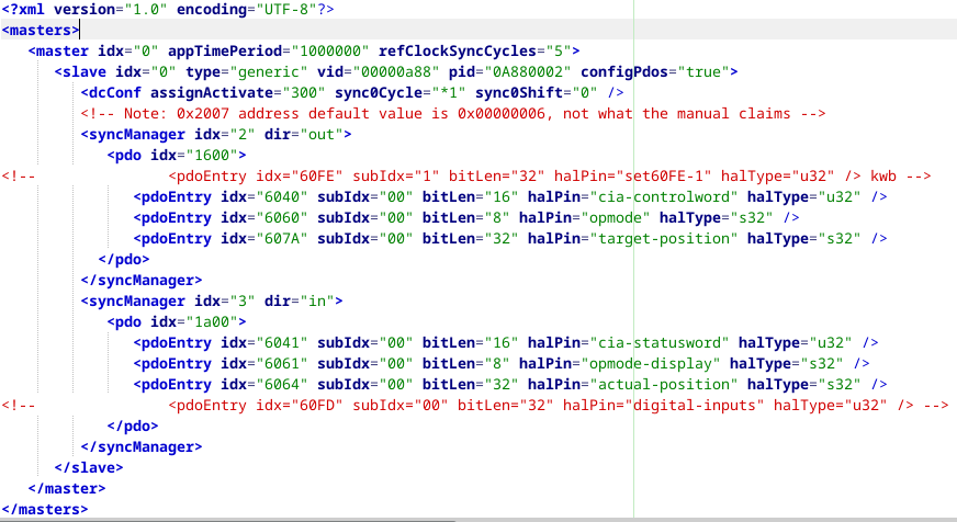

FWIW, here are the files in question as of now, with the requested lines commented out or removed. I must still be missing something - or the manual leaves out critical information...
Last edit: 27 Sep 2025 17:52 by kb58.
- Hakan
- Posts: 1317
- Thank you received: 454
28 Sep 2025 08:23 - 28 Sep 2025 09:54 #335503
by Hakan
Replied by Hakan on topic (Solved) Initialization code for a rintelligent ECT60 fails when run on an ECR60
Do you have the errors from syslog?
I would like to see the 60fe and 60fd sdos and pdos out specifically and only the 6 mentioned PDOs in there.

The developer of my code intended it to be loaded into an ECT60 (closed loop) driver and configured it for an open loop stepper. Given the above statement (if true), it's odd that he sets up register 2001 but not register 2020.
<sdoConfig idx="2001" subIdx="0"> <!-- segmentation/resolution for open loop -->
<sdoDataRaw data="40 9C" /> <!-- 40000 counts/rev -->
"For fun", I tried adding this back into ethercat-config.xml, but the error condition remains.
I looked into downloading the package onto my Windows PC but it's unclear which download to use. They have quite a few and the link just goes to their front page, not to a specific download screen. To be honest, I don't hold out much hope that dropping it in place of my config file will make it work, but as you alluded to, perhaps it contains something the manual left out. Anyway, their comment above makes me wonder all the more whether there is key documentation missing from the User Manual regarding differences between the ECR and ECT drivers... sigh.
