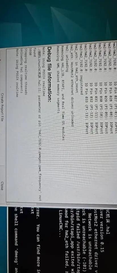

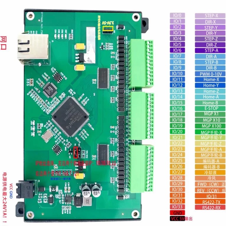

Hi.I bought a mesa card from aliexpress to power my lathe.The board works with 10.10.10.10 it pings and output that gives me with command:sudo mesaflash --device 7i92 --addr 10.10.10.10 --readhmid
The problem is i dont know how configure linuxcnc. I have the doc from the seller uploadnow.io/f/9v0gkpb
This is my first time with mesa card.

- Posts: 18104
- Thank you received: 5328
22 Nov 2025 15:46 #338975
Replied by PCW on topic Chinese Mesa 7I92 from aliexpress NEW
The basic issue is that the current firmware is just GPIO (no Step/Dir hardware etc)
There could be a couple reasons for this:
1. The wrong firmware is installed,
2. The card had corrupted firmware so has loaded the fallback firmware (which is just GPIO)
Did the card vendor supply a firmware file?, it does not look like any standard 7I92 firmware to me
If they did supply firmware, I would try re-writing it with:
mesaflash --device 7i92 --addr 10.10.10.10 --write vendor_supplied_firmware_file_name.bit --reload

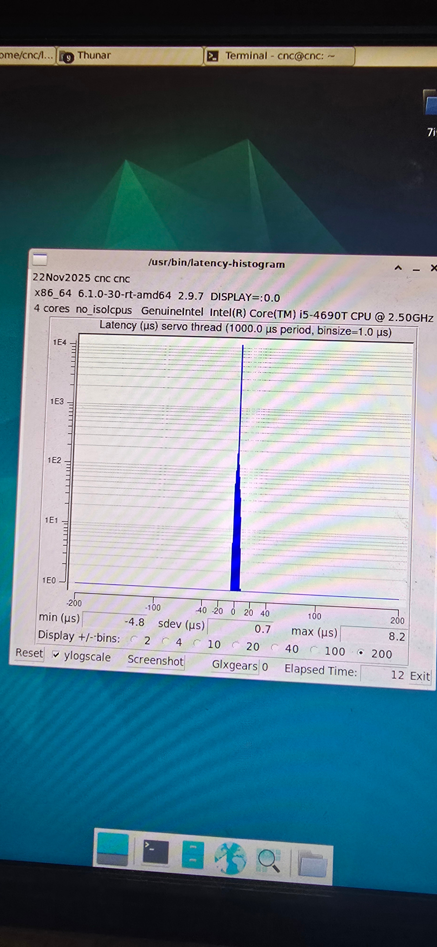

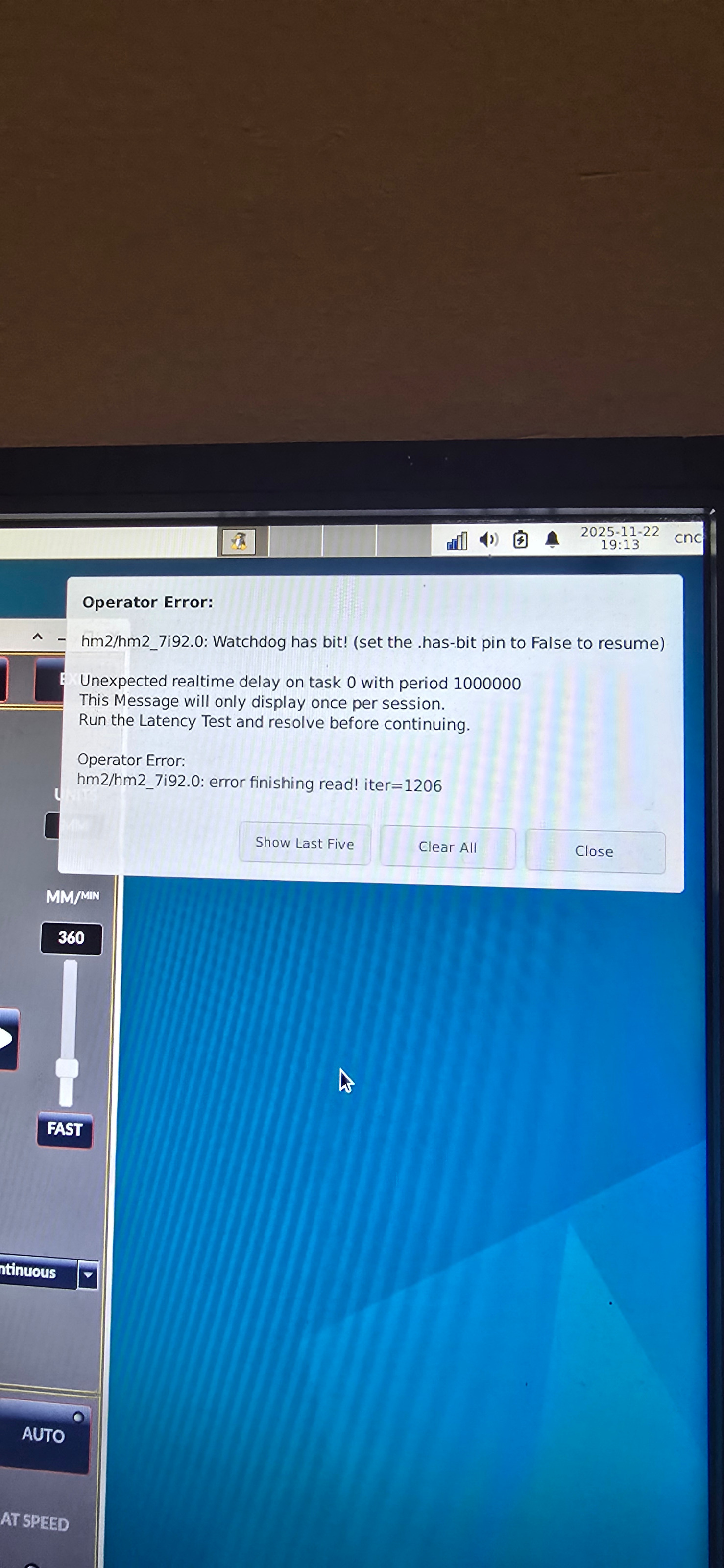

The next problem is when i start linuxcnc it gave me an error: Watchdog has bit!
from the post "Mesa 7i97 Watchdog has bit!" i did latency-histogram --nobase --sbinsize 1000 and its like this:
btw the pc is minipc Fujitsu Esprimo Q920
the firmware that the seller gave me was 7i92_G540x2D_custom.bit
I did upload it but it gave an error when i started linuxcnc
I install Mesa Configuration Tools and download a firmware from there the 7i92_G540x2D without the custom part and it works.
For now i just tested the pin output

- Posts: 18104
22 Nov 2025 17:47 #338986

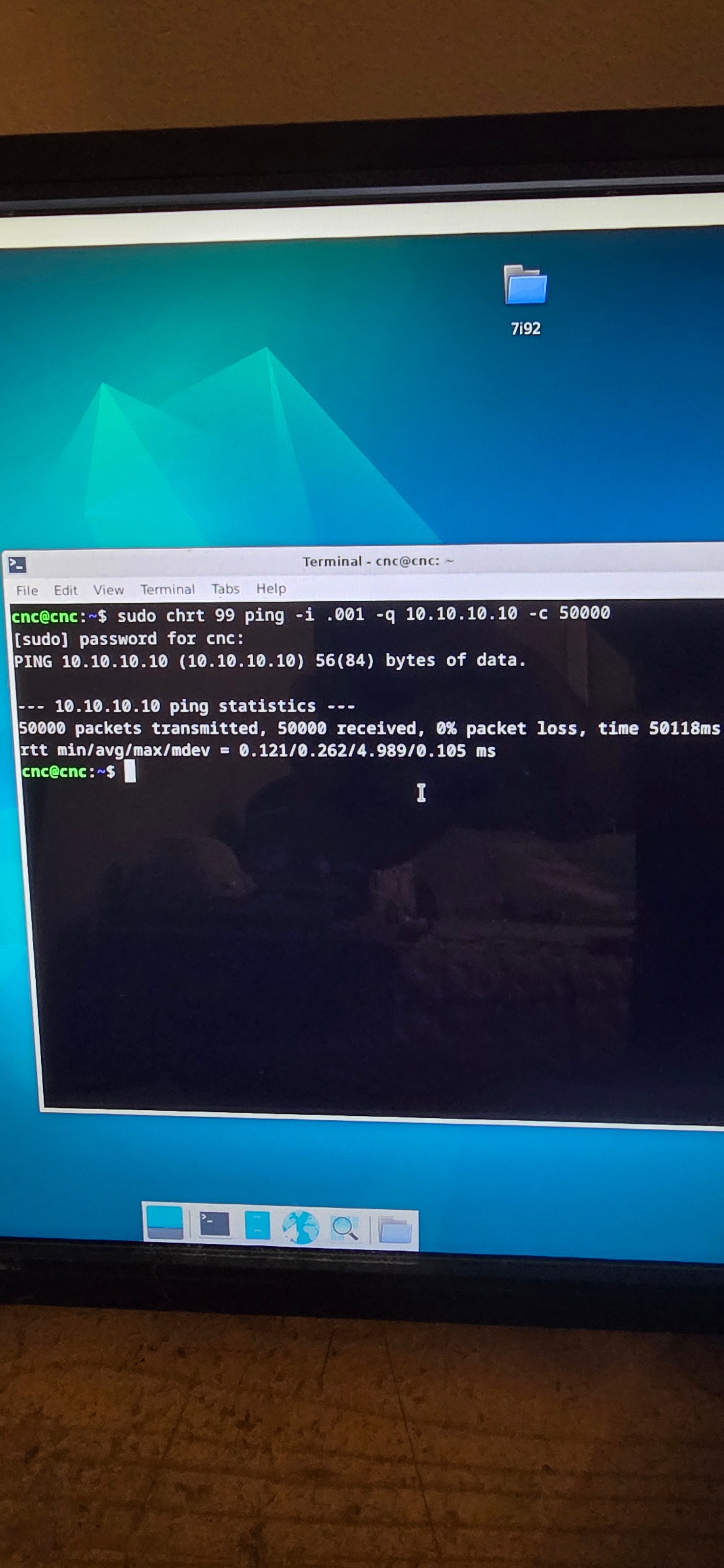

The watchdog error is a sign of network latency issues.
I would try:
sudo chrt 99 ping -i .001 -q-c 60000 10.10.10.10
which should run for 1 minute and then print timing statistics
to see if this is the issue.
I would try:

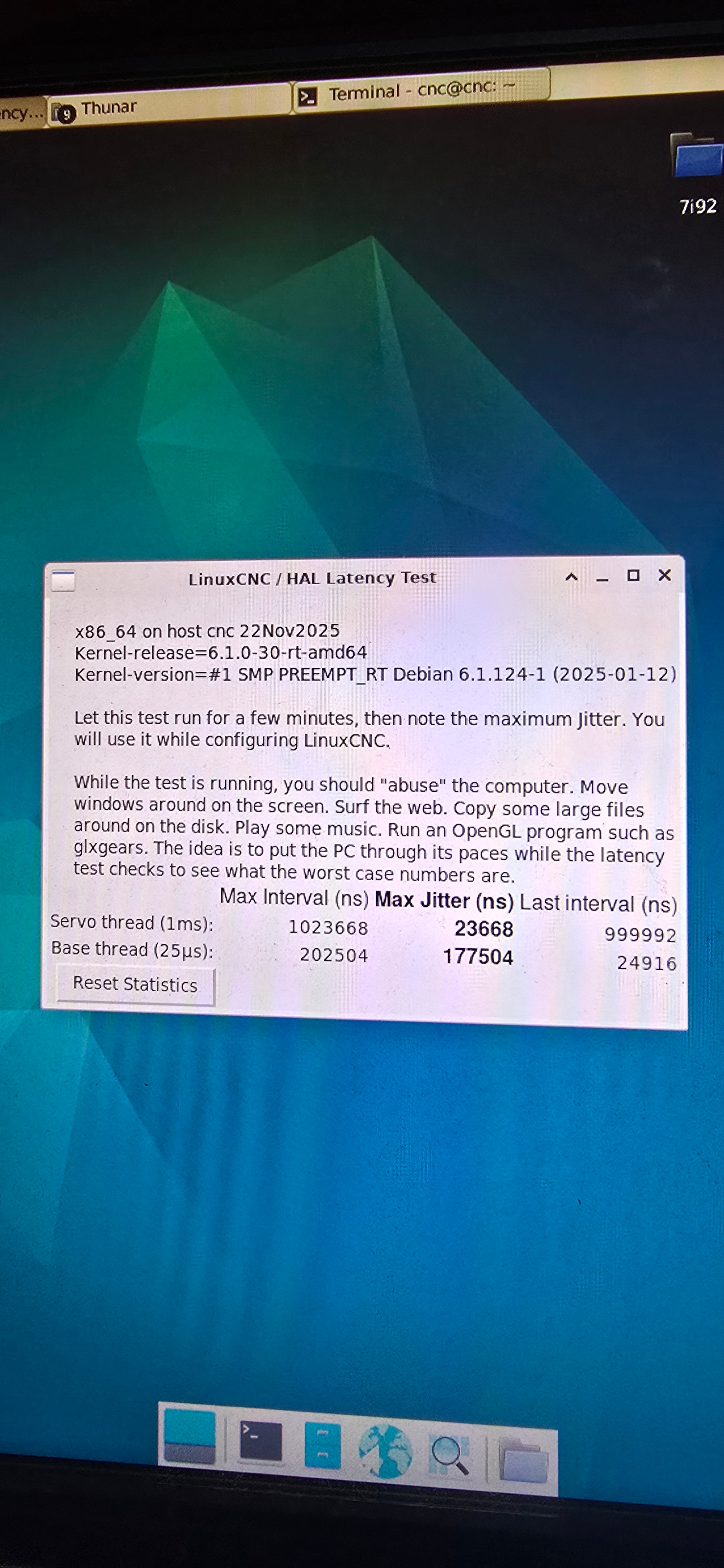

- Sekai
- Posts: 34
22 Nov 2025 19:08 #338994
by Sekai
Replied by Sekai on topic Chinese Mesa 7I92 from aliexpress NEW
- Posts: 21984
- Thank you received: 7483
22 Nov 2025 23:37 #339006
Replied by tommylight on topic Chinese Mesa 7I92 from aliexpress NEW
Nope, the network driver needs to be changed, installing the DKMS version of the Realtek drives should fix it.
Give this a try:
Give this a try:
sudo apt-get install r8168-dkmsPlease Log in or Create an account to join the conversation.
- Sekai
- Posts: 34
23 Nov 2025 05:35 - 23 Nov 2025 05:42 #339027
by Sekai
Last edit: 23 Nov 2025 05:42 by Sekai.

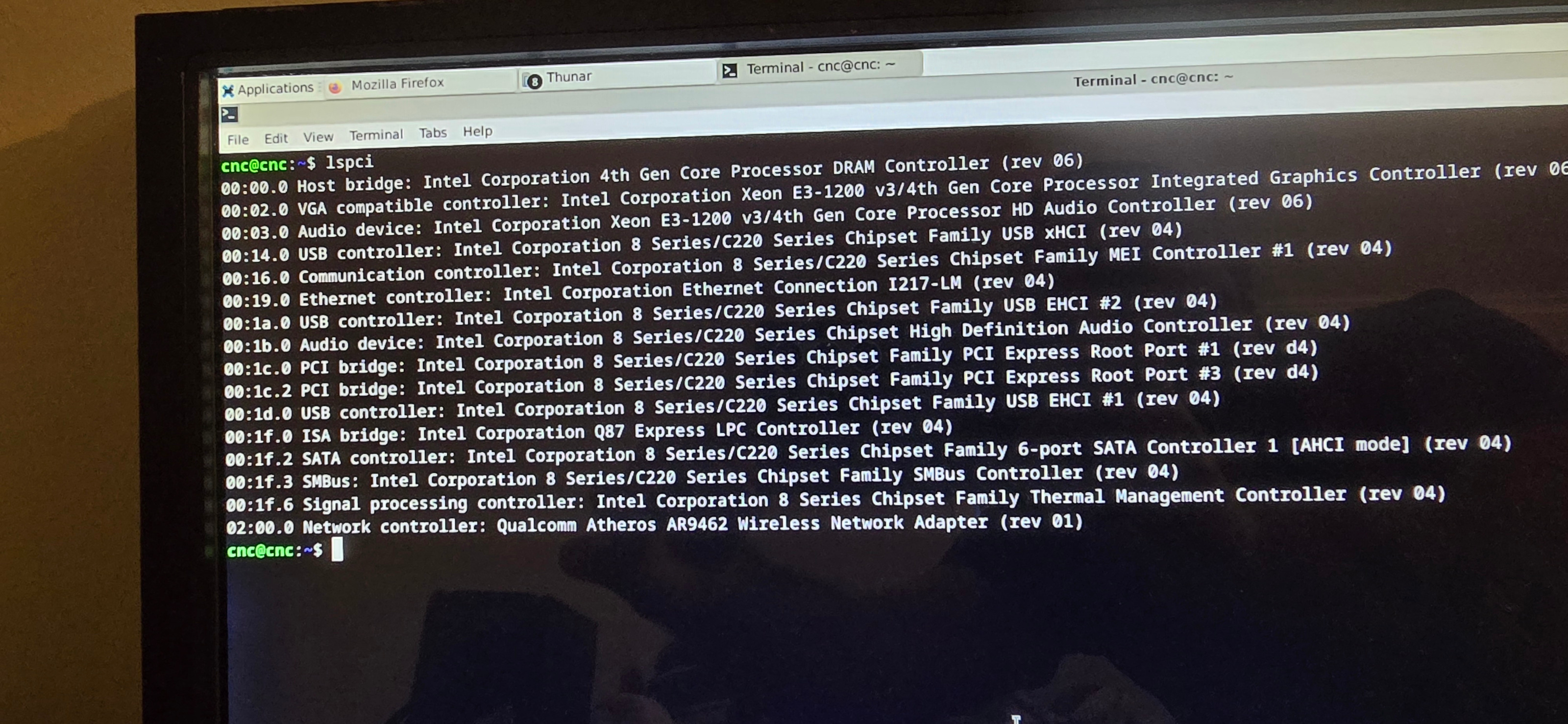

- Posts: 12156
- Thank you received: 4149
23 Nov 2025 05:56 #339028
Replied by rodw on topic Chinese Mesa 7I92 from aliexpress NEW
With Intel, be sure to set up the coalescing settings. Type man hm2_eth and follow the instructionsI dont think i have a realtek ethernet
Its a intel i217LM and i have already the latest kernel e1000e
