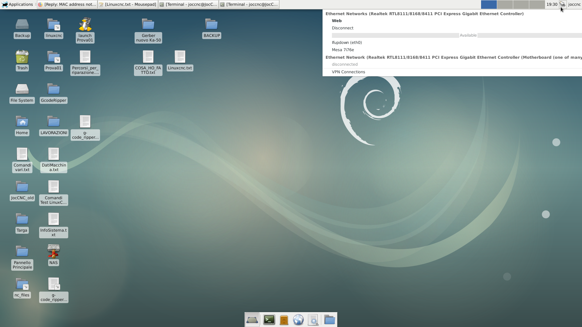

27 Jan 2026 18:32 #342013
by Jocman
Replied by Jocman on topic MAC address not retrieved (after 2 years stop)
As I've 2 lan cards (the onboard and a second PCI board), I tried to launchwhen connected to both, and this is what I get:
connected to Mesa (onboard card):and pinging my router:
connected to WEB:and pinging my router:
I've attached a screenshot of my desktop showing the lan connection window
ip aconnected to Mesa (onboard card):

27 Jan 2026 22:19 #342033
Replied by tommylight on topic MAC address not retrieved (after 2 years stop)
You have setup 2 networks on the same 1'st physical network card, the 2'nd network card has nothing set.
WHY????
That will not work, so start new and use this:
forum.linuxcnc.org/27-driver-boards/3559...ethernet-mesa-boards
WHY????
