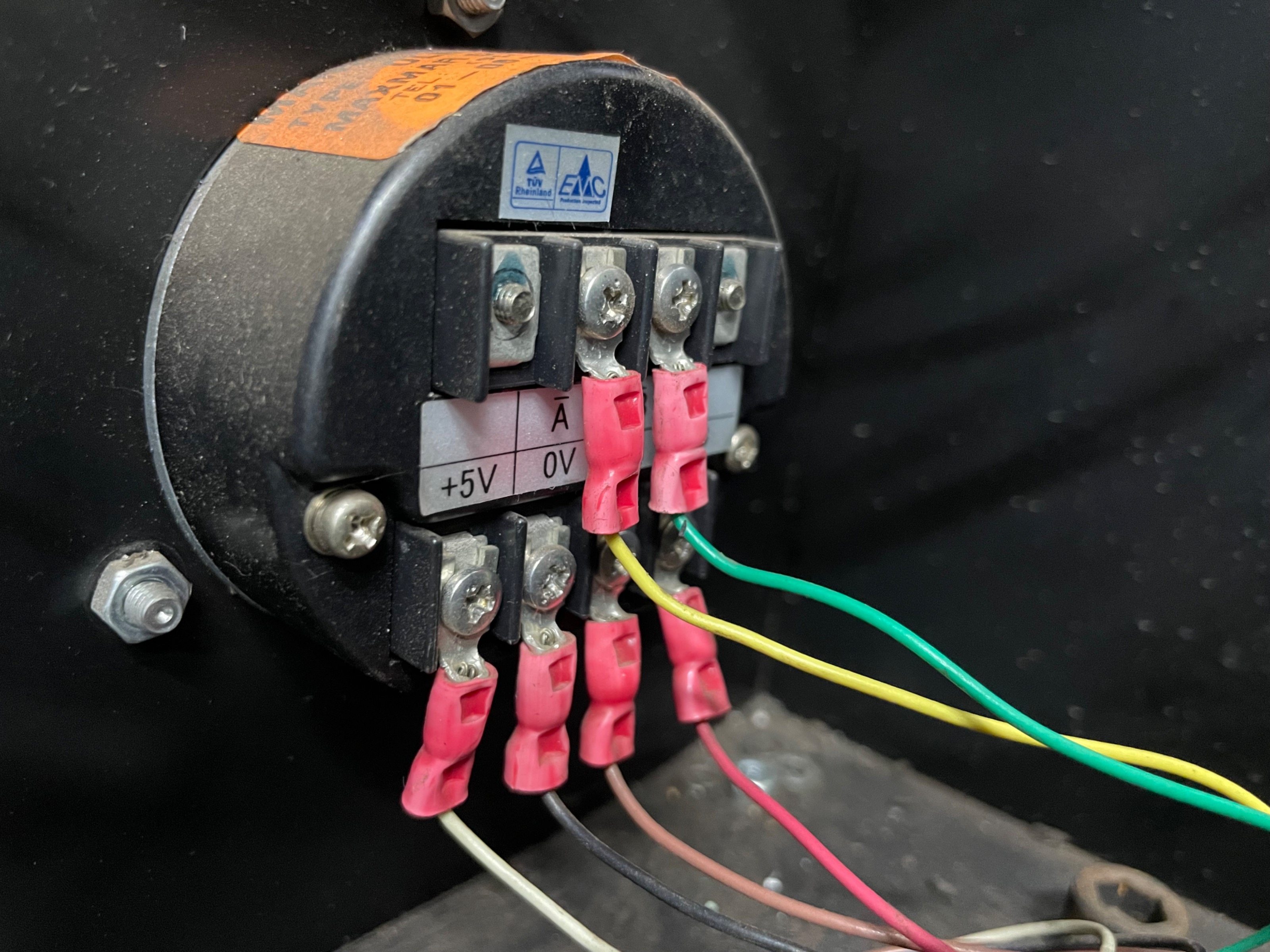

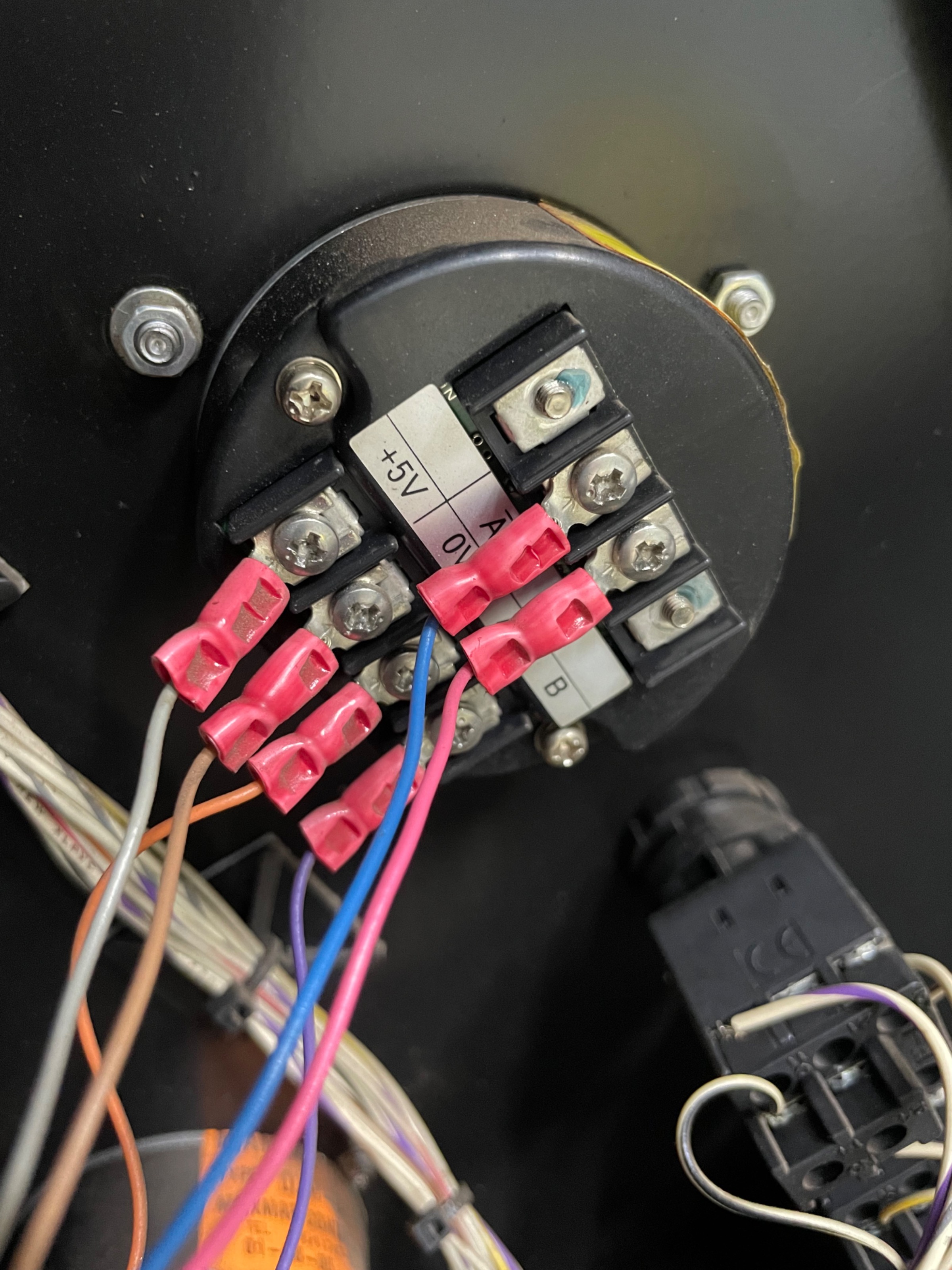

Hi everybody! I am struggling to get the MPGs working with my 7i77. These are differential encoders, and are wired into TB4 (z axis and x axis). Whenever I go to launch LinuxCNC, the computer crashes without warning like something is shorting or there is some hardware problem.
When I unplug TB4, LinuxCNC will at least launch.
Are there any jumpers i need to move around on the 7i77? The MPG wheels are supposed to run 5vdc…

I would check the 7I77s 5V supply, my guess is that it droops
when you connect the MPGs, either from a wiring error or
too much current.
Does the 7I77 have 5V power supplied to TB1?
too much current.

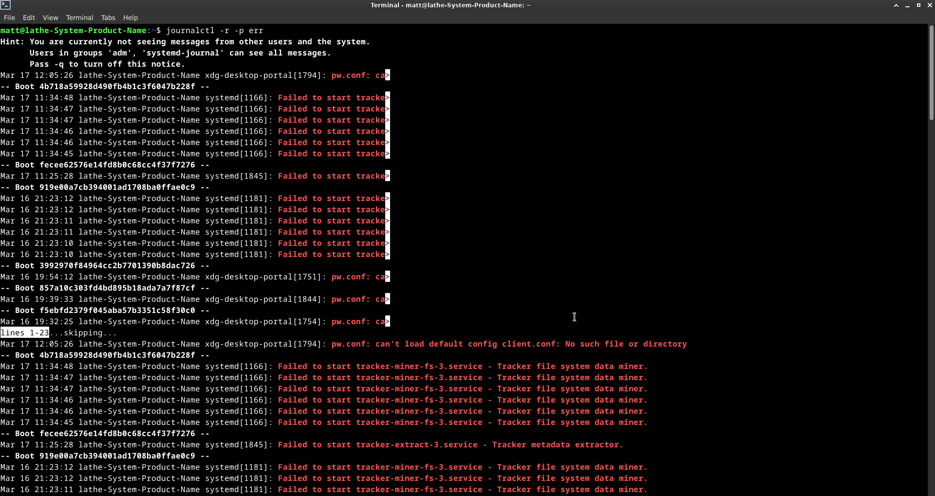

I am using 5V from the 6i25 card. I had also wondered if there was a wiring error somewhere, but I tested the MPGs with a multimeter found no errors. I double checked the wiring and everything is in the right place....so, this time I unplugged the terminal blocks and -you guessed it- LinuxCNC still crashes. It must have been a sad coincidence that when I plugged in the MPGs things went bad.I am using a Linux 6.1.0 -19-rt-amd64 kernel, which I just updated. That didn't fix the crash issues.I can open and play with everything just fine if I use a simulated machine, just completely crashes as soon as I try a non-virtual machine.I cant make heads or tails of the crash log.
Last edit: 7 months 2 weeks ago by grossm5000. Reason: added crash log

If you have the encoder power wires reversed, that will for sure make the voltage drop and cause the failure.I would check the 7I77s 5V supply, my guess is that it droops
too much current.
But, some parallel cables have so thin wires inside that might also be the reason for the failure.
My advice:
-set Mesa boards for each to have it's own power supply
-find a good quality USB cable and cut the USB-whatever connector leaving only USB-A side and the wire, wire it to Mesa 7i77 as the power supply
-do NOT do this before checking the wiring and making sure it is correct.

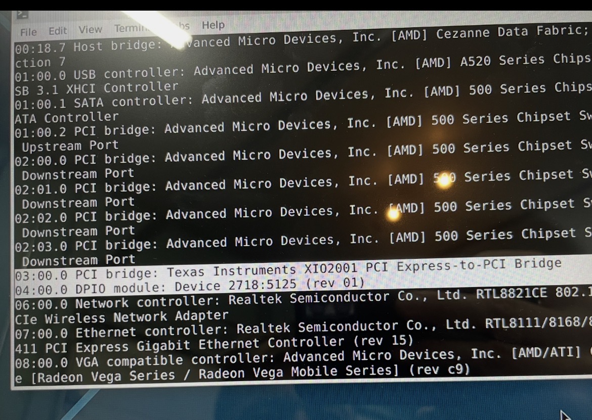

I started to wonder if my 6i25 was dead. I don’t see any LEDs light up on it when I power up the PC. I also can’t find it with lspci
i would also like to point out that I removed the terminal blocks for ALL the encoders, drivers on the previously mentioned TB…so it can’t be shorted or drawing too much power because everything is disconnected!

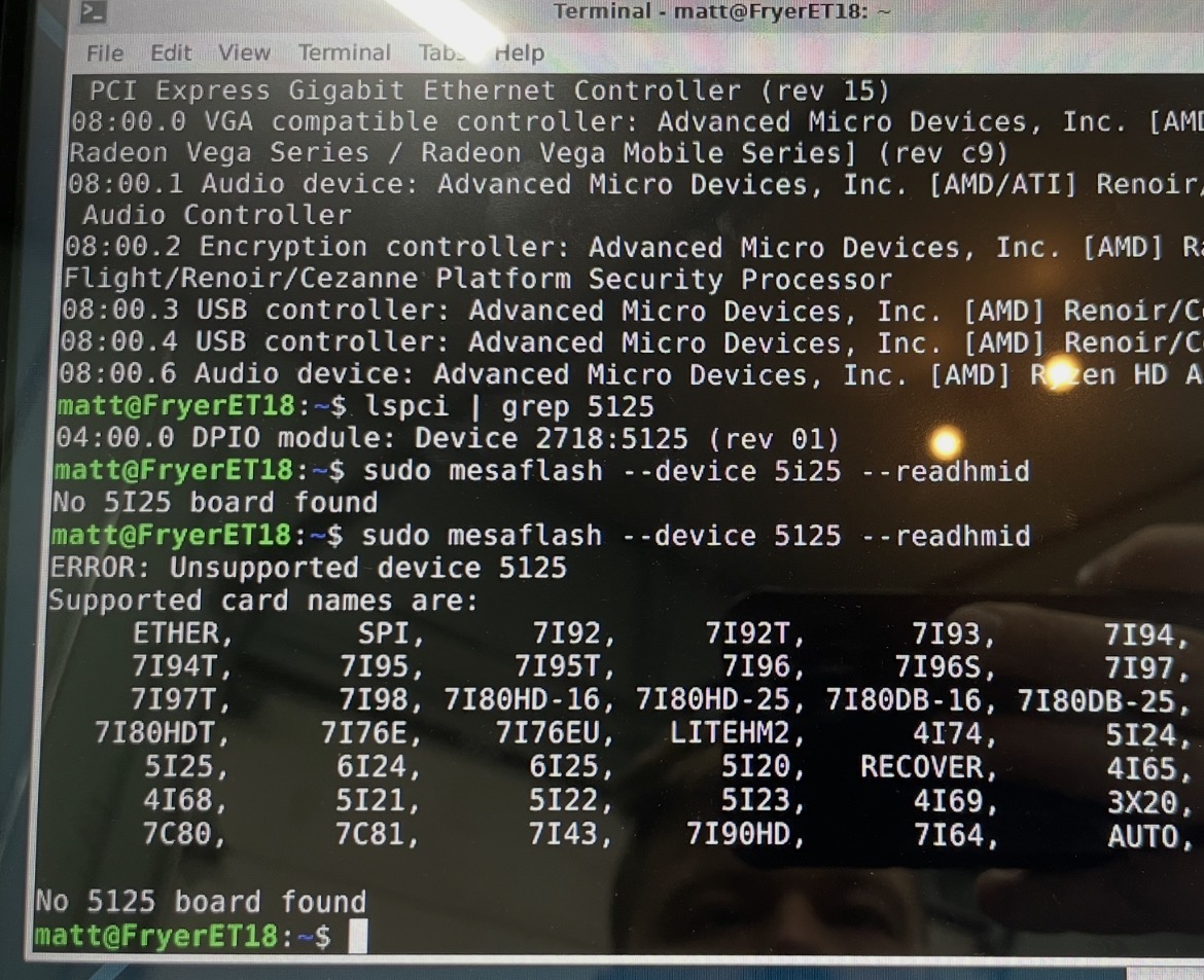

lspci did find the card but mesaflash does not, that may indicate a bad 6I25
There are no LEDs illuminated on a 6I25 in normal use except very briefly at power on.

Disconnect the 7i77 from 6i25, check if MesaFlash finds it.

OK, disconnected the 7i77 from the 6i25. ran mesaflash, linux couldn't find the board.
Am I needing a new 6i25? I ordered this AM on the hunch I probably would...
In other news, if I launch linuxCNC with the 7i77 removed from the 6i25, my PC doesnt hard crash anymore, just gives the following error:
I have the report from that if it means anything.
All of the above was done on a new (different) PCIe slot...so the slot being a problem should be removed as a potential issue
