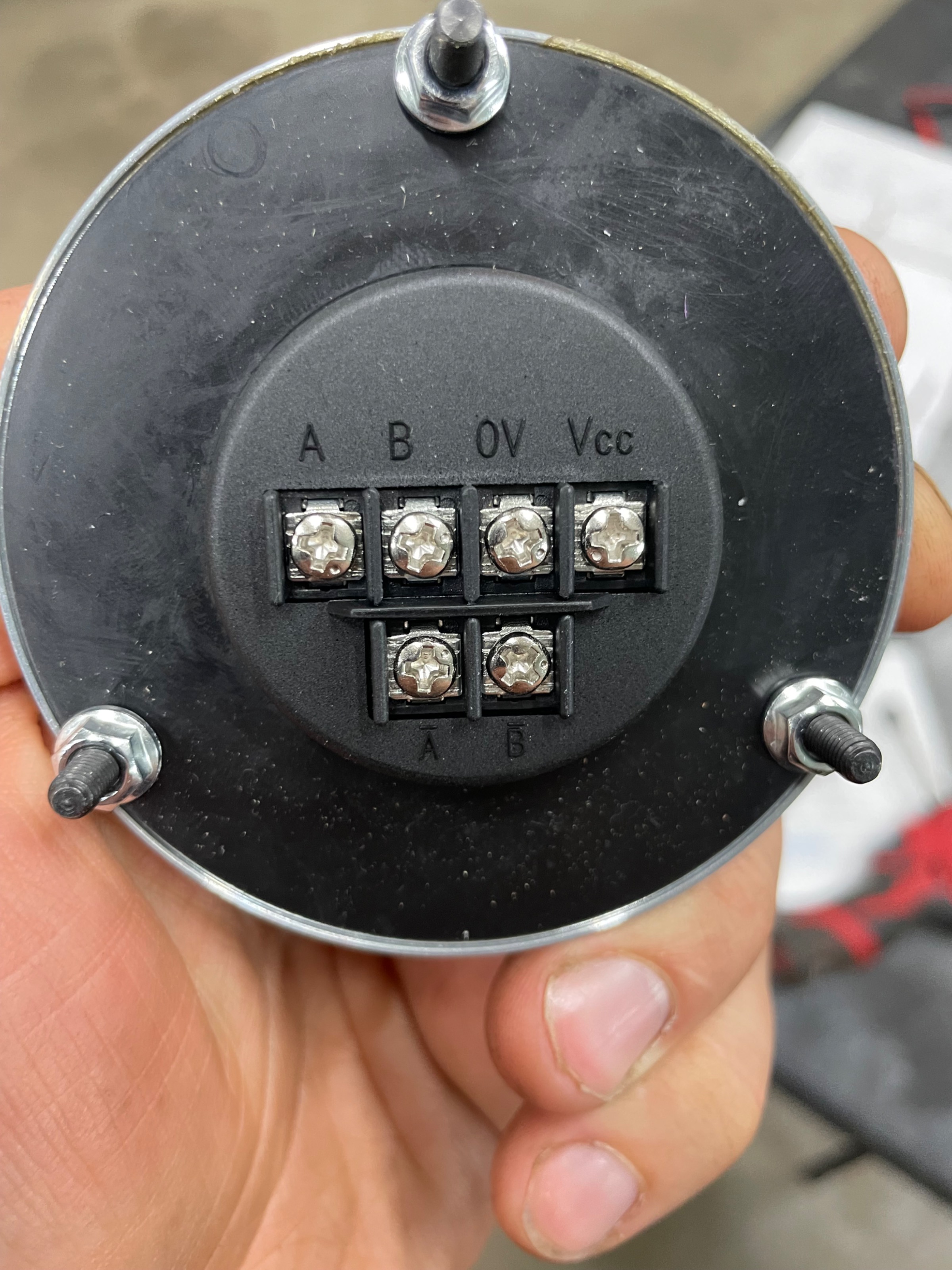

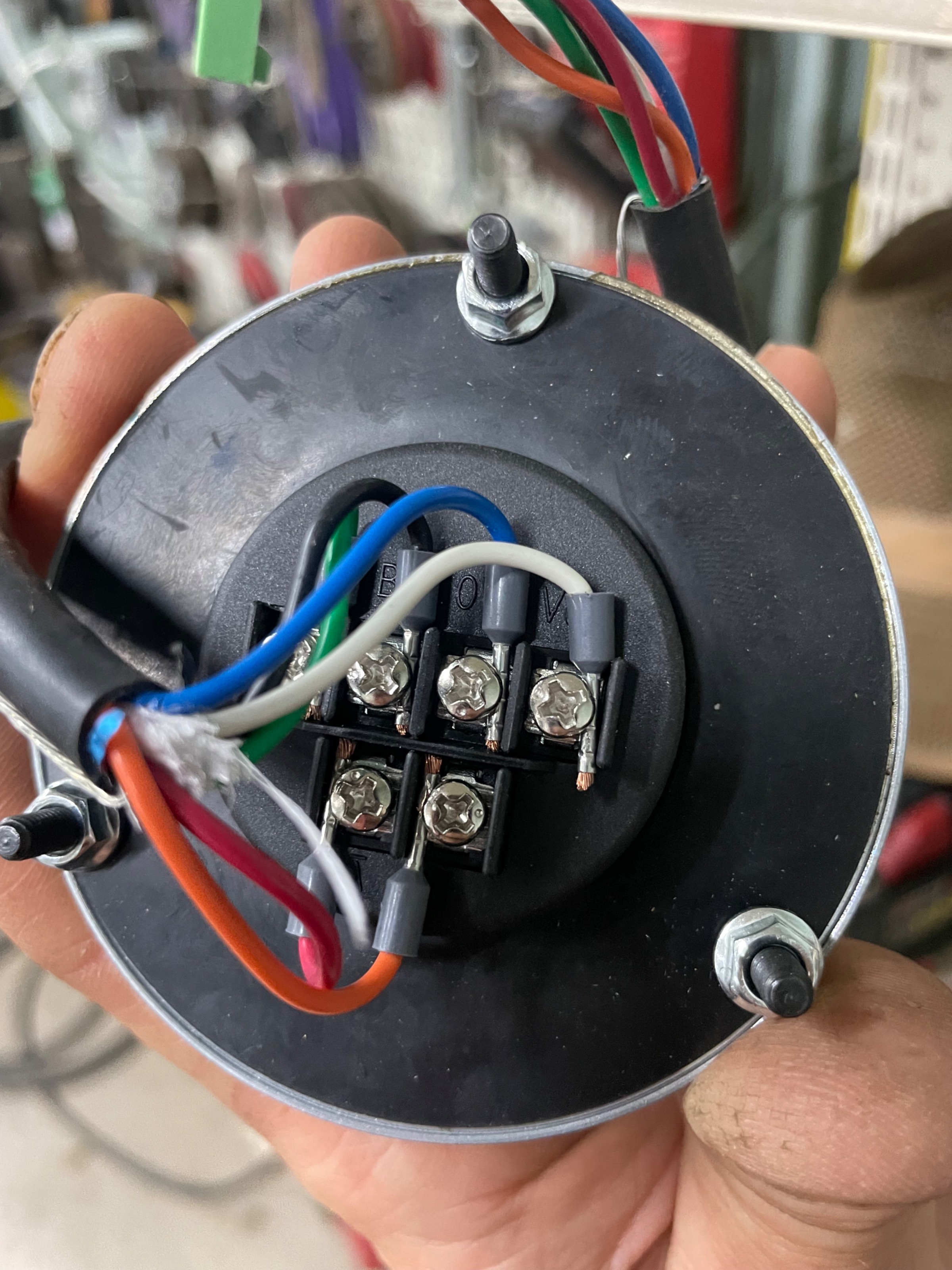

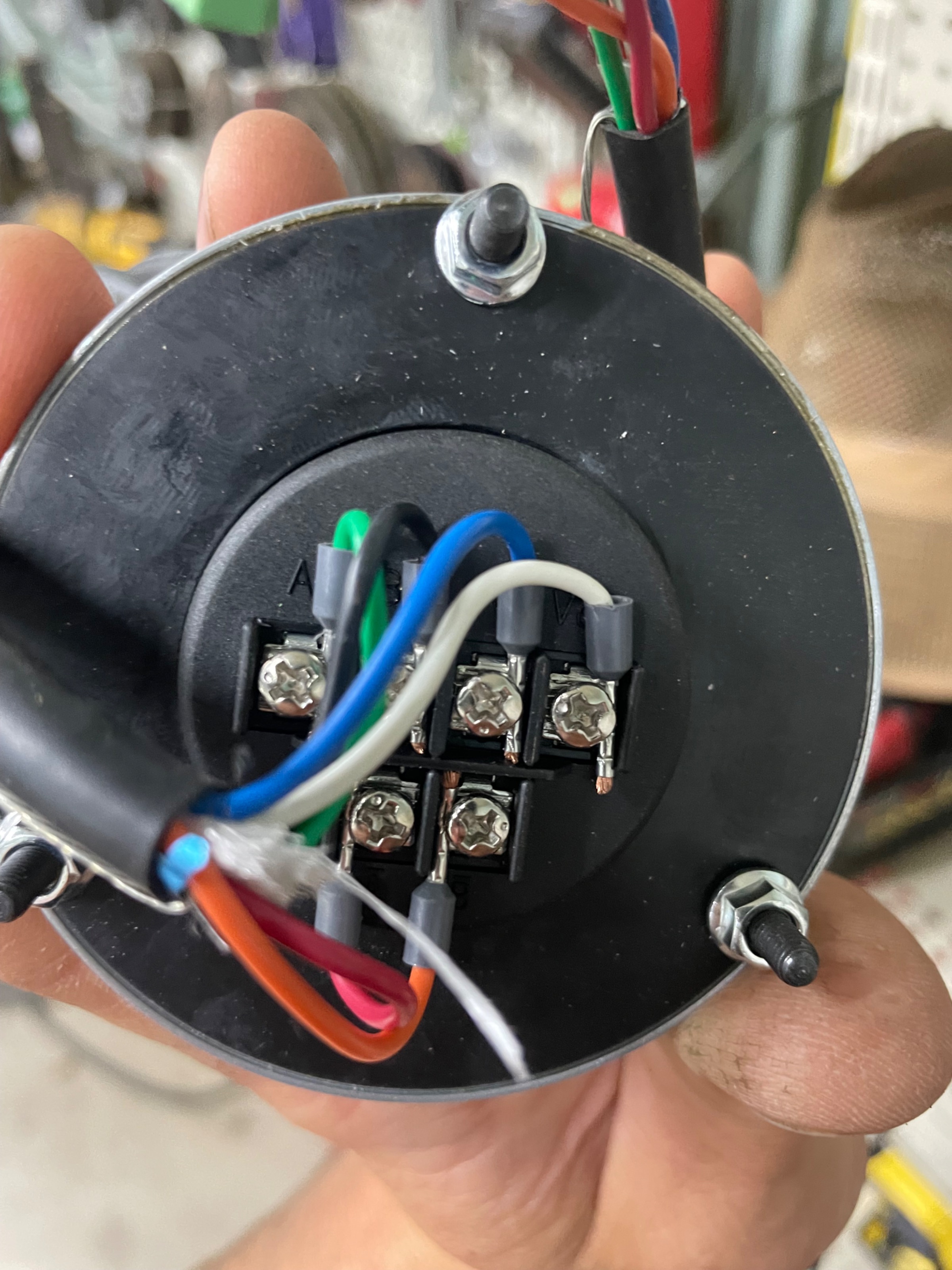

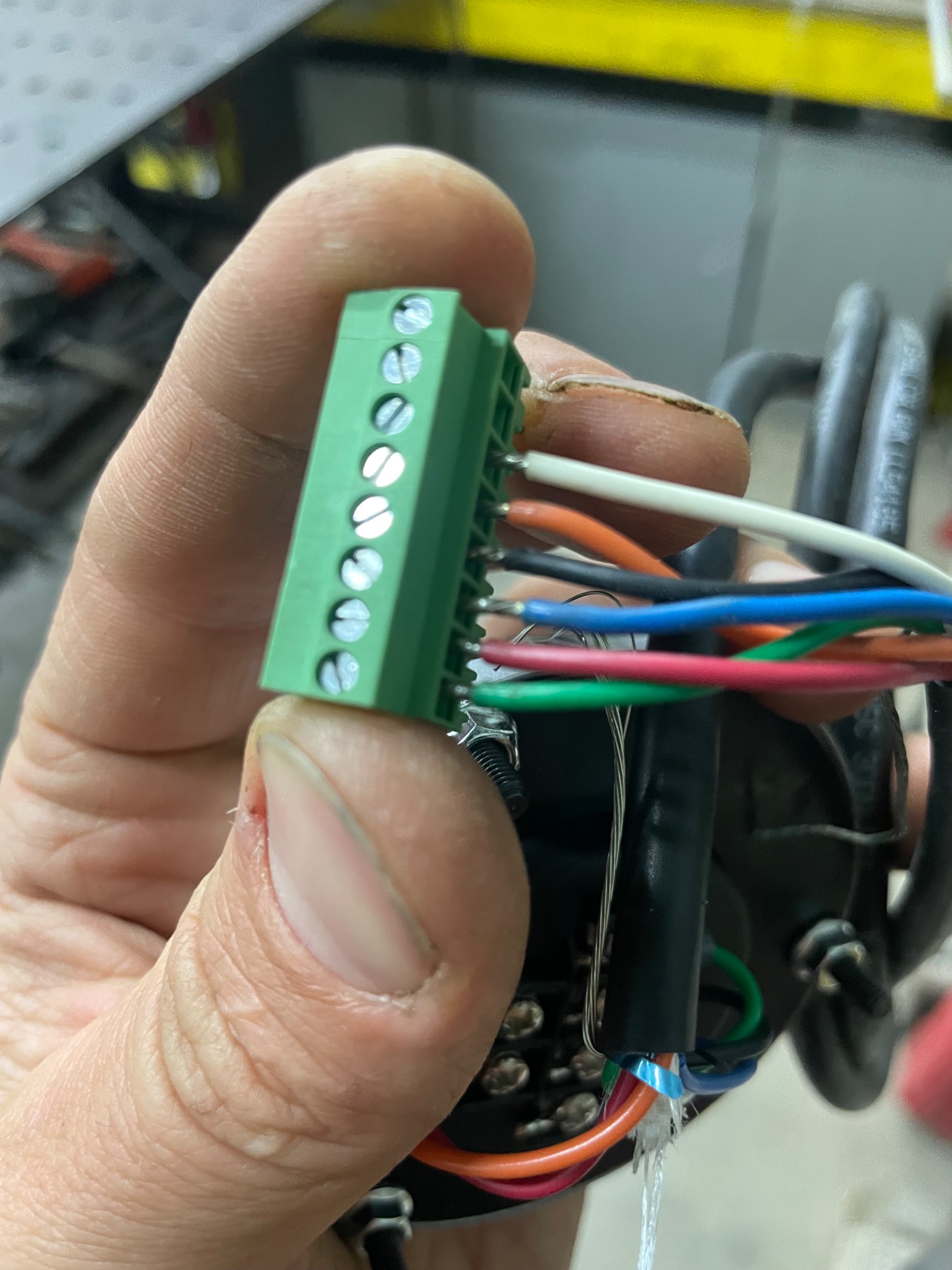

31 May 2026 01:30 - 31 May 2026 01:32 #346790
by grossm5000
Replied by grossm5000 on topic Differential encoder hard crashes the PC MESA7i77
I had a few more minutes to work on it this week - I wired the encoder via a short pigtail to the 7i77, got the same results as before. So the issue cannot be a faulty wiring connection.
I also found that my 5vdc power supply may not have been grounded, so I fixed that, no change, the PC still crashes.
I also tried all the other encoder locations on the 7i77, all producing the same issue.
I will keep updating as I do more.
Last edit: 31 May 2026 01:32 by grossm5000.

Do you have any normal encoder, or a servo motor with encoder attached to it?
If yes, wire it and test, see if the same thing happens.
Do you have the spec for the MPG?
- Posts: 21958
- Thank you received: 7478
31 May 2026 02:34 #346793
Replied by tommylight on topic Differential encoder hard crashes the PC MESA7i77
Another thing to try:
-set the Mesa encoder inputs to "single ended" for that channel (see manual)
-Wire only +5V and GND-
-wire only A+ and B+ from MPG to Mesa A+ and B+
-test
-wire only A- and B- to Mesa A- and B-
-test
-test
-test

- Posts: 21958
31 May 2026 14:10 #346802
I suspect the MPG has a defective output and causing a short to 5V supply, that in turn causes the 7i77 to error out. Or it draws to much current maybe?
- Posts: 18093
- Thank you received: 5325
31 May 2026 15:56 #346806
Replied by PCW on topic Differential encoder hard crashes the PC MESA7i77
This is why I suggested using an external 5V supply
(shorting an external supply would not affect the PC)
