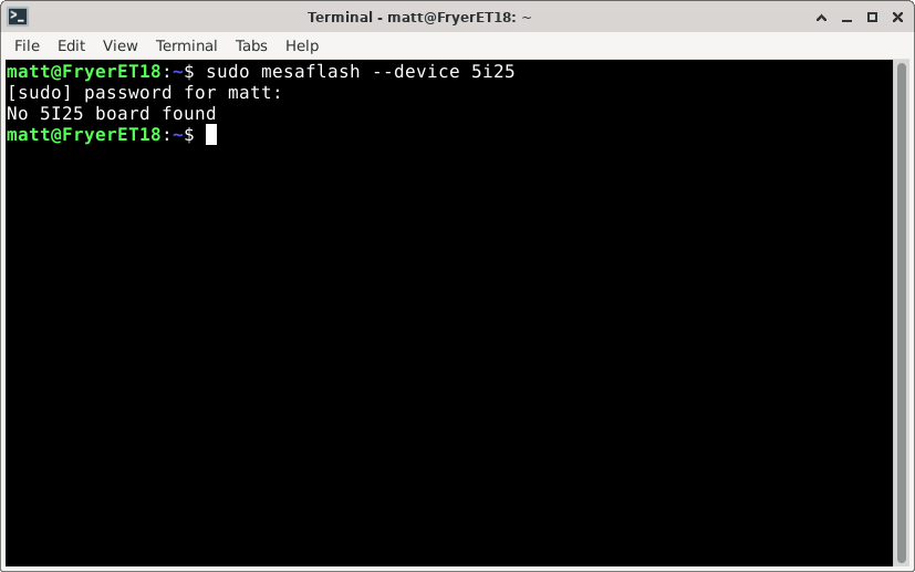

- grossm5000
- Posts: 38
19 Mar 2026 16:55 #344528
by grossm5000
Replied by grossm5000 on topic Differential encoder hard crashes the PC MESA7i77
OK, disconnected the 7i77 from the 6i25. ran mesaflash, linux couldn't find the board.
Am I needing a new 6i25? I ordered this AM on the hunch I probably would...

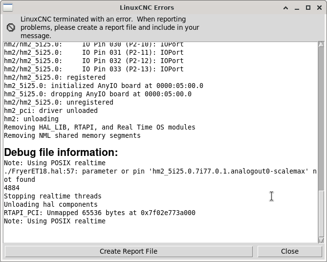

In other news, if I launch linuxCNC with the 7i77 removed from the 6i25, my PC doesnt hard crash anymore, just gives the following error:
I have the report from that if it means anything.
All of the above was done on a new (different) PCIe slot...so the slot being a problem should be removed as a potential issue
