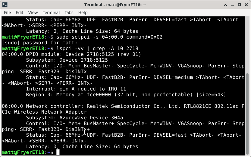

I do have access to some BIOS PCI settings, but not sure if I can screenshot them. I am afraid the best I can do is take a picture.
I did some searching...will this command do anything for me?
sudo setpci -s 04:00.0 COMMAND=0x02
supposedly enables the memory space, but I am certainly not a software wizard...

You could try setpci and verify if the [disabled] goes away from the lspci listing

ok, I used the setpci command, seems to have worked, I no longer get a disabled on the lspci command:

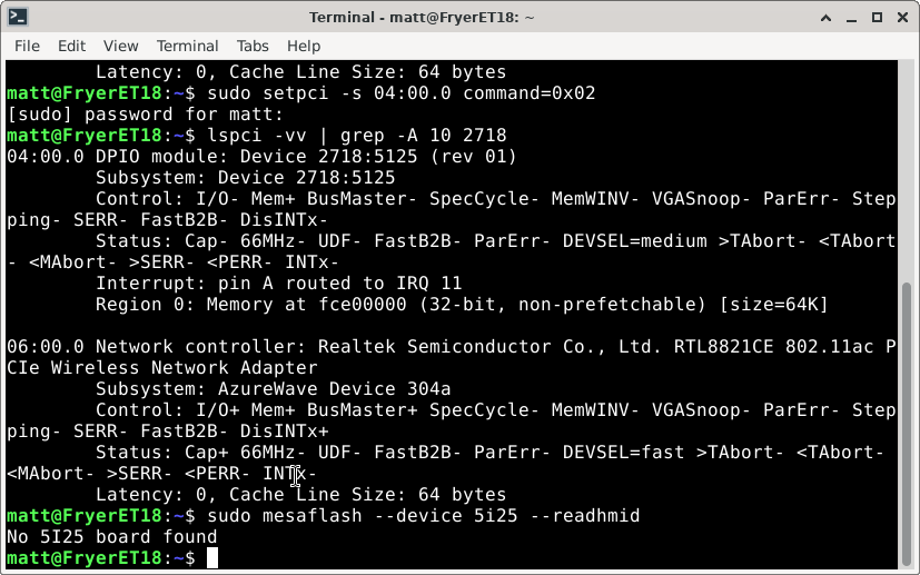

however, the very next thing I do is try to run mesaflash, and again it cannot find the card:
I have adjusted all the PCI setting I could find in BIOS, no luck there either. The motherboard does not have PCIe jumpers, checked that as well. Everything was set to GEN1 just the same

- Posts: 18093
- Thank you received: 5325
28 Mar 2026 15:13 #344878
Replied by PCW on topic Differential encoder hard crashes the PC MESA7i77
I wonder if somehow the motherboard was damaged in some way at the first fault.
Because this is quite odd behaviour.
I wonder if you would get the same hard crash fault if the new 6I25 had the correct firmware?

moved to a different PCI slot, no change in behavior
moved to enable breakout power (W1, W2 up) no change in behavior
tried lspci -vv, didnt find the board. Sucessfully enabled board with setpci, then lspci confirmed board was not disabled.
...tried mesaflash, and mesaflash still returns no 5i25 board found.
did not mess with W3 on the 6i25
EDIT: i have completely removed the encoders from the 7i77 and later removed the 7i77 from the 6i25 in an effort to at least see if the 6i25 could be found.
I would also like to point out that if I connect the 7i77 i am in fact getting 5v from the 6i25 (if enabled breakout power) ...i probed with a multimeter (on the 7i77) the encoder TB and also probed on TB1. So I would say the 5v power seems to be there...
I am beginning to think i have a problem. I do have an ethernet port. should i consider a 7i97? Or i might be money ahead trying a whole new PC at this point.
