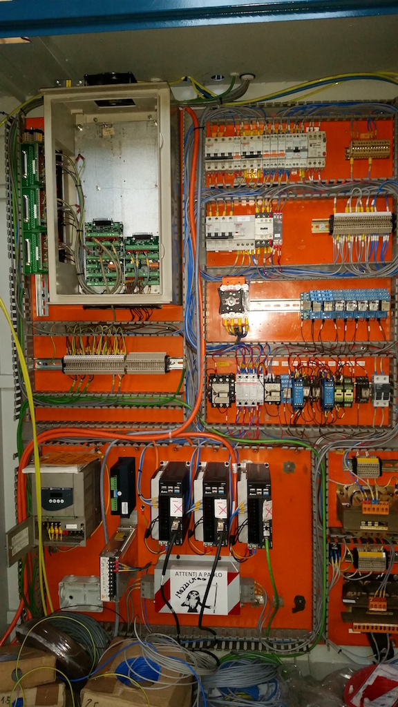

11 Jun 2016 18:10 #75829 by backtime
Replied by backtime on topic Retrofit Gloria Europa 2/40 machining centre
Ah I see, the same as our machine, you did a great job, congratulations, I hope to operate our in the coming days and start doing some work.
Thanks for the info, the machine is in our workshop for many years and has always worked well. We decided to retrofit because the CC100 had failed and taking advantage of an offer I replaced drives, eliminated the high voltage power supplies and simplified scheme.
In the workshop we have the complete electrical and mechanical schemes, but by now the electrical system has been completely redone.
This is the cabinet today.
