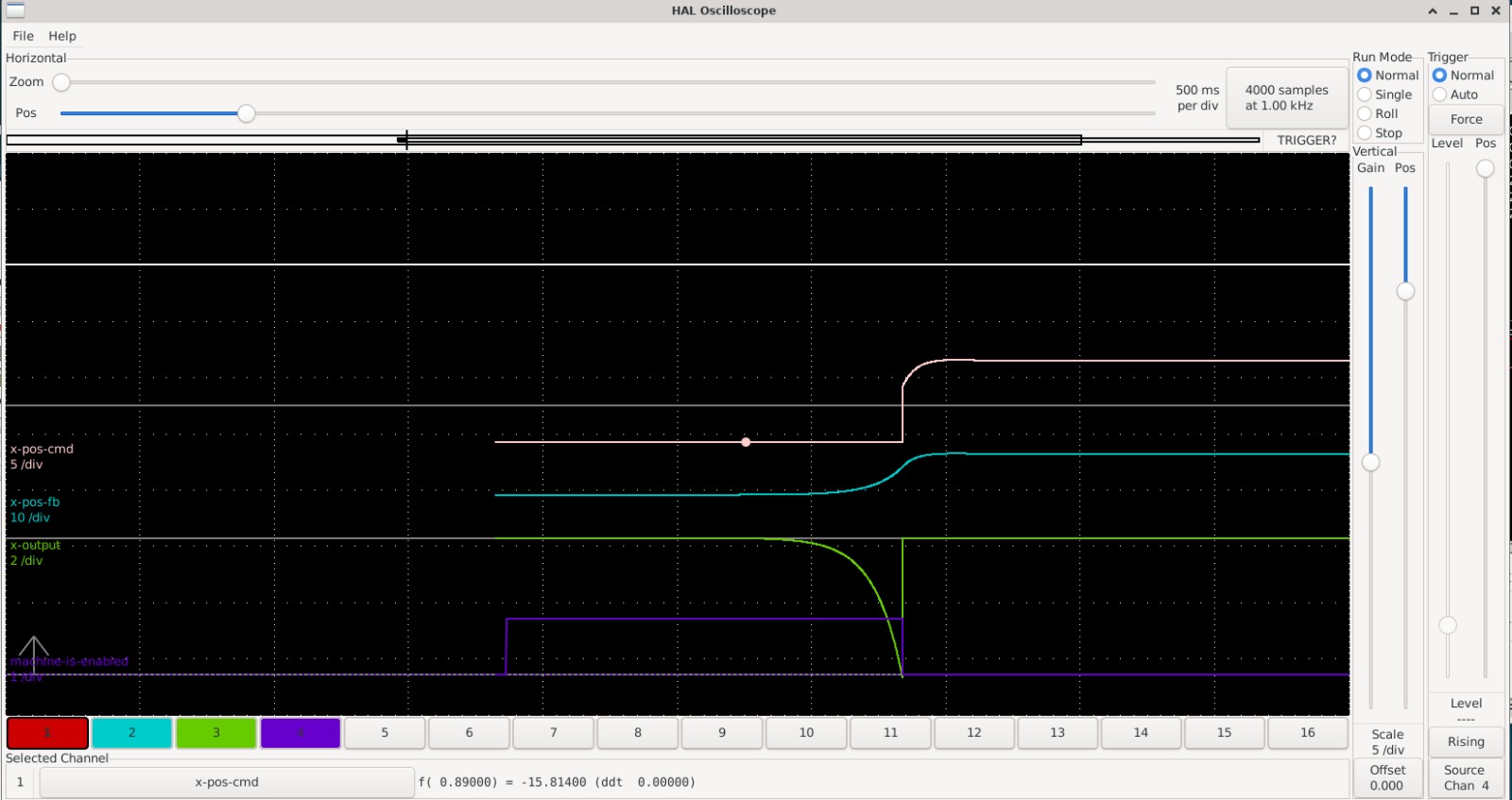

we worked with the hal scope today.

OK that looks like exponential runaway which is an indication that the
feedback loop is backwards (positive rather than the desired negative feedback)
If the encoder feedback is in the correct direction, the fix is to change the sign
of the PWM scale value:

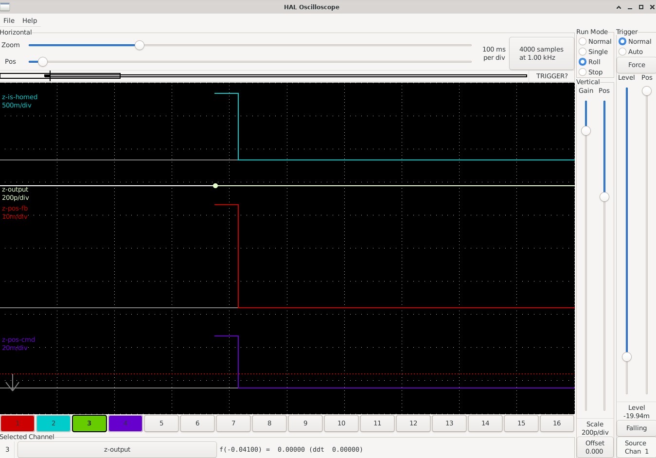

15 Feb 2026 19:44 - 15 Feb 2026 19:47 #343017
by 5_Zylinder
Replied by 5_Zylinder on topic Hurco BMC 30 AP

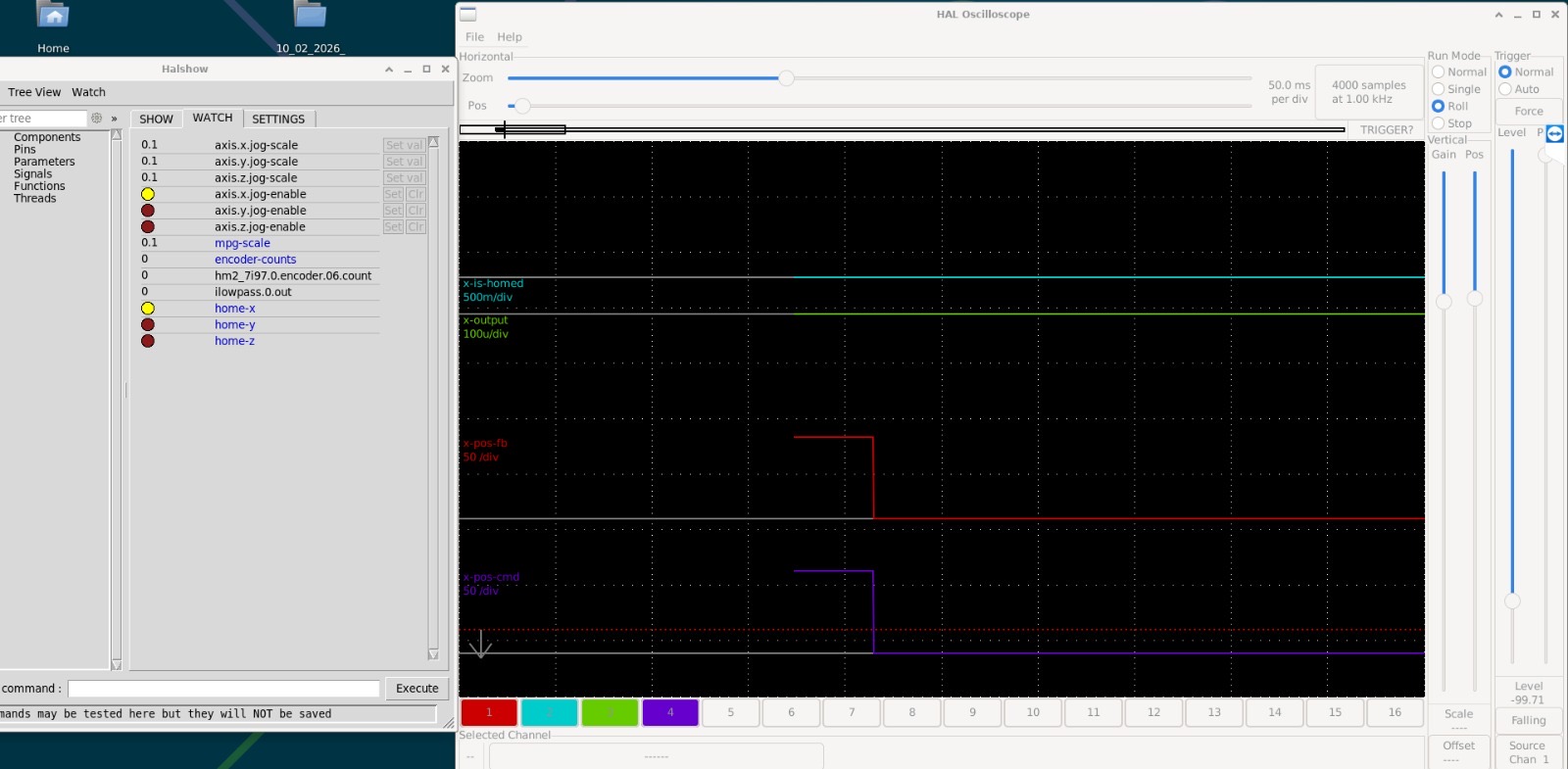

Hello everyone,
Today I recorded data from the Z-axis, which is functioning correctly, and then I tested the X-axis.
The X-axis limit switch moves onto the cam and then simply stops instead of moving freely.
After a few seconds, the following error message appears: joint 0 following error
Last edit: 15 Feb 2026 19:47 by 5_Zylinder.

Replied by PCW on topic Hurco BMC 30 AP
Unfortunately neither plot shows any motion so it hard to tell what's going on.
Can you post your current hal/ini files?
