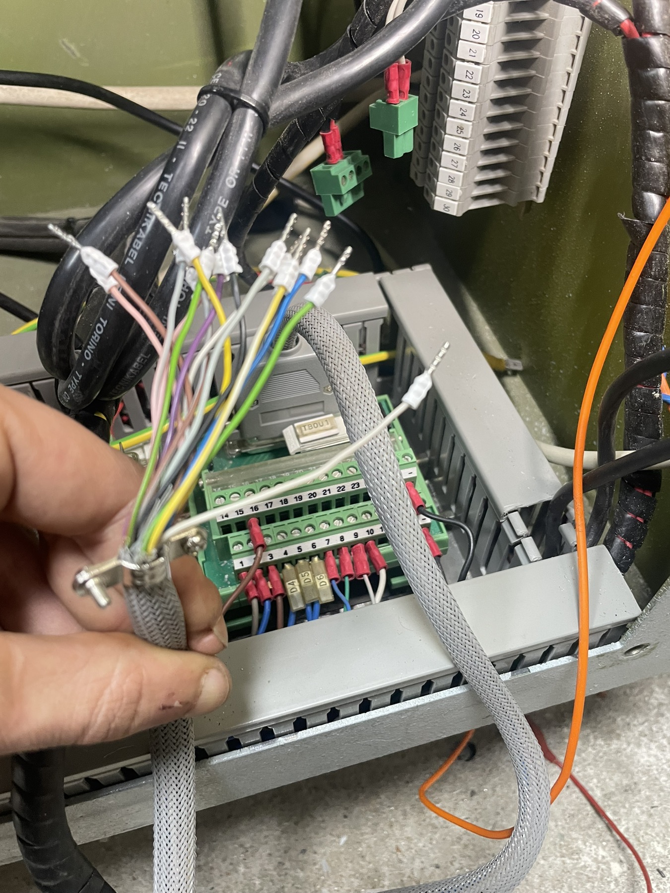

10 Nov 2025 04:22 #338138
by Masiwood123
Thanks, I'm on the way to a solution for the drivers, what's left of the cables is clear to me, and the rest are: analog +-10v signals, one 25pin input cable, which are partly connected as soon as the machine is turned on, and partly I realized which ones are for homing and for inductive sensors from the tool. and this 25 pin output cable remains, there are a total of about 10 outputs, my plan is to activate them all manually, together, by hand out of 7i77card, to see what will happen on the other side of the machine where this TB3 (see schematic) terminal block is. the cable from the pendant remained, that is, the one from external buttons to the controller, I mean jog, feed override, spindle override, axis select, step select, estop. I will have to find a way to activate the K1 switch, it turns on the drivers, but also to connect the estop to turn it off. My question is, do I need analog inputs for the pendant later, or could a configuration be made using buttons and potentiometers that would support mpg, potentiometers and buttons with digital inputs?
Replied by Masiwood123 on topic beta bulleri for retrofit?

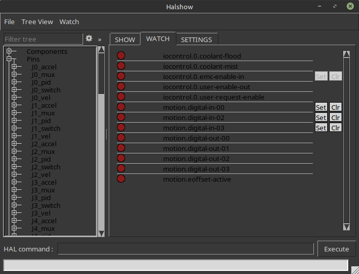

For outputs, 2.10 (or Master) has a nice feature where you can toggle inputs and outputs from the "show hal configuration" menu, so add the Mesa outputs by assigning some random names to pins, then use the above to toggle on and off outputs by clicking on SET or clear, as shown bellow:

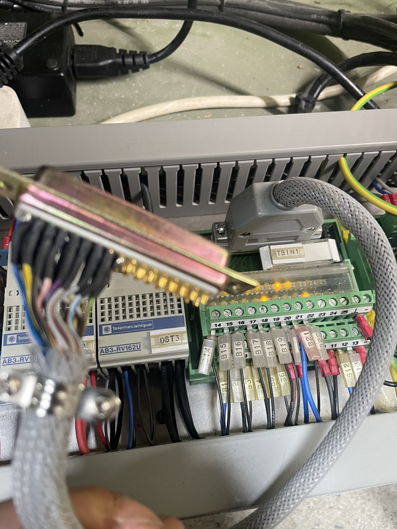

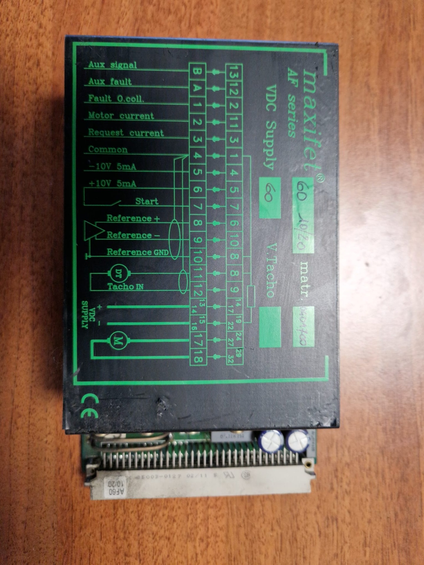

thank you very much for the answer, it will certainly help me later, now i have come to the conclusion that I could destroy the drivers by bringing 24v for enabling, it did not occur to me that the old controller gives 10v on that output, otherwise they are all 24vdc. and now here in the picture you can see these white wires, they are connected to enable on pin 7, however, the pin 6 from the driver just gives 10v and then I managed to short-circuit to pin 7 and the drivers are enabled, however, I still need to understand the estop chain so that the switch that supplies power to the drivers would stick, when I turn it on manually, the axes slide slightly to one side, maybe mm/min, I assume that the offset on the trimmer is not well adjusted, But, when all that I did it via the Mesa 7i77 card, i installed enable and brought the wires for the analog signal of the axis, when i start linuxcnc machine F2 axis move a little and stop(joint following error) (I will have to try to tune the motors first or maybe I should try to turn the analog wires ref and ref-?

The wire you connected 24V is the machine enable, so it goes to Mesa 7i77 output, while the other wire should go to input as machine is ready. Does the other pin come from the ON/START/GREEN button?
