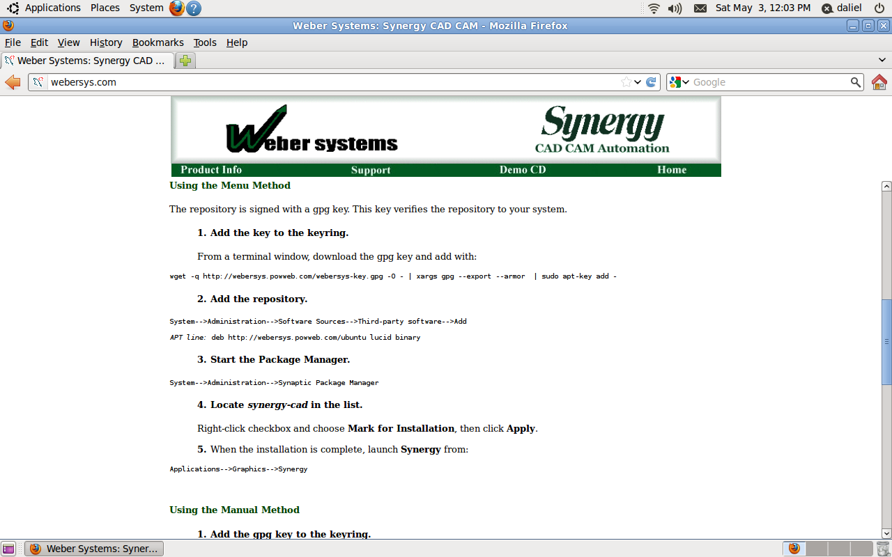

03 May 2014 00:29 #46540 by allenwg2005
Replied by allenwg2005 on topic Password problem
I'm trying to install Weber Systems “Synergy CAD/CAM” program.
Wewbersys.com
Maybe this will help, I tried one of the options on the web site (“The menu method”) and took a screen shot of it the results from the terminal to post here.
03 May 2014 13:17 #46549 by ArcEye
Replied by ArcEye on topic Password problem
The script is trying to download a gpg key for a repo and pipe it direct to apt.
It should work, but something similar with my repo would not work properly, so I split it up.
Do the wget -q webersys.poweb.com -O /tmp/webersys-key.gpg
first
Then sudo apt-key add /tmp/webersys-key.gpg
Then you need to add the repo to your sources.list, but presumably that is next in the script
regards
The following user(s) said Thank You: allenwg2005

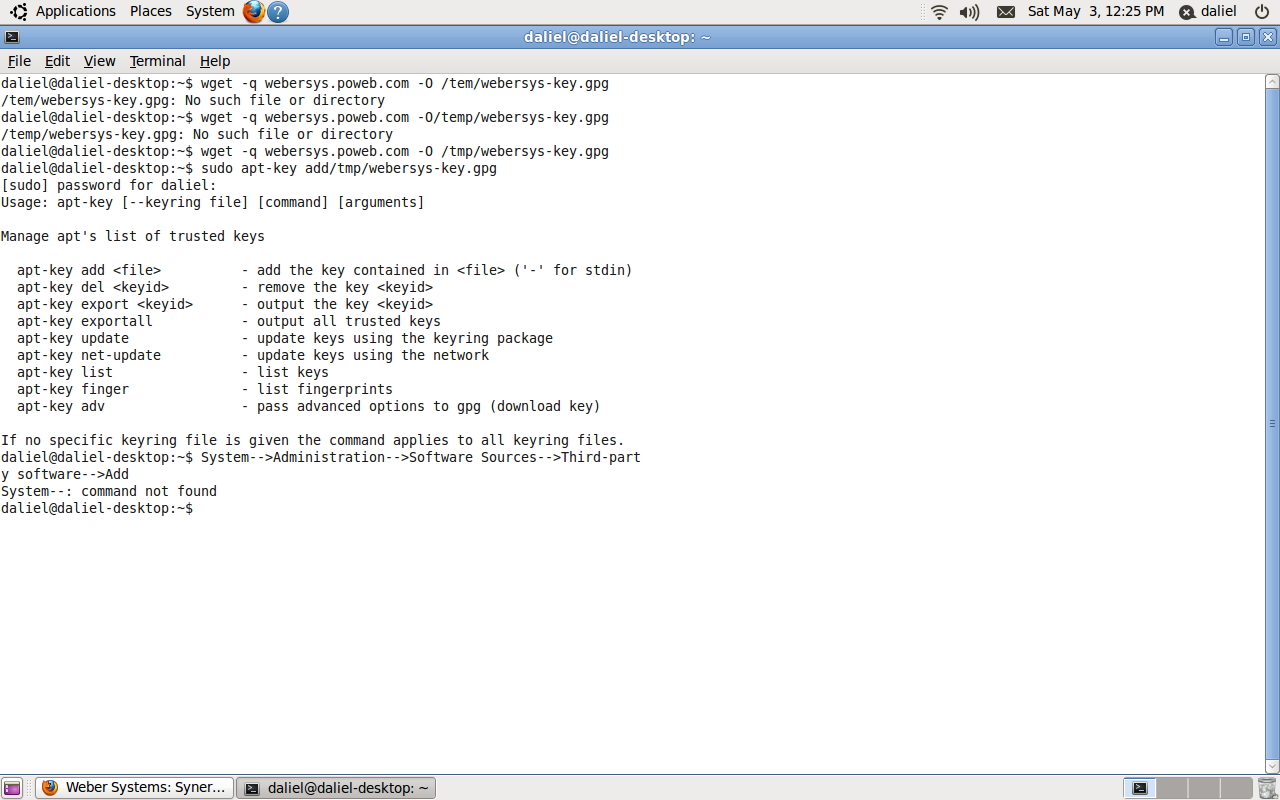

04 May 2014 02:37 #46558 by allenwg2005
I'm making some progress, as soon as I went to add the repo I hit another wall.
I add another screenshot to illustrate.
I am adding a screen shot of the dialogue from the Weber web site.
If I need to modify any of the script going forward I thought having all of it here now might save time.
THX
