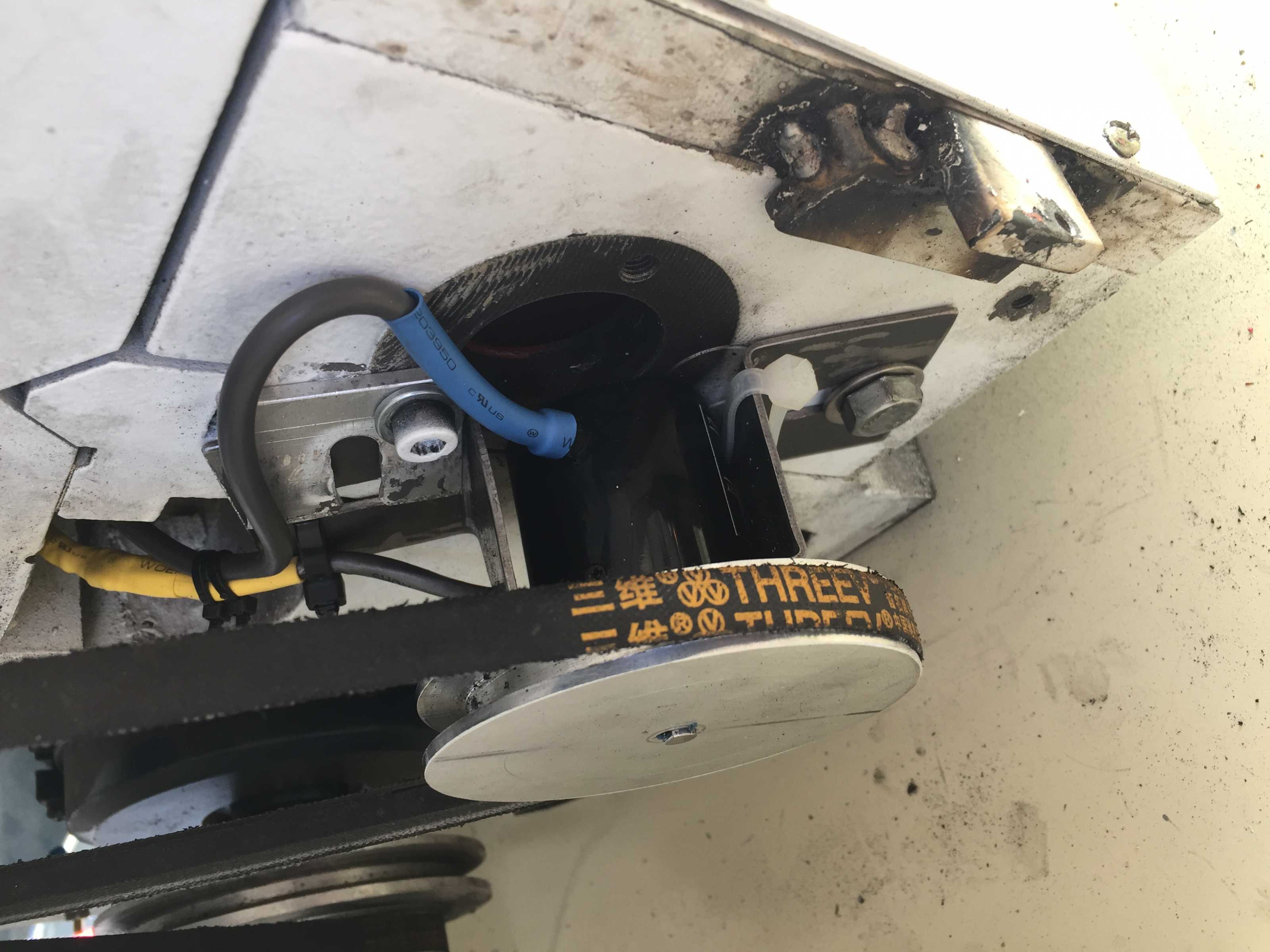

I hope the gurus can help.
I am having trouble getting the lathe to thread anything that looks decent.
Basic machine - grizzly 0602, Mesa 5i25->C35 BOB. Encoder is 1024 PPR w/ A,B,Z
Running Tormachs PathPilot version of Linuxcnc
When I run the G76 threading it works, but the threads look awful, like it's starting a little bit off with each pass.
I attached the hal and ini files - which are largely unchanged from their original for their lathe. I only really changed the encoder scale to 4096 to reflect my quadrature encoder.
Here is how the encoder is attached to the spindle - w/ a 1:1 pulley (maybe off by about 3% however)
Here is a video of the crappy threading:
Here is a video of the same code but turning the spindle by hand to show synchronized motion w/ Z-axis
Heres the snippet of the encoder part of .hal file:

First thing that comes to mind is the encoder index not being consistent. This could be mechanical slip.
If you rotate the spindle one rev does the encoder count aprox 4096?
how about if you rotate several times? Does the index stay in the same place?
The next is electrical interference of the pulses.
Are you using differential wiring? a- a+ b- b+ i- i+
Chris M
What happens if you slow the spindle down?
It's hard to see in your video if the index position is changing.
Chris M

Chris thanks for the tips.
I don't think it's mechanical slip as the encoder is all in one not a diy optical disc.
My feeling is that something is funky with the index pulse.
When I put the oscilloscope on the A and B leads I get pretty nice looking square waves, the index pulse is a square wave too, but for some reason a little more rare on the scope.
I will try to rotate the spindle by hand and check the encoder counts tomorrow.
I did slow the spindle down to 400 rpm, and still get crummy looking threads.
The wiring from the encoder is 5 leads - a shield and common - which I tied together. A +V power, and then the A,B,Z single wires. I don't have separate A+ and A- , B+/B-, etc., leads.
It runs in shielded cable to an aviation connector on the NEMA box I have everything in.

As Chris said it looks like your set up might be subject to slippage with what looks like a v belt instead of a timing belt.

try setting counter mode to 1 as here
setp hm2_5i25.0.encoder.00.counter-mode 1
also can you show a better picture of the result , a static pic will be better than a vid , so we can see clearly
also you would be better as has been mentioned on using a timing belt and pullys
can you also send me or post your gcode you used
this is so i can mimic your setup ,
i'm currently working on pathpilot so i'll take a closer look and if needed i'll modify it
i have a feeling this is also a little to do with sync ,
so how are you connecting your encoder mechanicaly to the spindle ?
and which encoder is it your using ?

this looks more as if the vfd is possibly over running and slipping on it's reverse ,
this is where toothed pullys and belts come in .

Rick and Chris - I am fairly certain the belt isn't slipping, it's pretty tight and there is almost no resistance on the encoder.
CNCBasher - I think you are on to something with the scale.
I did a test, turning the spindle by hand over 10 revolutions I get the scale at 4134 PPR rather than the 4096 - this obviously is the small mismatch between my encoder pulley and the spindle pulley.
Any ideas how to alter the hal file. I tried just changing the encoder scale to 4134 but that didn't seem to make a difference as I think the index pulse would need to be scaled too?
Basically the math seems that 1 revolution of the spindle = (4134/4096) = 1.00928 revolutions of the encoder.

Chances are the pulleys on the encoder and spindle are not identical.

Exactly - I can adjust the scale to account for it but how do i adjust for the index being off a bit in Hal?

Adjusting the scale will NOT work. You MUST have a positive 1:1 ratio spindle to encoder.
At least the index pulse must be 1:1.
Please save youself a lot of trouble and get a timing belt or gears.
